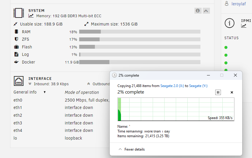

I'm trying to move a share from my TrueNAS server to my UnRaid server, and for some reason, it starts off as normal, around 200MB/s. But very quickly, it drops down to about 15MB/s and slowly but surely goes slower even still. It's now hovering at 3-5MB/s. I'm talking about 3.5TB of data, and I don't want to wait a few days for it to finish.
My UnRaid server is an R720 and the array is a two-drive non-raid ZFS array. When I started the first attempt, I quickly stopped it, because I realized I still had a cache drive enabled, which is smaller than the data I wanted to copy, so I quickly disabled that, and started over. Shouldn't have anything to do with it, but I just figured I'd mention it.
I know that my UnRaid server is the problem, not the TrueNAS machine, because all the UnRaid shares I've set up are very slow to respond. It literally takes 15 seconds for Windows File Explorer to load the blue bars that show capacity utilization.

The ZFS ram is set to 163GB, of the 192GB available, that leaves for 29GB for UnRaid, and the very few dockers I run.
Anyways, I did a reboot, and started the transfer again, and it would drop down very quickly to 15MB/s. I could see the ZFS cache filling up again, since it was empty before because of the reboot. But the speed started dropping when ZFS memory was at like 9%.

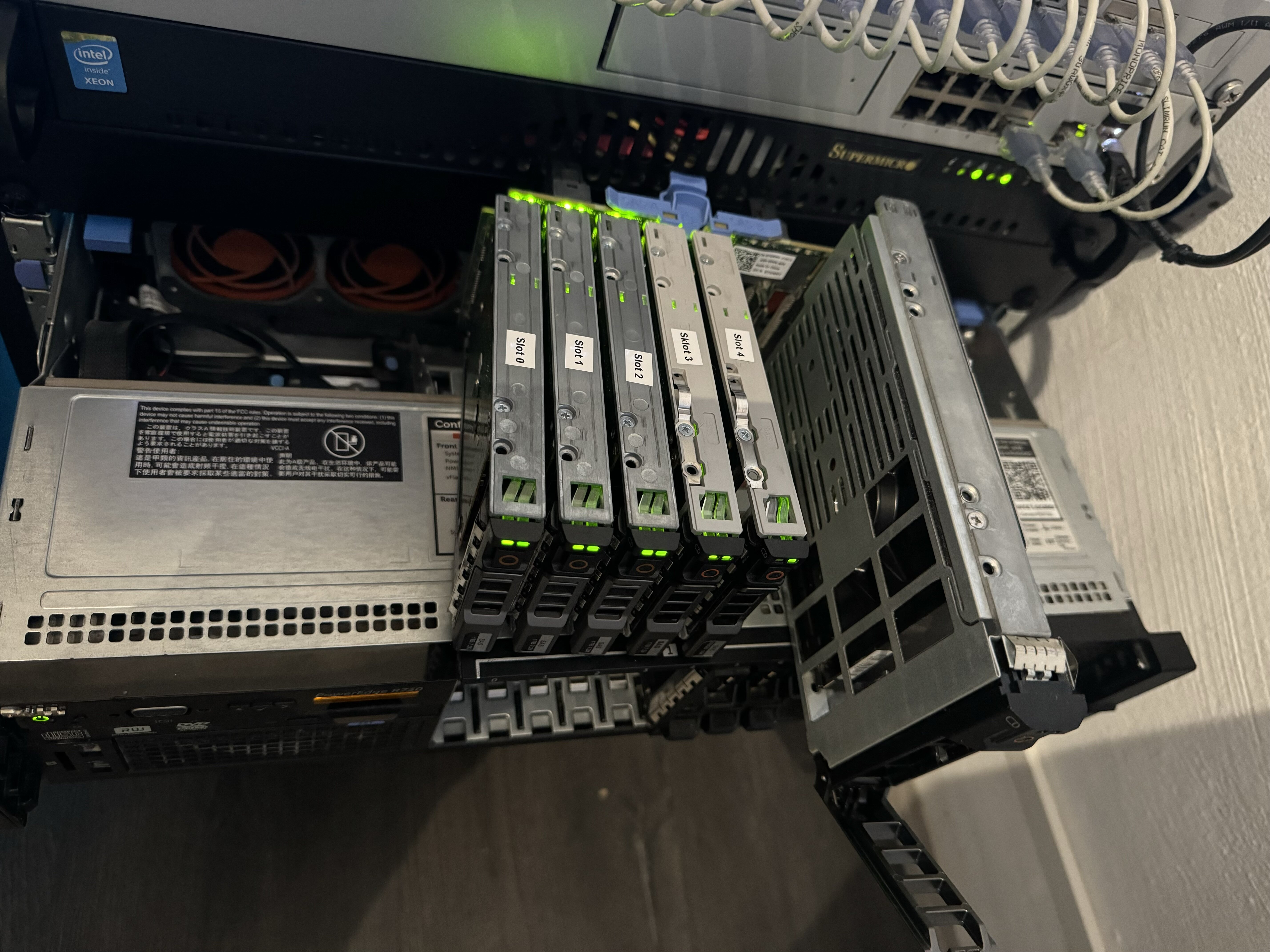

I’m sorry to have wasted your time, but apparently the drive itself is the issue. I made this wonky setup to attach this 3.5” drive to the SFF backplane of the TrueNAS server, and setup a new pool in there. And I get low write speeds as well.
is that something that can happen to a drive, messed up write speeds but being able to read normally?
Edited by LeroyLaFontaine
