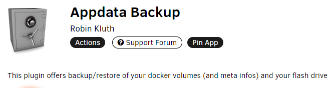

You can run the plugin appdata backup and restore on a different device by copying the backup...

the appdata backup may be a better solution here to copy 1 new folder. -- use unassigned devices and get a portable USB disk drive for temp storage...
