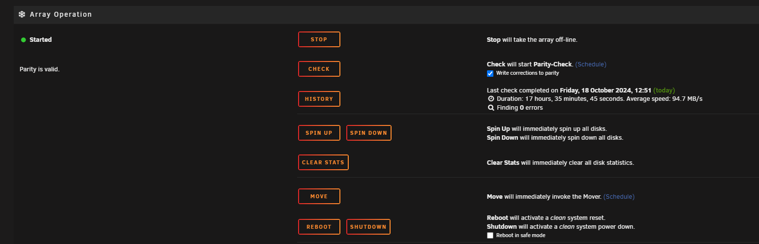

I have done a "New Config" so it's currently doing Parity at the moment at a whopping 67MBp/s which it usually does at around 100MBp/s (this has been running for almost 13 hours and has done 53.3%)

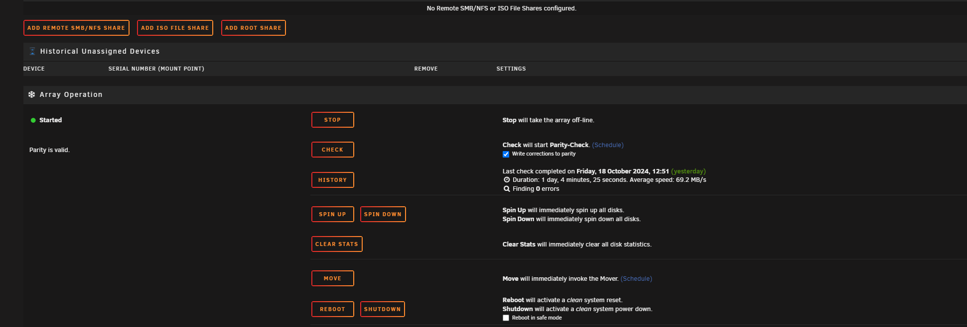

So the Parity check has finished and has made no difference unfortunately.

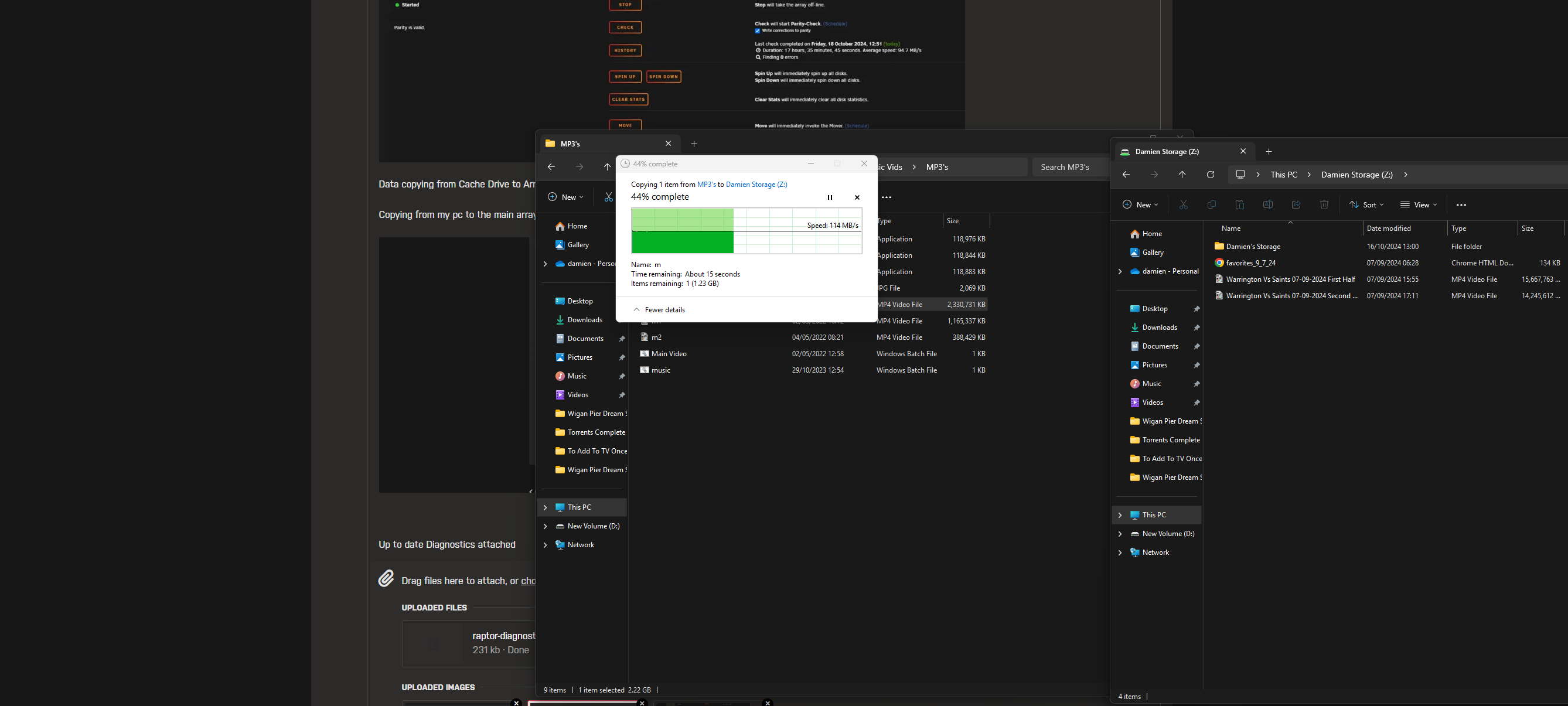

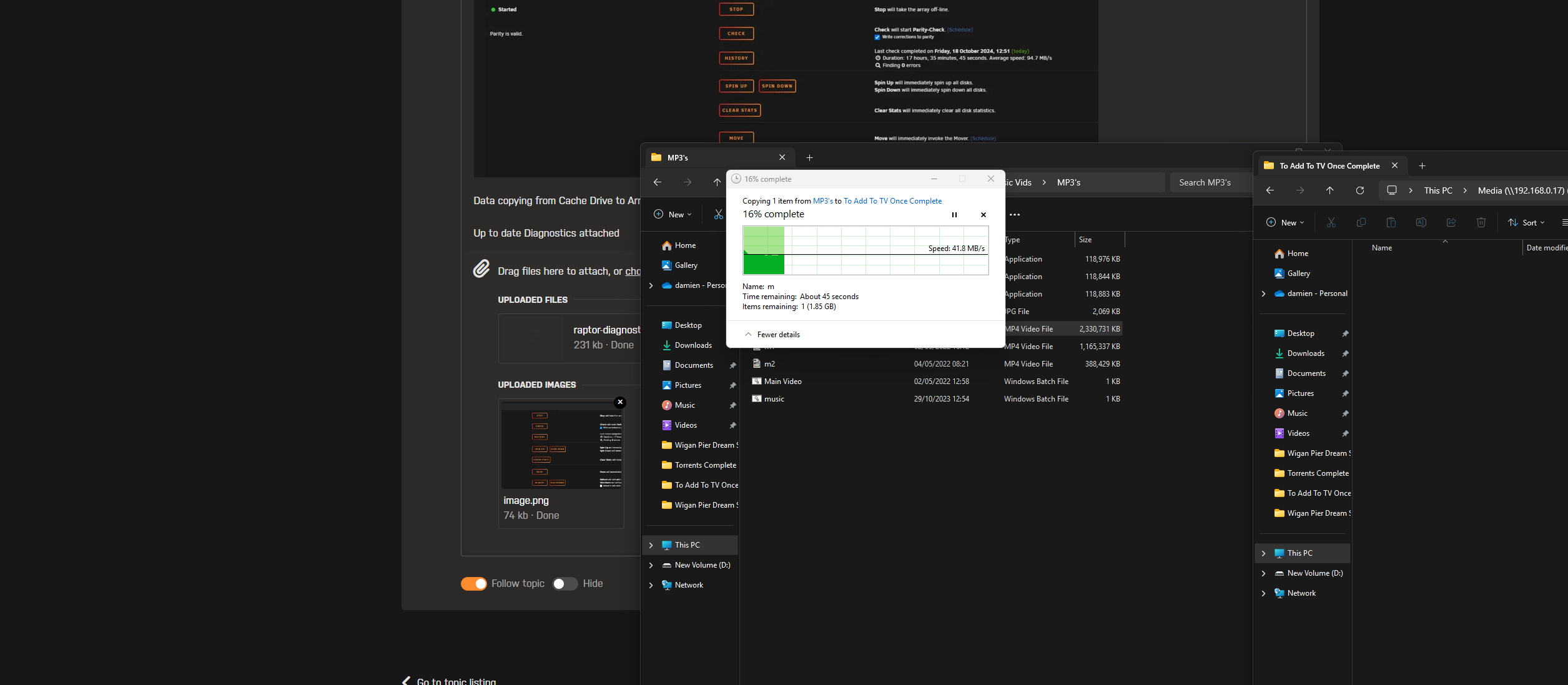

Data copying from Cache Drive to Array is still topping out at 45MBp/s, copying from 1 NVME to another NVME is topping out at 98MBp/s within the server.
Copying from my pc to the main array on the same network is still limited.
Copying to an NVME from my pc maxes out the network
The NVME that is called "Damiens Storage" is on the PCI-E 4x NVME Slot Card, just like the Cache NVME Drive is and that also maxes out the network when copying from my pc directly to that drive.
So basically my gaming pc to the NVME's, maxes out the network, my pc to the array limited to 45MBp/s, NVME to NVME in internally within the server 98MBp/s limit, NVME in the server to the main array 45MBp/s limit.

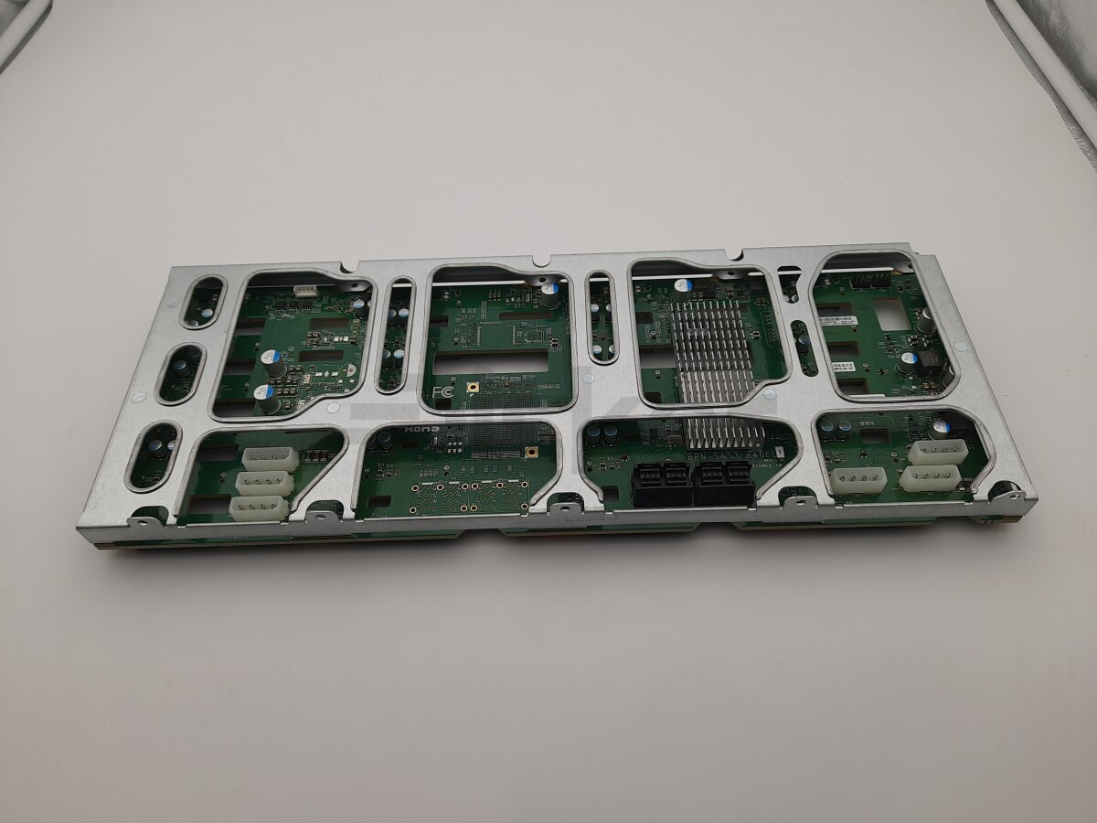

The Chassis is a Supermicro CSE-846BE1C-R920B and the backplane is the Supermicro BPN-SAS3-846EL1 if that helps.

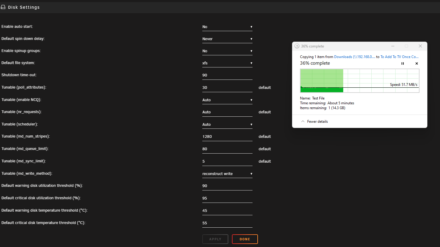

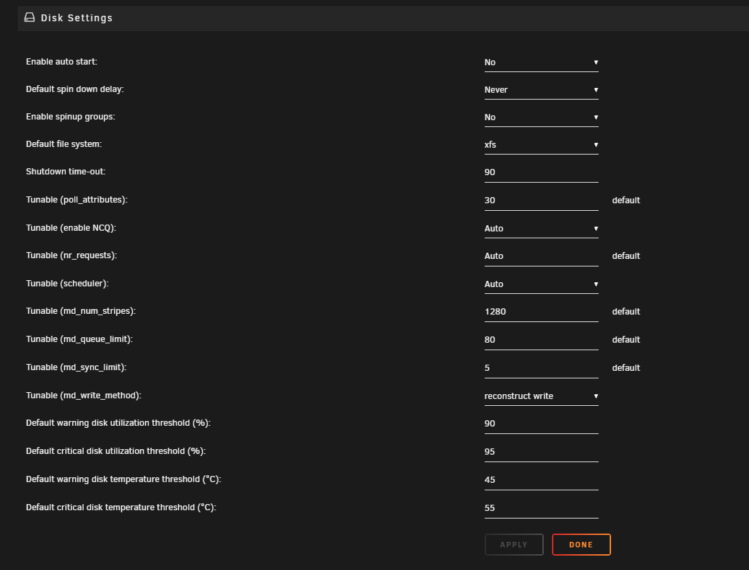

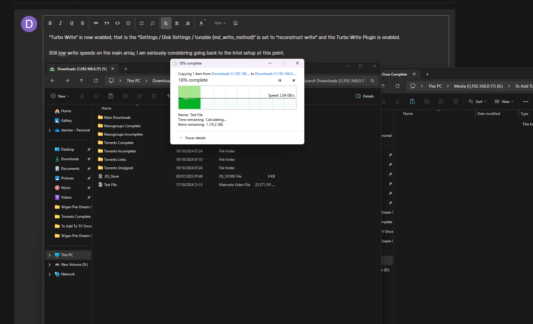

"Turbo Write" is now enabled, that is the "Settings / Disk Settings / tunable (md_write_method)" is set to "reconstruct write" and the Turbo Write Plugin is enabled.
Still low write speeds on the main array, I am seriously considering going back to the Intel setup at this point, the problem with that is I cannot run 2 extra NVME SSD's as the board doesn't support Bifurcation.

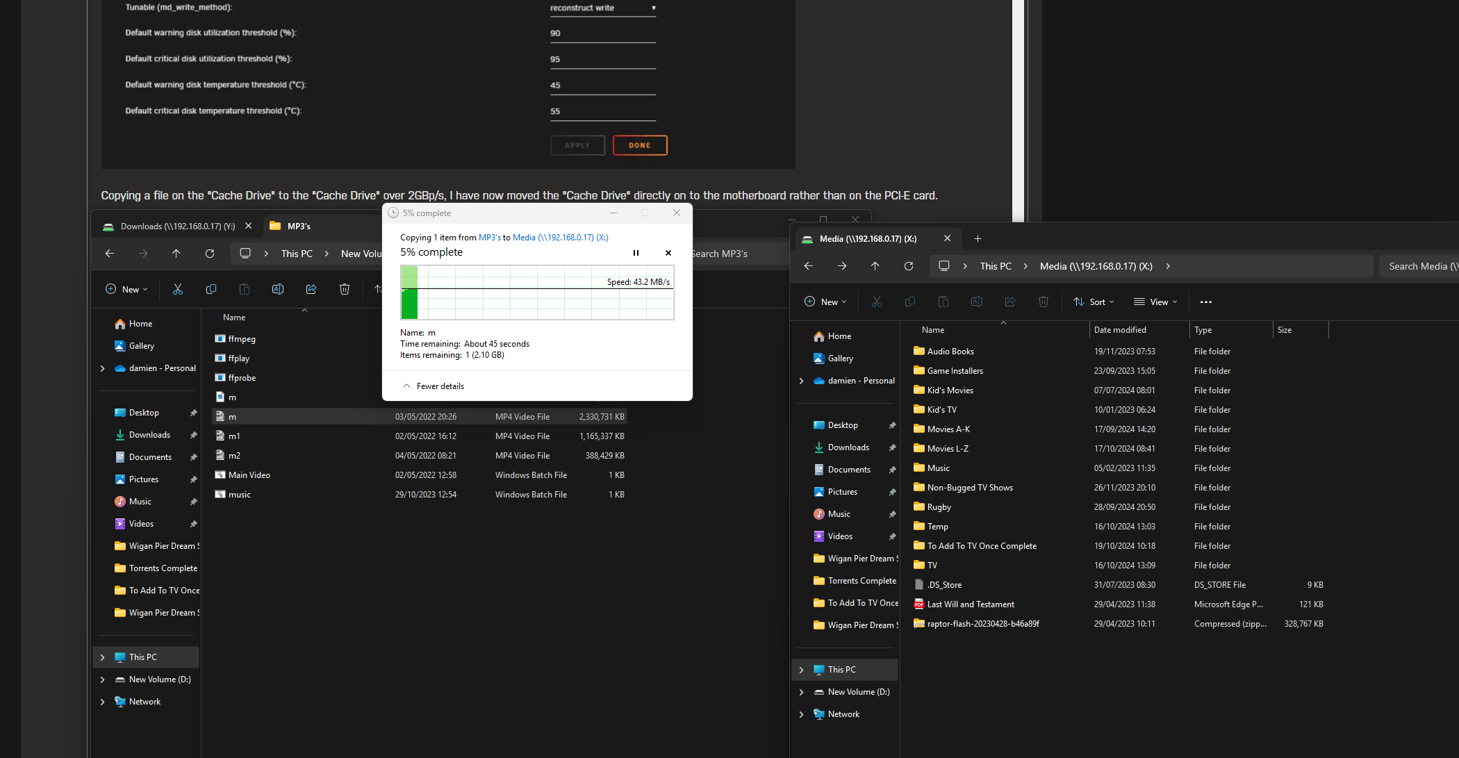

Copying a file on the "Cache Drive" to the "Cache Drive" over 2GBp/s, I have now moved the "Cache Drive" directly on to the motherboard rather than on the PCI-E card.
Copying from my PC directly to the Array is still limited

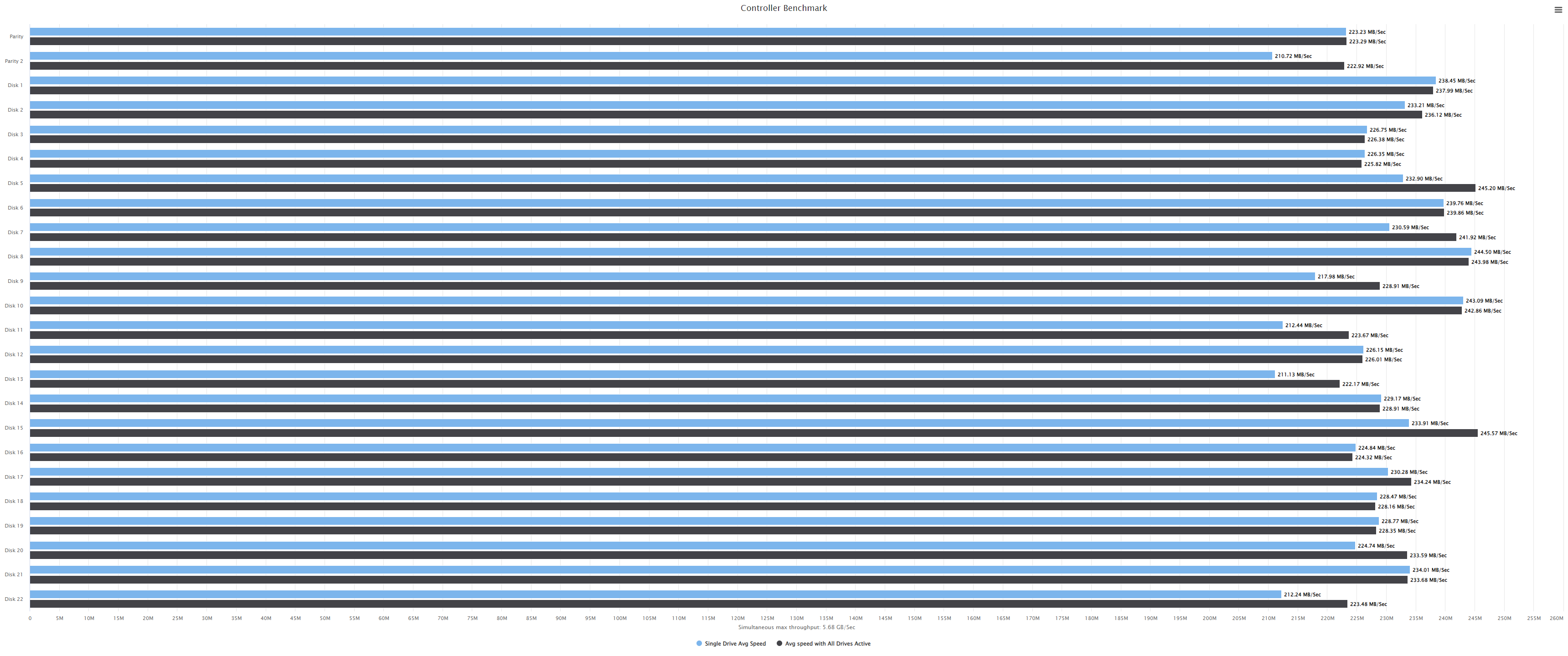

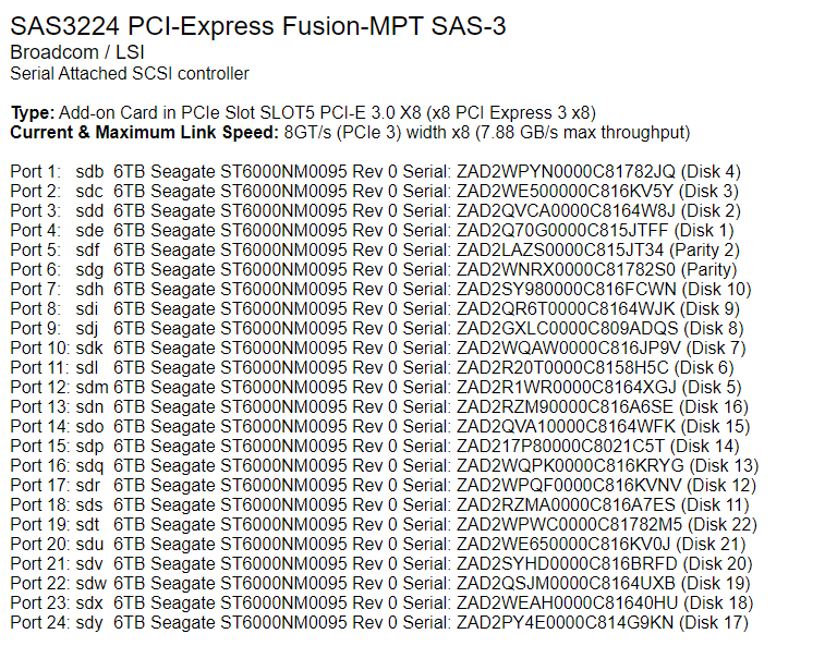

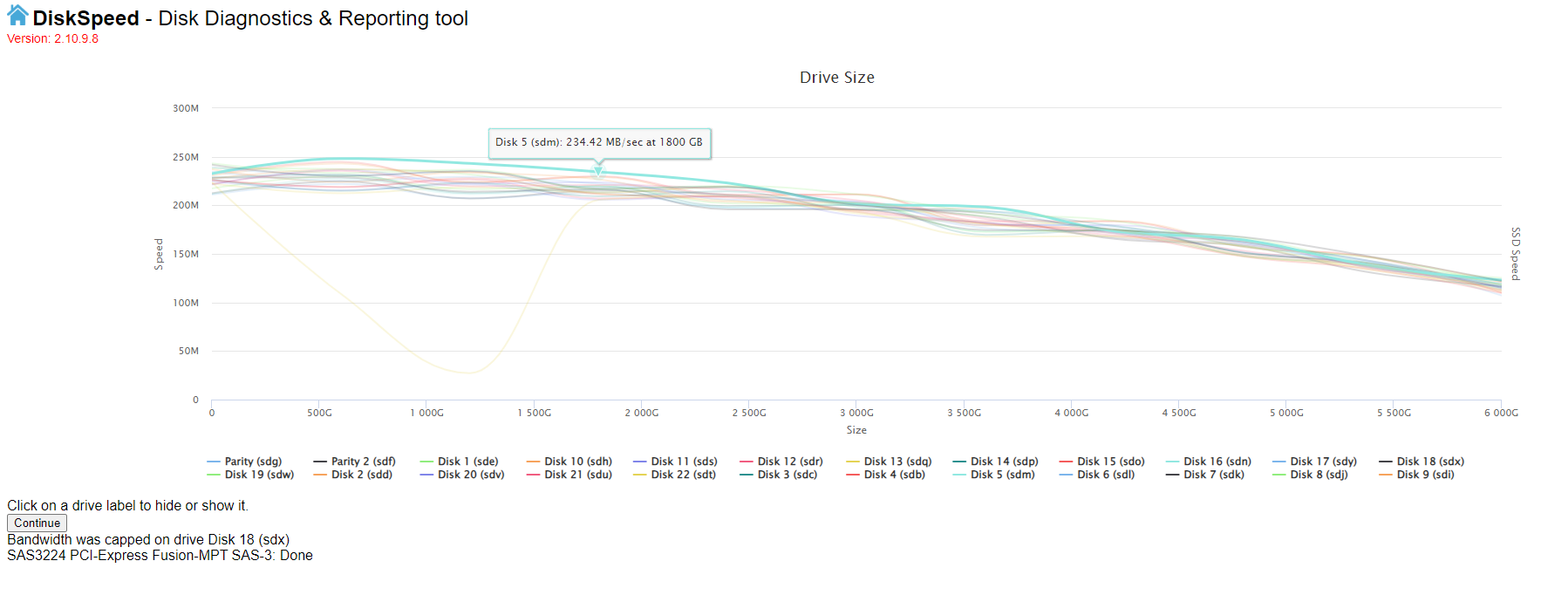

So I ran the Disk Speed.
ControllerBenchmark.thumb.png.8917c67e68f90941dfdc940168fda677.pngControllerBenchmarkInfo.png.41e286f74d62392049fb4b0d585bd82d.png

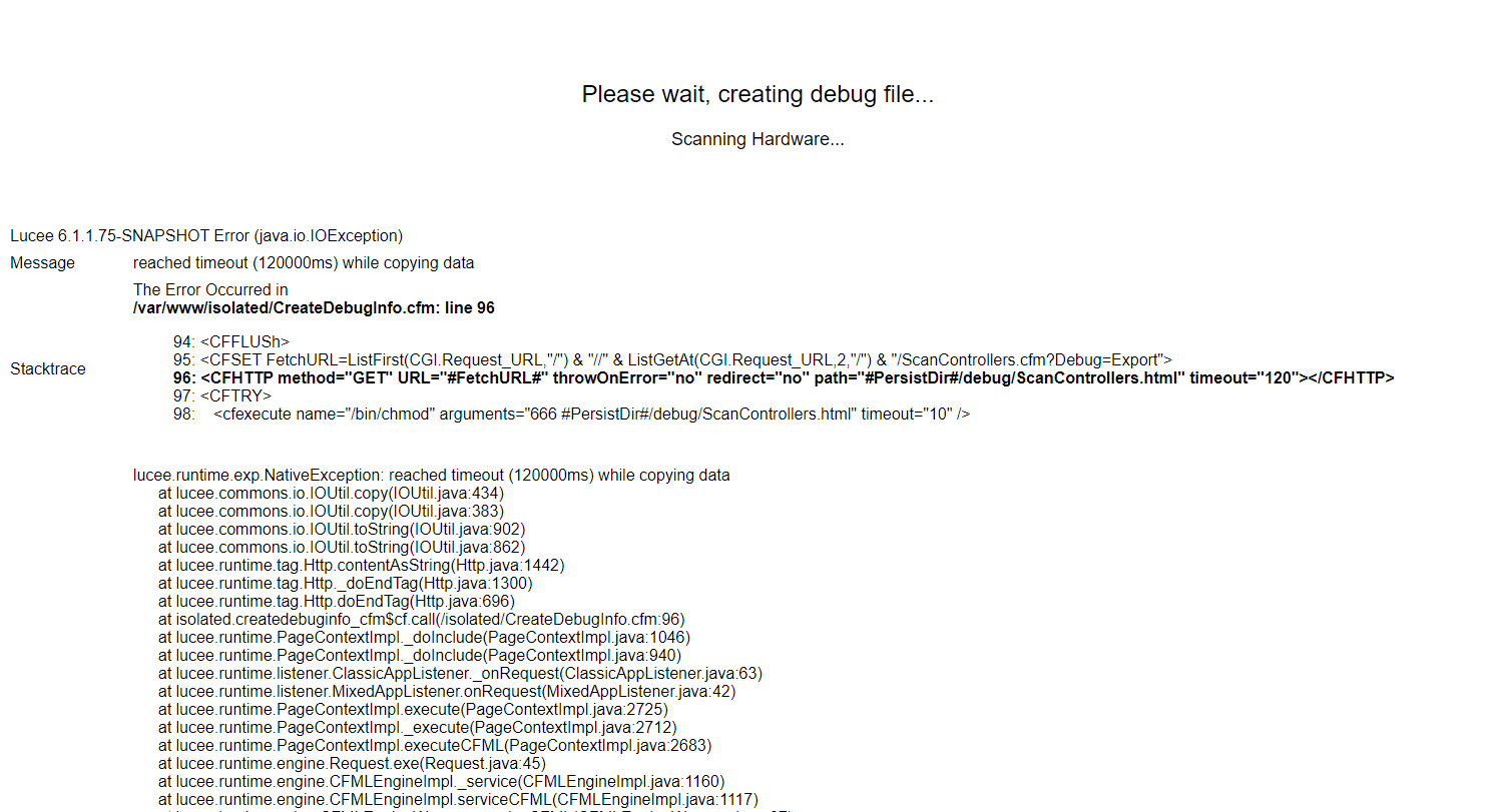

I then did the "Disk Bencmark" and it kept giving "Speed Gap" errors and eventually "failed" but I tried to get a "debug file" but it won't create one and instead give this
I am running the "Disk Benchmark" again but with "speed gap disabled".
What I don't understand is, the drives are clearly capable of much higher speeds than I am receiving and higher than I was getting on the Intel setup.

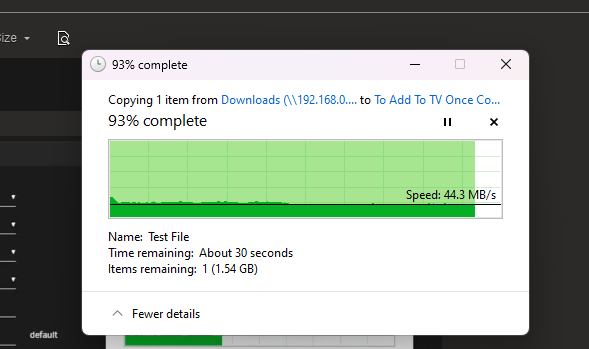

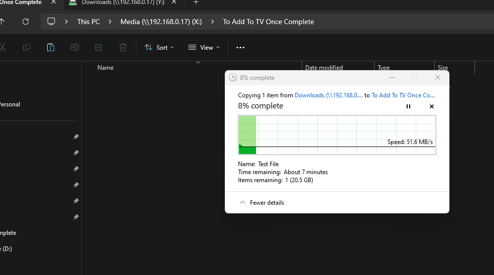

The controller test is the one I wanted to see, and it looks good, post a screenshot from the Windows explorer transfer graph during a large file transfer directly to the array with turbo write enabled.

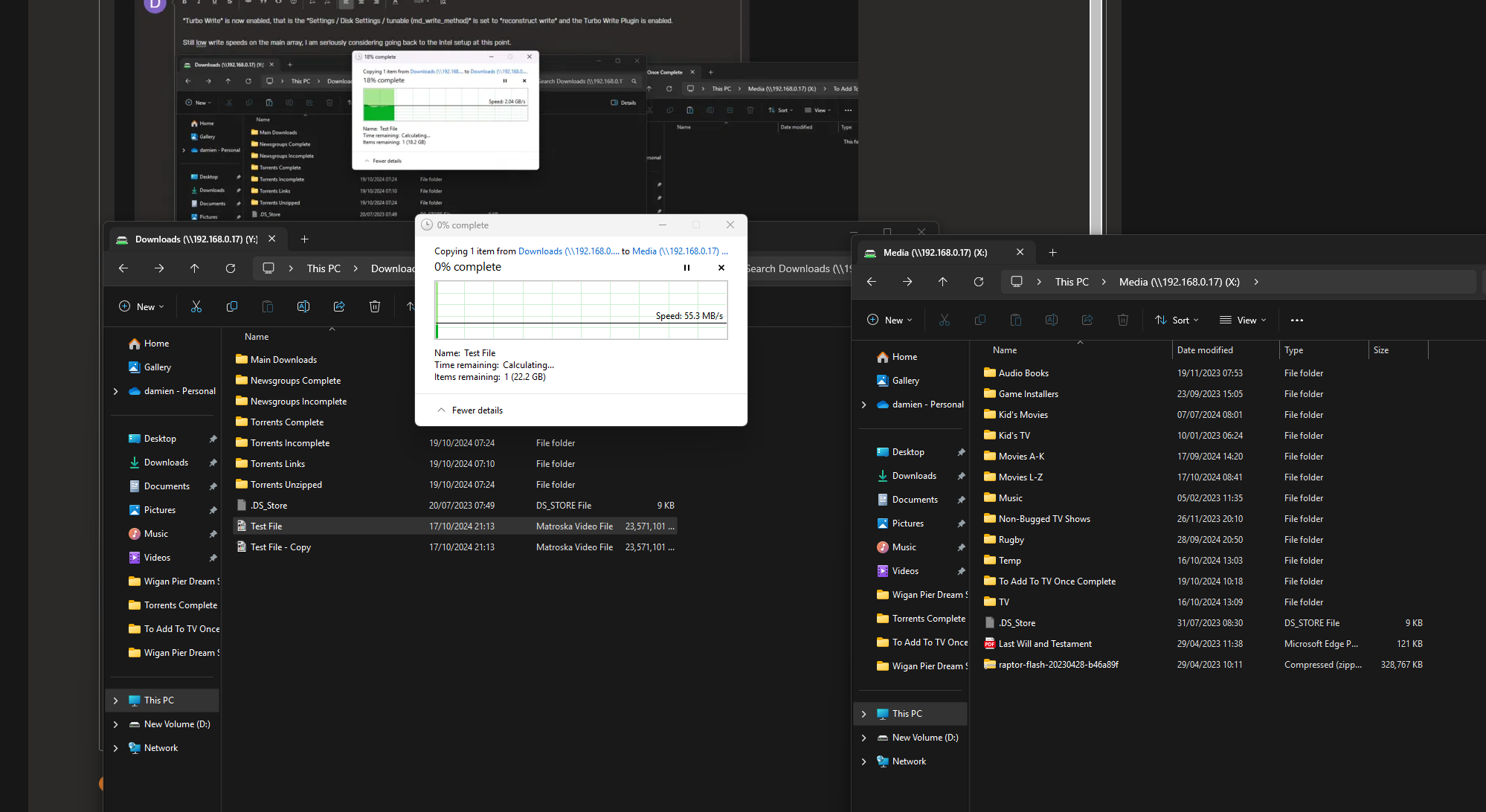

Turbo Write is enabled.
The speed is low from the start, suggesting a network problem, run a single stream iperf test in both directions and post the results.
I will look at it when I finish work in 4 hours.
First can I just say thank you for the help offered so far, it looks like it's leading to the right direction to resolve the issue.

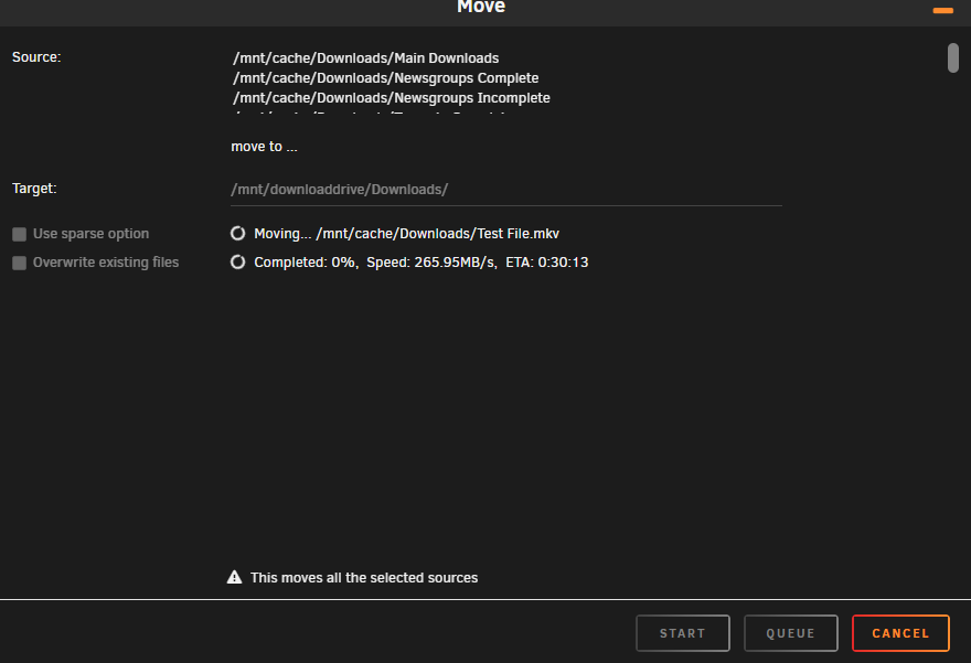

Ok so the Cache Drive is a 2TB NVME Samsung Drive, I have the "Mover" set to move all the files from the "Downloads" share from the Cache to the Array when it reaches about 90% full or something like that, and recently I clicked "Move" without thinking, so everything was moved off including the "Test" file I was using to test the "Cache to Array" speed, so it was effectively "Copying" the file from the "Array" to the "Array" which given the drop in speeds on these drives when they get as full as they are, may explain why the speed was so slow for that.
When copying from 1 NVME Drive "Damiens Storage" to the "Main Array" it was topping out at around 98MBp/s currently which again would probably match up with the speed of the drives when they are this full as they are all around 80%+ full.
Currently I am messing with the drives and copying from the Samsung Cache drive to a temp drive (Lexmark) NVME, I am getting the below speeds
