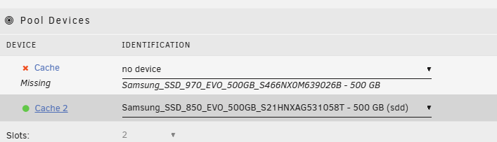

I have two m.2 SSD's selected to be used for Cache.  I self diagnosed (in my head) that one of the SSD's that had some SMART errors may be going bad.  I stopped the array, removed the disk (listed second in order) and started the array again.
Now I'm getting an error - Unmountable: Unsupported or no file system

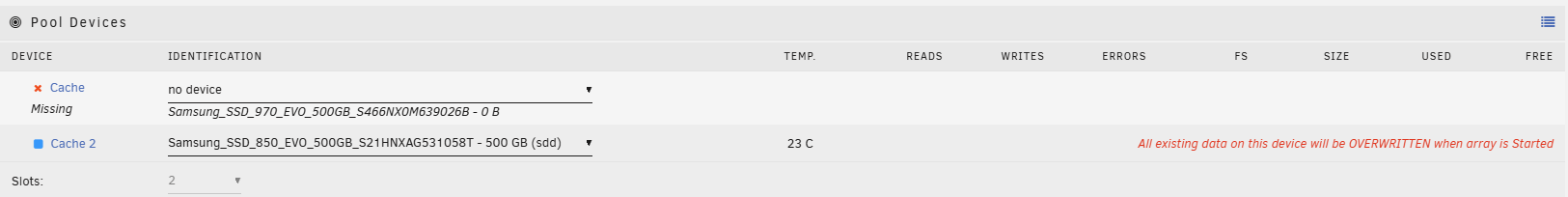

Hi JorgeB, thank you for the reply.  Yes, it is still installed in the machine after I removed it from the pool.  It currently sits in Unassigned Disk Devices.  Prior to my initial post, I did look at pulling out the one you point out with the medium error, and add this other device back, but it states "All existing data on this device will be OVERWRITTEN when array is Started"  That's where I stopped.
Is there a way to get the array started with just using this second device and keep the data?

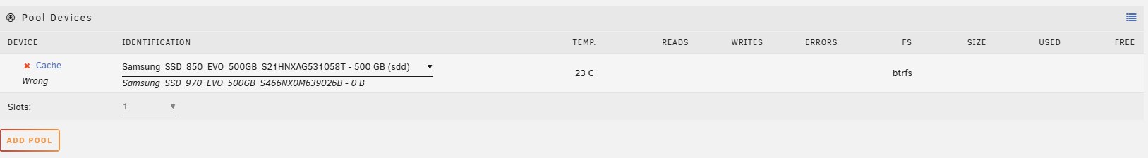

Just poking around, I was wondering if I could set the slot to 1 and put in just the second devic and start it ok.  The gui at least that way does not say it will be erased.
Stop array, unassign all poo devices, start array, stop array, reassign only sdd, start array, post new diags.

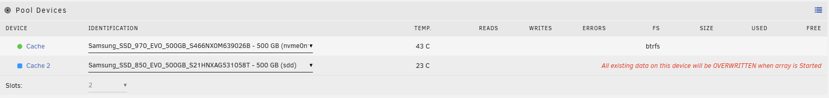

Now unassign both pool devices, start array, stop array, re-assign both pools devices, start array and post new diags.
Ok, done!  I do see the pool started and there is data!  I'm attaching the diagnostics.
I do wonder the state of the nvme0n1 device.  If i need to pull it out to avoid corruption (with docker, etc) again, etc.  TY sooo much for your help so far.

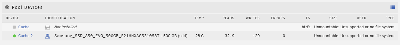

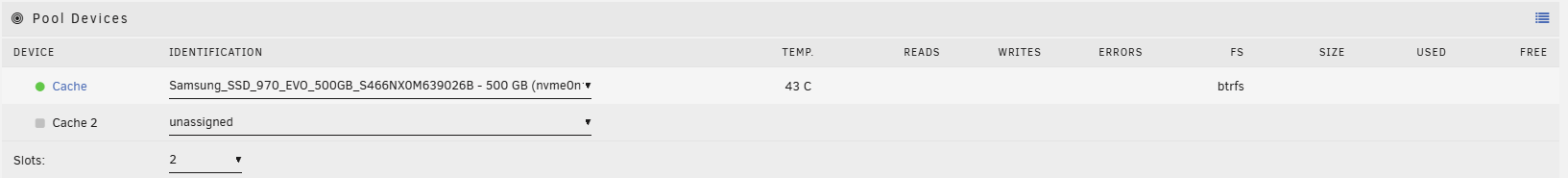

Pool is raid1, so now try to remove the nvme device which is still showing errors, stop the array, unassign the nvme, start the array.
Ok.  That's exactly what I did prior.
I stopped it again.  I Changed the nvme to No device.   I checked the "Yes, I want to do this" box, and started it again.  I'm now back to the sdd device showing as unmountable: Unsupported or no file system.
So, should we go back through that again, but this time not add the nvme back at all, but keep the cache as a single disk with just the sdd?  When this kicked off, I was getting lots of issues with the docker and VM service not running correctly, and seemingly corrupting some files.
For the time being, I went back through the same steps and have it back with both disks mounted.  I'm going to try to get some of the appdata info FTP'd off the server as the CABackup  app stopped working so my backup is nearly 2 years old.  I'm a bit worried that that disk will cause issues with corruption, etc.  I guess if you can think of a good way to just mount the sdd disk only, that would be good.  I can just re-copy again to ensure it is good data.
Thanks for your help so far.
It's a good idea to try and make some backups, but docker and VM images may already be corrupt, I had noticed that in the previous diags, but try to backup what you can.
I ended up pulling the physical nvme disk to simulate a failure.  After that, the array started ok and I've been successfull getting most of the data.  Thank you Jorge.  🍻
