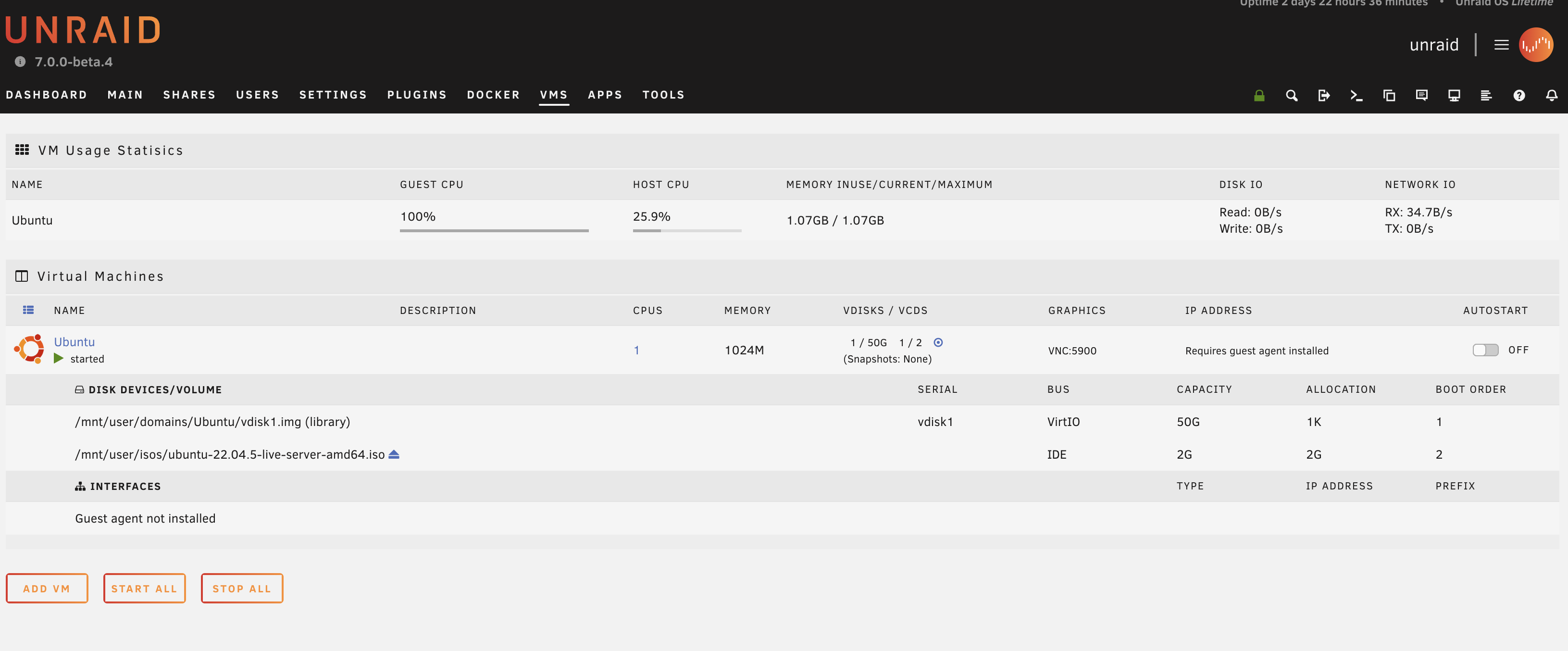

Hi Simon. I tried again after fixing the NVMe issue. It did the same thing, i.e., hung duting the install. I realized that it does hand on the network, somehow. I'm not sure whether it is related, but each time it does that when it downloads packages. It goes through 1, 2 ... 14, then nothing. When that happens, I can't even open a new tty as it hangs forever.

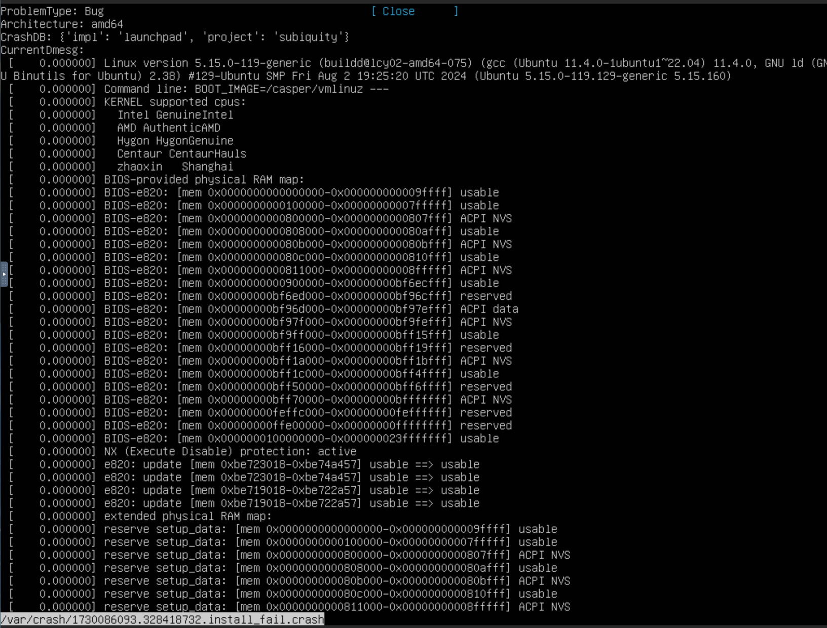

Next, I disabled ens3 and started the script again. This time, it looks like it went further but crashed with the output as can be seen in the screenshot. I could not get the crash file without network. Not sure this has anything interesting, though.

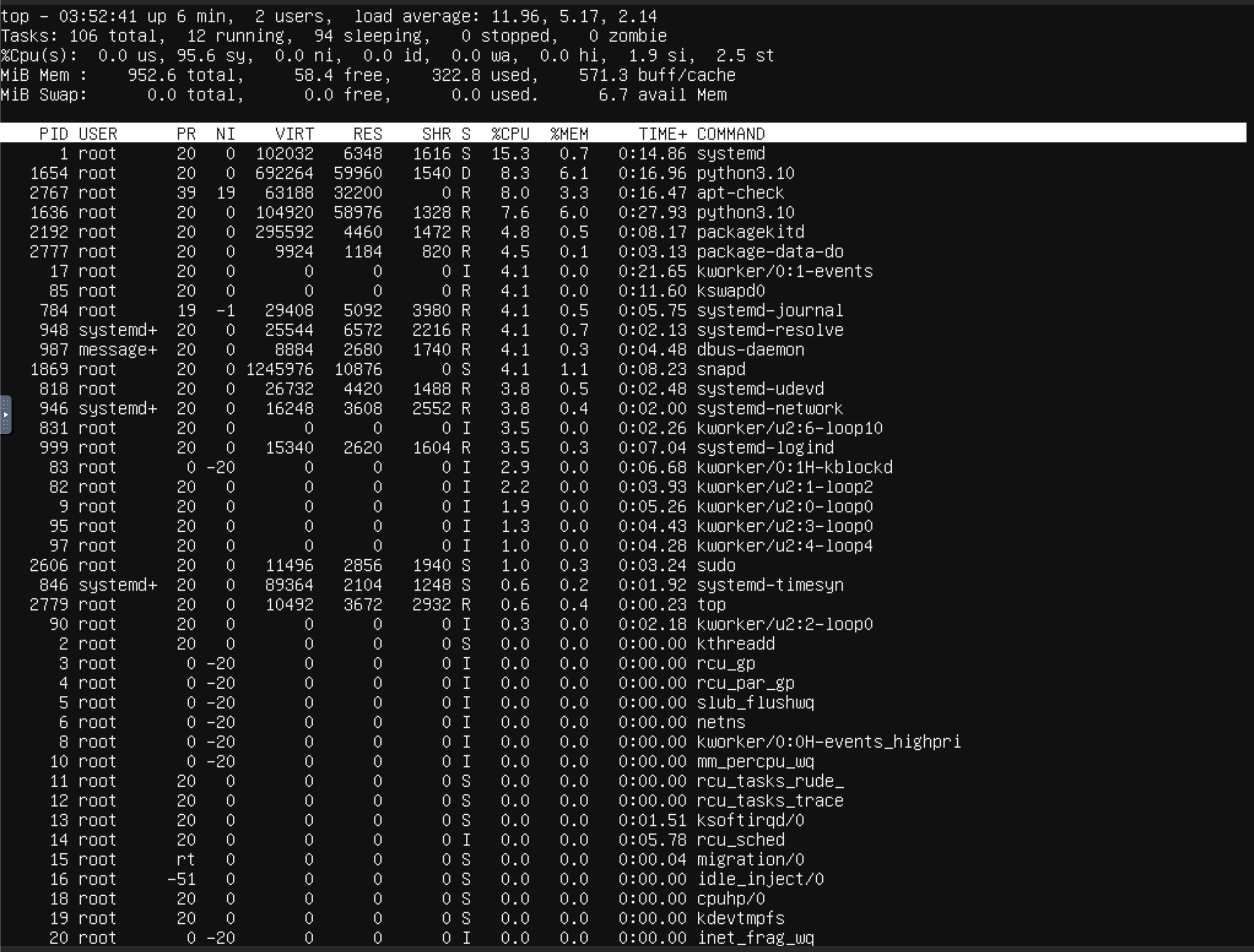

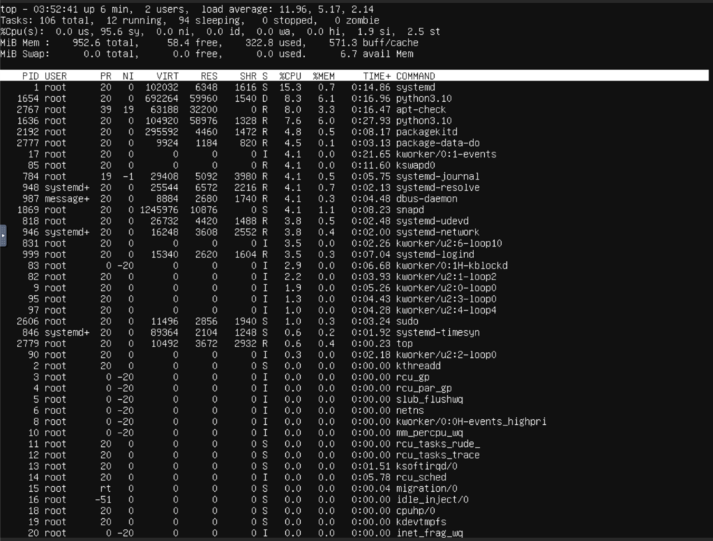

Then, I tried another VM with all default network settings and again, it hung forever at "Featured server snaps". While Unraid was showing the CPU at 100%, a top on another console in the VM shows that all was pretty normal. See screenshots.

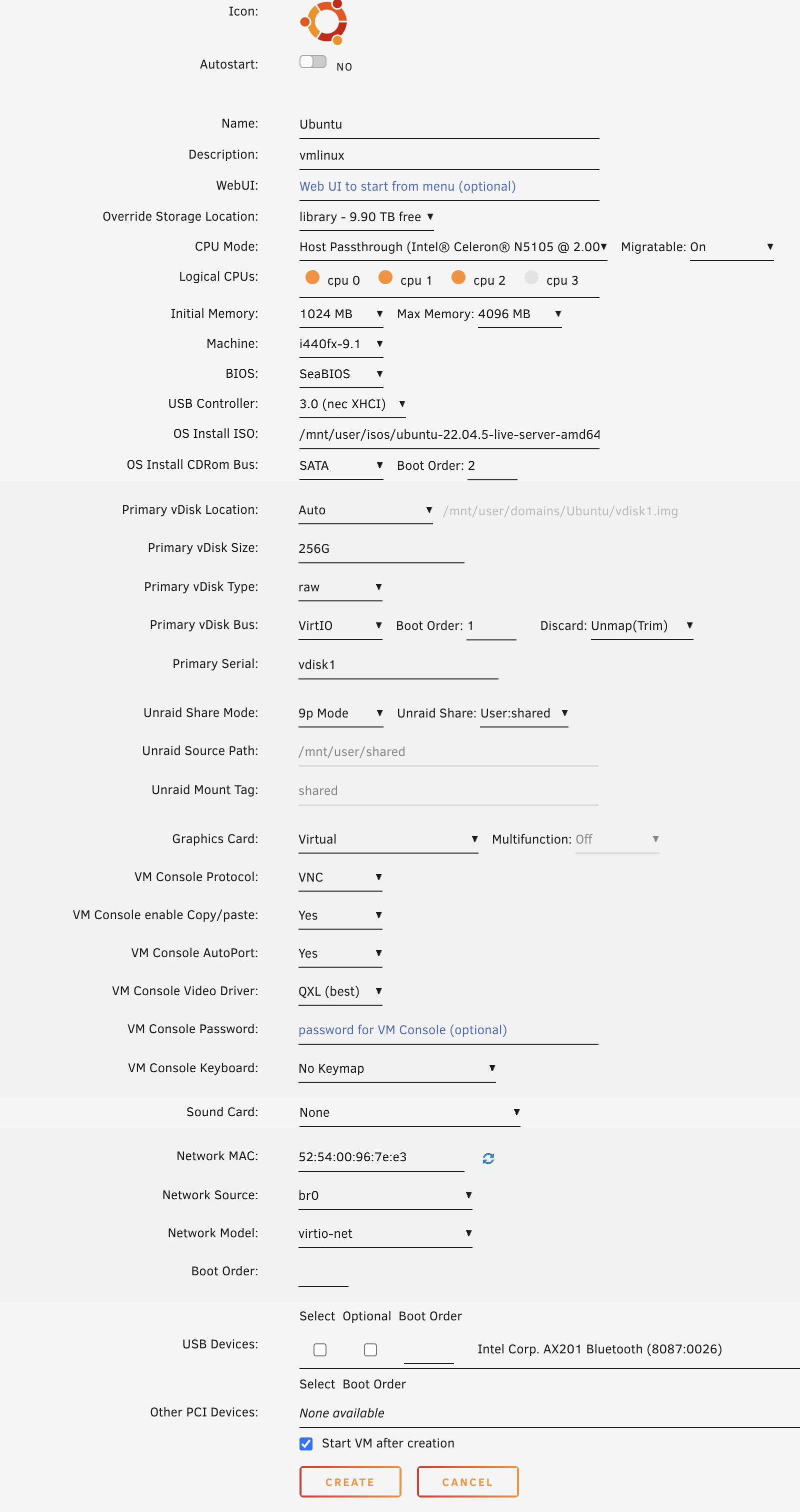

I then tried again with modified params (see enclosed). It ended the same way: hang. I opened another tty before starting the install so I could run top. It shows that kwapd was taking 60-90% cpu, but sometimes less. free took about 5 minutes to execute (with 3 vCPUs). The script went as far as "Get:30 ... universe amd64 Packages [1133 kB]" then nothing.

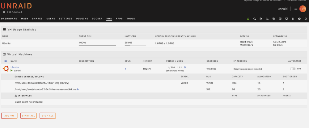

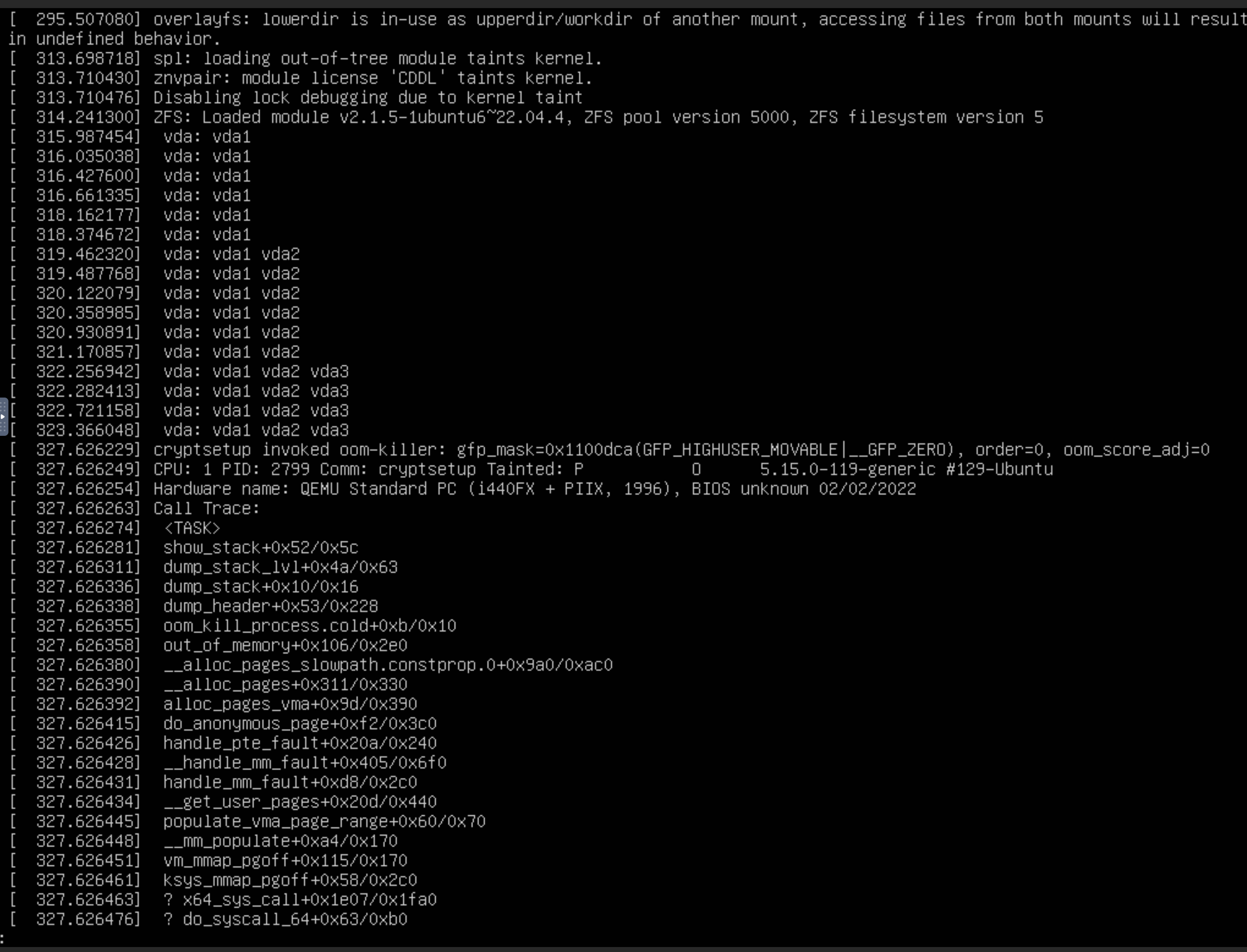

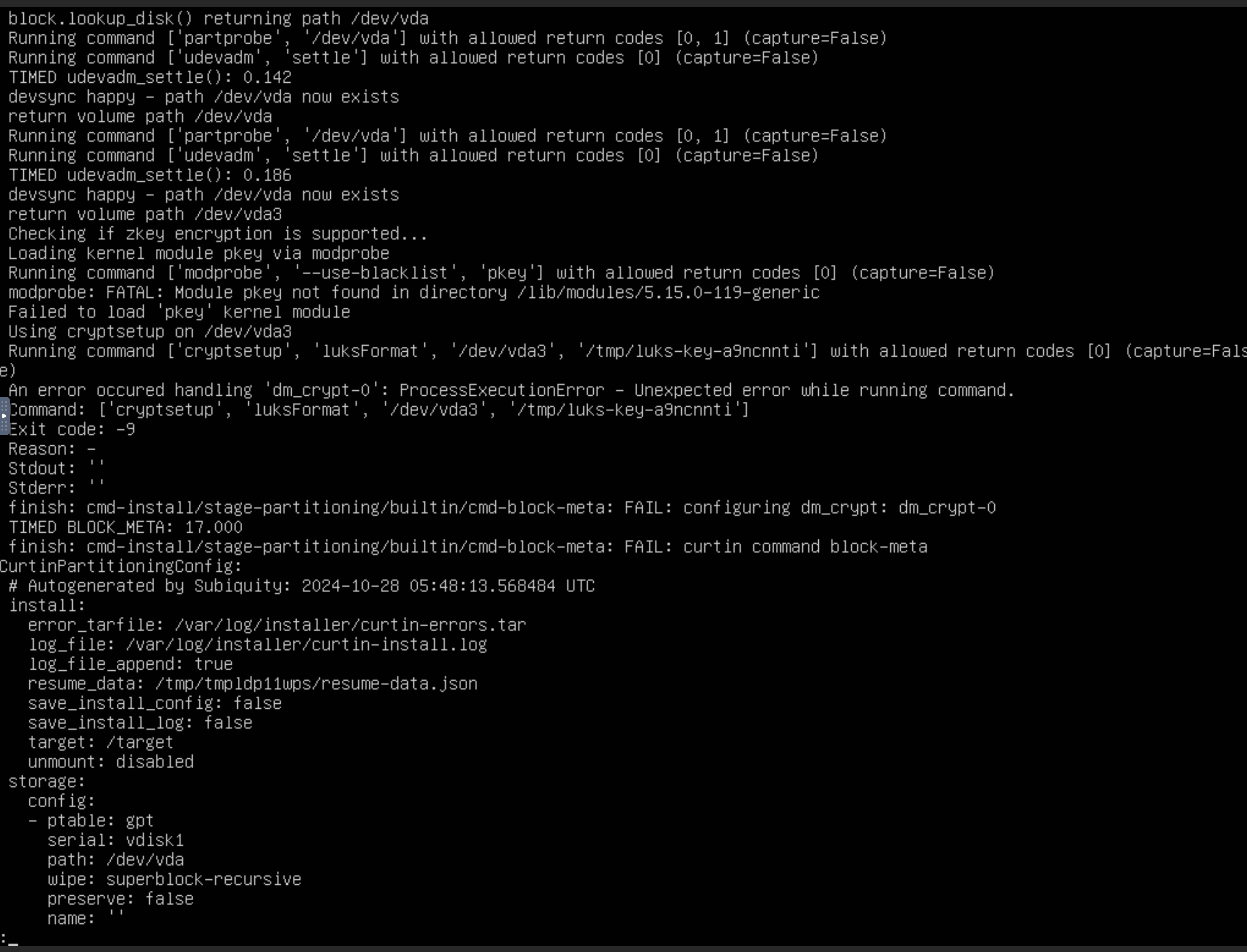

I think I'm seeing what's happening here, hopefully. I created a new VM and, before the install started, I shutdown the ethernet connection, which somehow allowed the install to go further down. While creating encrypted partitions, it crashed similarly as it did before —but can't confirm 100% as It didn't keep the previous log— but while going further down the log, I saw a OOM-killer executed on cryptsetup (see screenshot). Then, further down in the install script, there was an "unexpected error while running cryptsetup" (see screenshot). I did configure the VM with 1Gb min and 8Gb max, but running free -m on another tty showed around 780Mb. Is the min RAM var during the install a fixed vs. dynamic value?
I'm going to try it again with 4Gb min RAM and see what happens.

That's it... It works. I was under the wrong assumption that the RAM min/max was a dymanic value.
