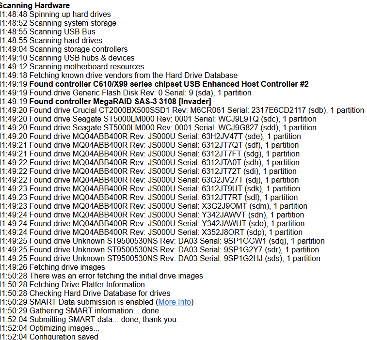

Installed DiskSpeed and ran that.
After continuing it gets stuck at.

So that file is on the pool?
You are using a RAID controller, those are not recommended, especially for SSDs since TRIM won't be supported, can you connect the SSD to the onboard SATA and retest?

Where did you see that? AFAIK only LSI HBAs in IT mode support TRIM, and even those have some limitations:
https://www.broadcom.com/support/knowledgebase/1211161496937/trim-and-sgunmap-support-for-lsi-hbas-and-raid-controllers
It it still uses the megaRAID driver, there'e won't be TRIM support, post the diagnostics.
