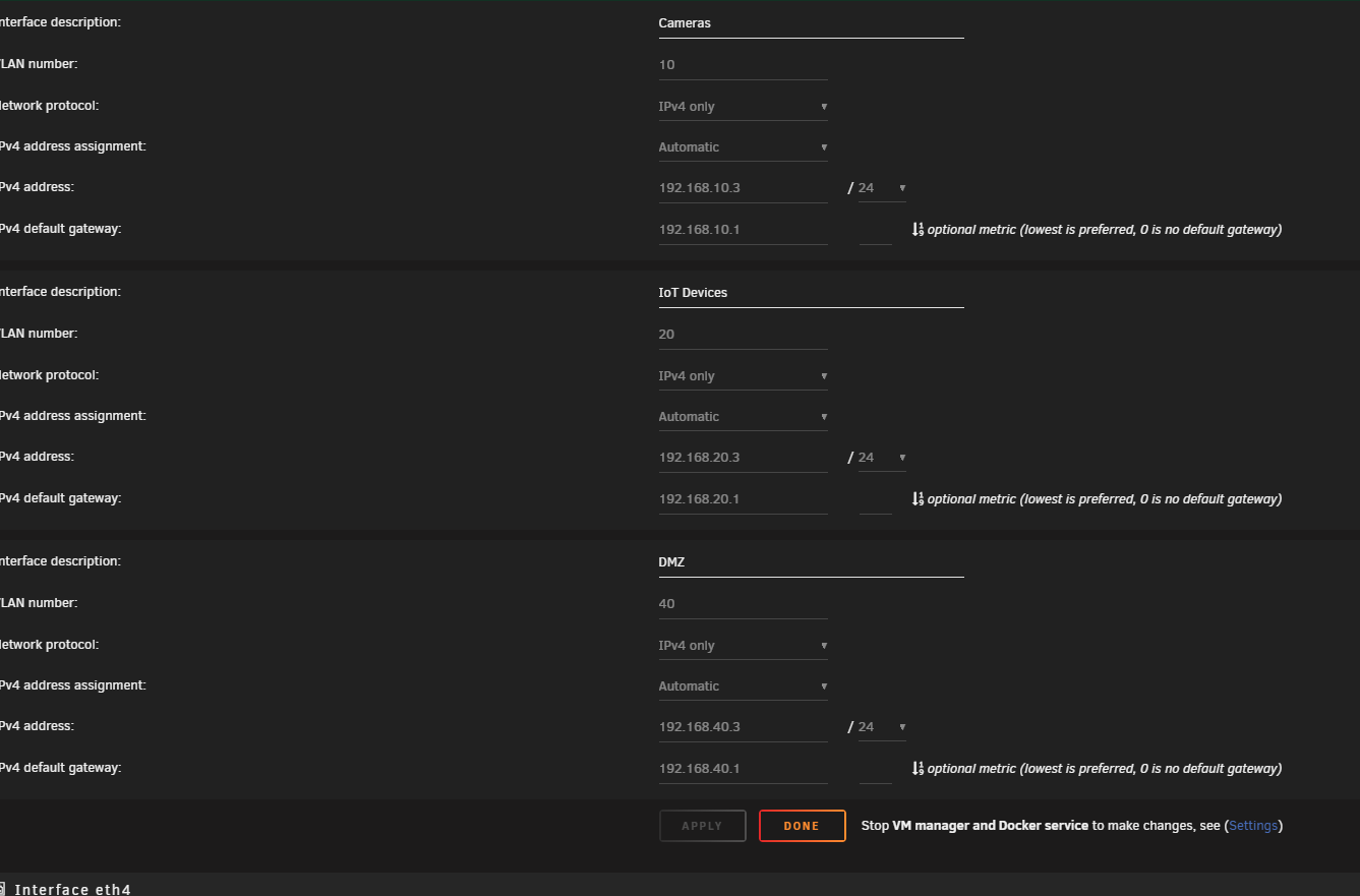

i recently upgraded to 10g fiber network so i dont need my 4 port network card i was using for
IoT, Lan, DMZ, etc
i use my on board nic as Management port  and the fiber port  as for the others using them as  Vlans
10 cameras
20 IoT
etc

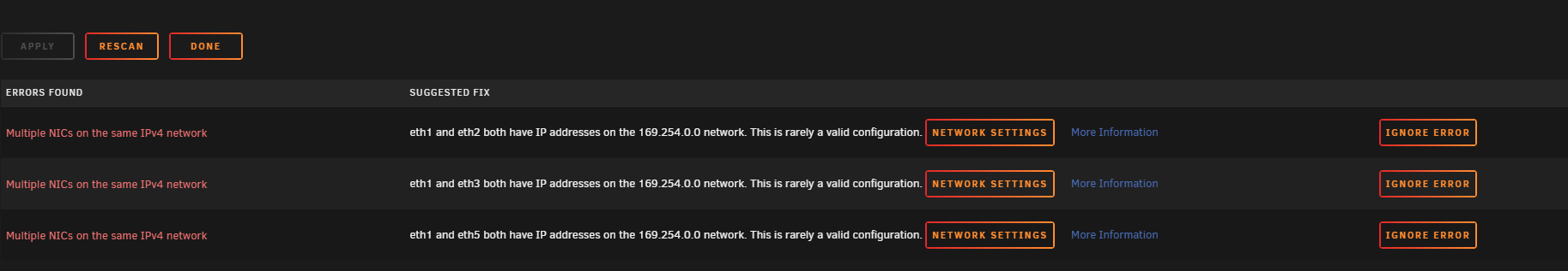

Oct 24 11:38:10 Tardis root: Fix Common Problems: Error: Multiple NICs on the same IPv4 network
but i getting error nows  I got multiple nics on the same nic.. i cant see nothing under network settings    they all seperated  ok
what can i do to fix that?
and i ran the fix common problems and all it does it hang  on the scanning part  sits there 15 min+    and nothing happens  just hangs

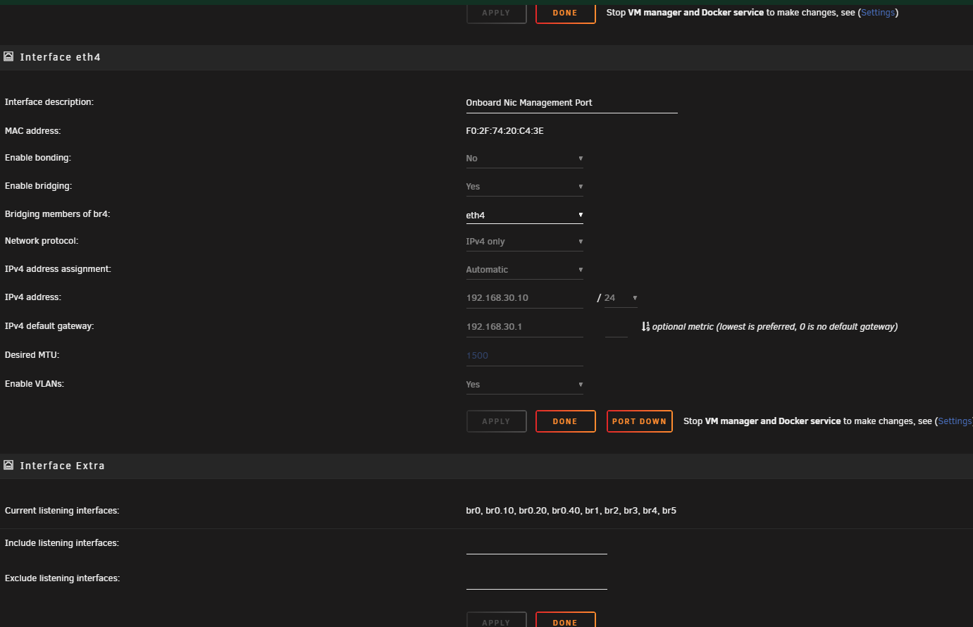

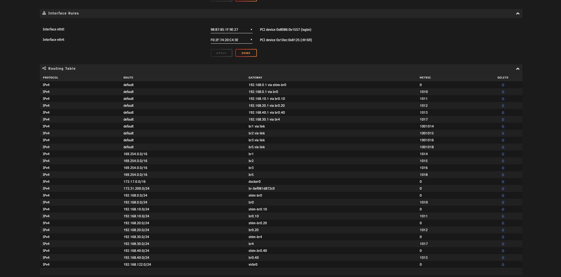

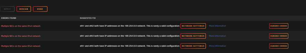

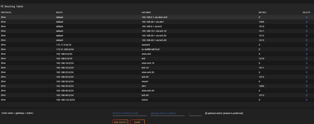

i did a new reboot and finally got fix common issues to work it didnt hang  and its giving this ip address issue...   but dunno how to fix it do u ignore it button  or is there a proper way to fix it?
i tried deleting this ip  under network settingss they the br1 - br5  but it wont let me delete this ip from the routing table
Edited by comet424
you have 3 interfaces with a ip conflict.
or otherwise set to static with no configuration... ?168.254.0.0? are these interfaces connected to a network?
Regardless, you will need to create a bridge interface. Assign the ip address to the BR# interface...
attached the 3 interfaces to the BR# created...
Example terminal commands.
ATM, per your pictures, as the data shows the same Ip asigined to the nics with the same ip.
Sadly interenet TCP ip rules:
1 nic per a different IP address.
the ip is unusable as there is no route for the defualt route to dev interface#. You can't have the same ip on mutiple nic.
This is where bond vs bridge come in,
With the reboot it would help if you post another diag. as it seems more like the interfaces were assigned a 192.168.x.x address but not applying to the interfaces. and it appears that you have mutiple br assigned casuing issues...

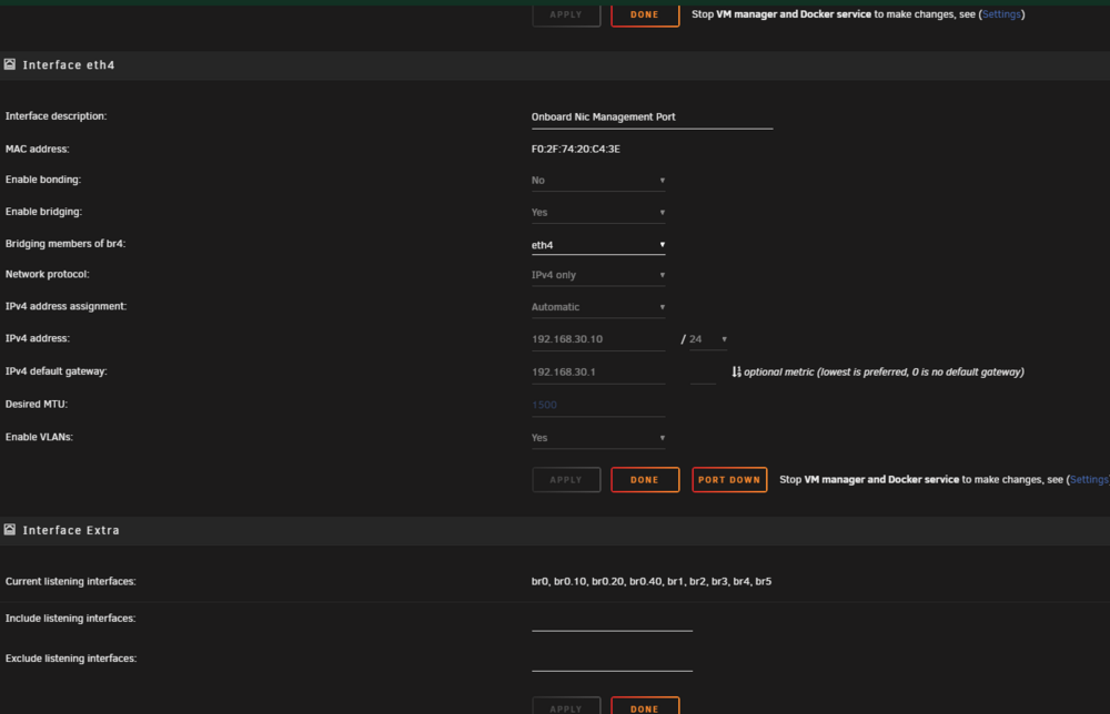

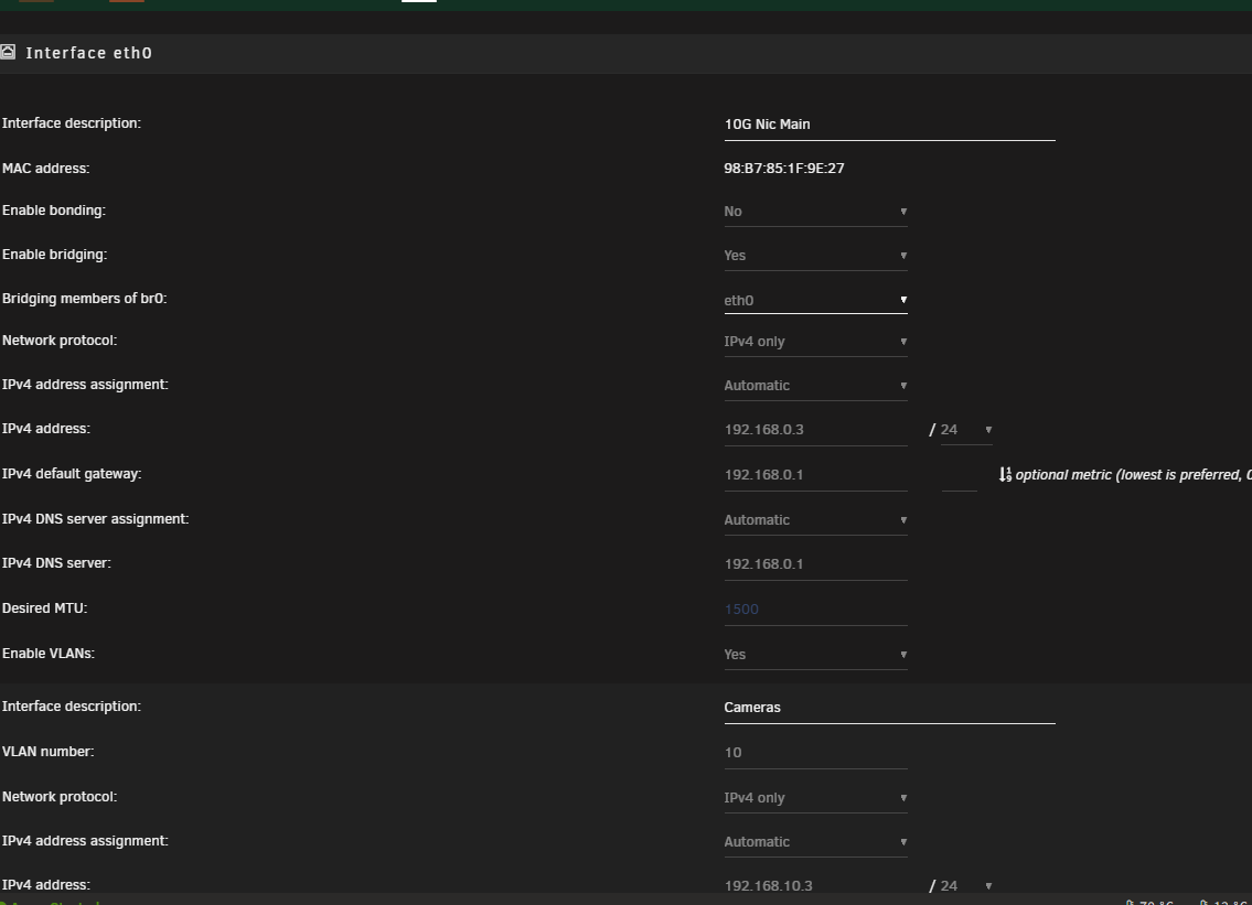

but from the pics above.. show i only have 2 network interfaces i use
1 10gig
1 1gig
interfaces
i used bridge on  the 10gig to do that 3 Vlans
Lan (br) br0 or whatever you call main  192.168.0.0
br10 = Cameras Vlan   192.168.10.0
br.20 = IoT Vlan          192.168.20.0
br.40 = DMZ Vlan        192.168.40.0
and then
on the 1 gig    is the management port 192.168.30.0
now the 169.  isnt that for when an ip address doesnt work anymore?

like i try clicking the garbage can to delete routes that does nothing...    i tried looking in the flash drive  under network.cfg to see if there was old card that i moved from  i didnt see
i didnt get this error till after i unplug the card
so what i did was i had the 4 port card in  that had  Iot Cameras Dmz
and then i made the vlans on the 10gig  made sure it got that working... and then i  i modified the network cfg  to point from the network 4 card   to point to the 10gig to fix the bridge issues i had... and no issues   but now i decided to pull the 4 port card out to use it in another comp...   and when i boot up  thats how i noticed  now  i getting this error
and i not able to delete any routes  from that routing table
hope that helps
Thank you for that additional information. Since that server is experiencing this, I would recommend an network config purge. This means deleting the netwrok.cfg files from the boot device, rebbot. Then unraid at boot would then recreate the entire network config at boot..., booting into dhcp at first boot and you would need to reset up any vlans, bridges, ip route, configurations.
It is werid that your unable to delete. But some routes are made by default due to the exisitence of other bridges.
My Working Theroy atm:
When you pulled the previous nic card the PCI IRQ and pcie device names changed, sometimes that change will also change the name of interface names.
You have a lot of exisitng br# interface calling eth1 to conect to eth3/4/etc that no longer exist. But without the abilty to remove the bridge / route I think a netwrok reset would be best.

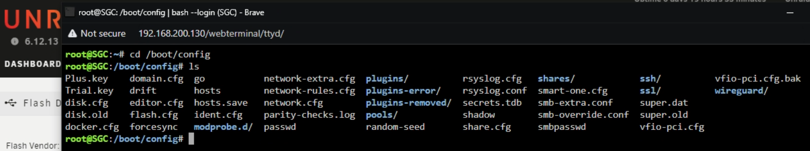

Step 3 Delete some config files.
open terminal / web ttd
cd /boot/config
ls -a
 your mainly looking to find network.cfg ther are some other file we want to remove as well (theses fiels are backed up in the flash backup made earlier...
We want to remove any file that starts with network...
As This is the confg file that loads at boot that setups networking.
rm -f network*
Then reboot.
This will reset unraids network configuration back to netwrok default.

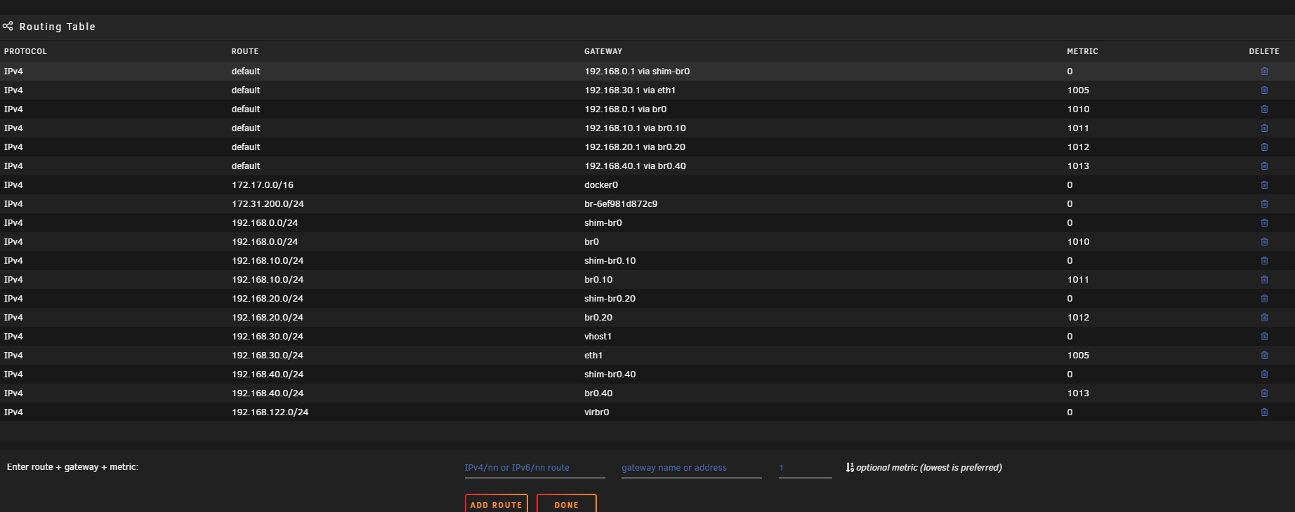

ok that seemed to fix the issue...  i dont have that big list..  i had to google what a LXC is  not 100% sure what it is  some linux container or something but i blew out the network configs and re did  and adjusted the order  and thats seemed to fix it...  i still get this warning  and i not sure is there a way to fix it?
Oct 26 11:52:08 Tardis kernel: igb 0000:08:00.0: The NVM Checksum Is Not Valid
Oct 26 11:52:08 Tardis kernel: igb: probe of 0000:08:00.0 failed with error -5
ive seen this before i tried googling i never found how u fix it.. is there a way to fix this?
and these routes look better now least seem to be   i appreciate the help so far... as that was frustrating and didnt know what was going on

so the 10gig nic is my main  it routes all the traffic.. i only use the onboard nic  to be able to access unraid or wake on lan it...  but all traffic all  vms dockers all now go through the 10giger  so  is my 10 gig nic firmware up to date can you tell?

as for the diagnostic  i did upload another diagnostic  with the error  where you see the error logs  but ill post a new diag   i took the diganostic like an hour ago
and u want me to try to unbind and bind now what does it do?
does that disconnect the network card  so should i connect to the 192.168.30.3  then  on my on board..
and does the shim-  go away that seems to be the duplicates  is that where the error for the duplicates  these shims where werever they came from

Lets review your network per diag as Unraid defined:
Interface Ip and cdir Sumbnet:
br0 [192.168.0.3/24 ]
br0.10 [192.168.10.3/24 ]
br0.20 [192.168.20.3/24 ]
br0.40 [192.168.40.3/24 ]
eth1 [192.168.30.10/24 ]

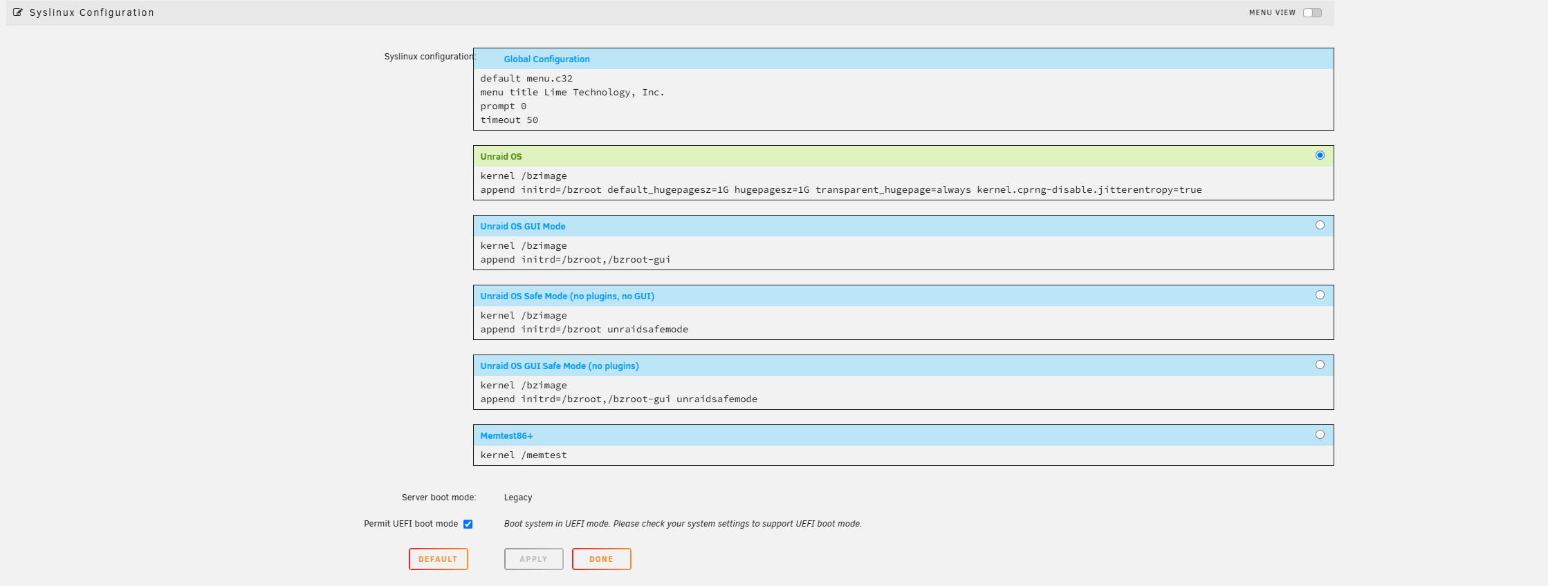

atm you do have a improper syslinux...
BOOT_IMAGE=/bzimage pcie_acs_override=downstream,multifunction vfio_iommu_type1.allow_unsafe_interrupts=1 initrd=/bzroot
since you have vm settings enabled and have set
Please confirm you have theses options and want them:
The click Main > Flash  and fix the data for your grub/syslinux boot
example:
then your cmd line will read coreclty...
BOOT_IMAGE=/bzimage initrd=/bzroot pcie_acs_override=downstream,multifunction vfio_iommu_type1.allow_unsafe_interrupts=1
Here is a addon you can/should run for other recommend options. lets disable pcie power managment and let softrware control this not hardware...
kernel /bzimage
append initrd=/bzroot pci=noaer pcie_aspm=off pcie_acs_override=downstream,multifunction vfio_iommu_type1.allow_unsafe_interrupts=1

and which line  do you change on the flash  gui page
for
kernel /bzimage append initrd=/bzroot pci=noaer pcie_aspm=off pcie_acs_override=downstream,multifunction vfio_iommu_type1.allow_unsafe_interrupts=1
is it the Unraid OS GUI Mode   or Unraid OS
and where is this syslinux?
and where is the command line for BOOT_IMAGE=/bzimage initrd=/bzroot pcie_acs_override=downstream,multifunction vfio_iommu_type1.allow_unsafe_interrupts=1
you mentioned  do i save  under vm manager  from Both to Multi-Function?

Theres a known graphical bug when setting VM settings for pcie overides, and allow unsafe. as this adss syslinux grub kernel otpions to the boot menu. This was notated but as it didn't realy casue any problesm they left it alone, but the line really should be fixed.
Main > click flash  > this pullls the grub/sysliunx that unraid uses to boot... Depends on if you default boot into unraid gui/ safe mode/ etc ... this is what grubs pulls when read from the flash drive to boot into unraid. Sometimes we add or change things to our kernel line to make sure xyz feature is set or unset. In my case, my solid green:
Is Unriad OS and is my default boot option. as I have secondary kernel options I want to use for my hardware I have to add the syslinux option to the grub boot menu to persist across boots its added to the syslinux configuration in the unriad web ui.
In your case, since you have enabled the vm settings for a option for pcie overrides, and allow unsafe. It is recommended to fix the boxes. Optional to add pcie no aer which helps and turns off aer spam in logs. also as power setting on some pcie devices. I turn off aspm which is power management. but that may break your WOL.(I don't want my pcie device to go into power states or power off. As other things are done that break when they do... so I turn their ability to do so off... especially for g-card passthorugh. (I'm not a fan of WOL / snmp on my network I'm old and have used other technologies and will stick to what I know...) Different use case and feature for each others network and there use cases...
Its not improper but better to be read correctly then what it was currently being read as.

In terms of your networking based on your last post. I think your good to go.
You fixed your WOL go call, and fixed any other issues with older modprobe calls from a previous device. The Syslinux was just a quick catch should be fixed but doesn't need to be touched...
