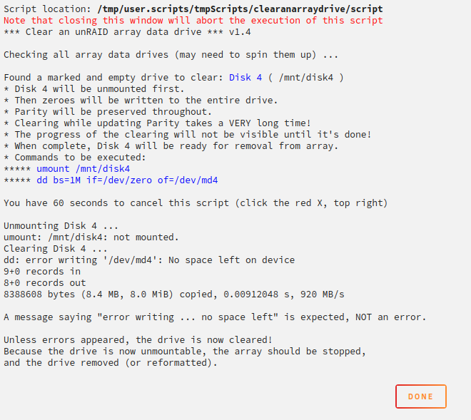

one of my drives is giving read errors and I want to remove it from the array. I used unbalaced to move all data from the drive to an other drive. Now that it is empty, I created the "clear-me" folder, started the "clear array drive" script and was leaving to get a coffee but the script already finished:
Except of the "error writing ... no space left" I don`t see any other error messages.
I am confused because it says 8.4MB copied for a 3TB drive.
It says "Because the drive is now unmountable, the array should be stopped," but the drive is still mountable and I can access it without problems.
It dos not feel right. Can someone help me?

What version of Unraid are you using?    That script needs changing before it will work correctly with current releases.
I am runing 6.12.13
  • bubiman changed the title to Script "Clear array drive" appears to be to fast for "Clearing while updating Parity takes a VERY long time!"
There are two issues with the script that I know about on 6.12.13:
  • the device name is of the form /dev/mdXp1 and not /dev/mdX1
  • after finishing the Clear the array does not closedown properly as it cannot unmount the drive just cleared.  I think you need to mount a dummyloopback device in its place to get the array to stop cleanly.
