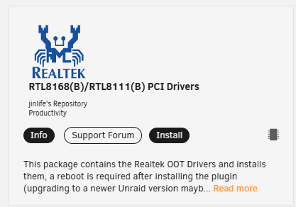

You may need to install driver plugin:

your using a realtek nic. and there have been some known issues with that lately with the new kerneal.
driver: r8169
