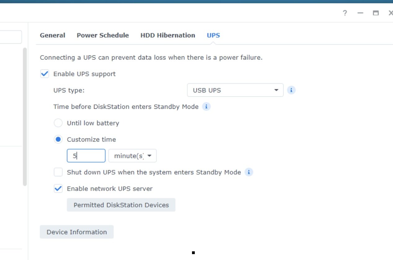

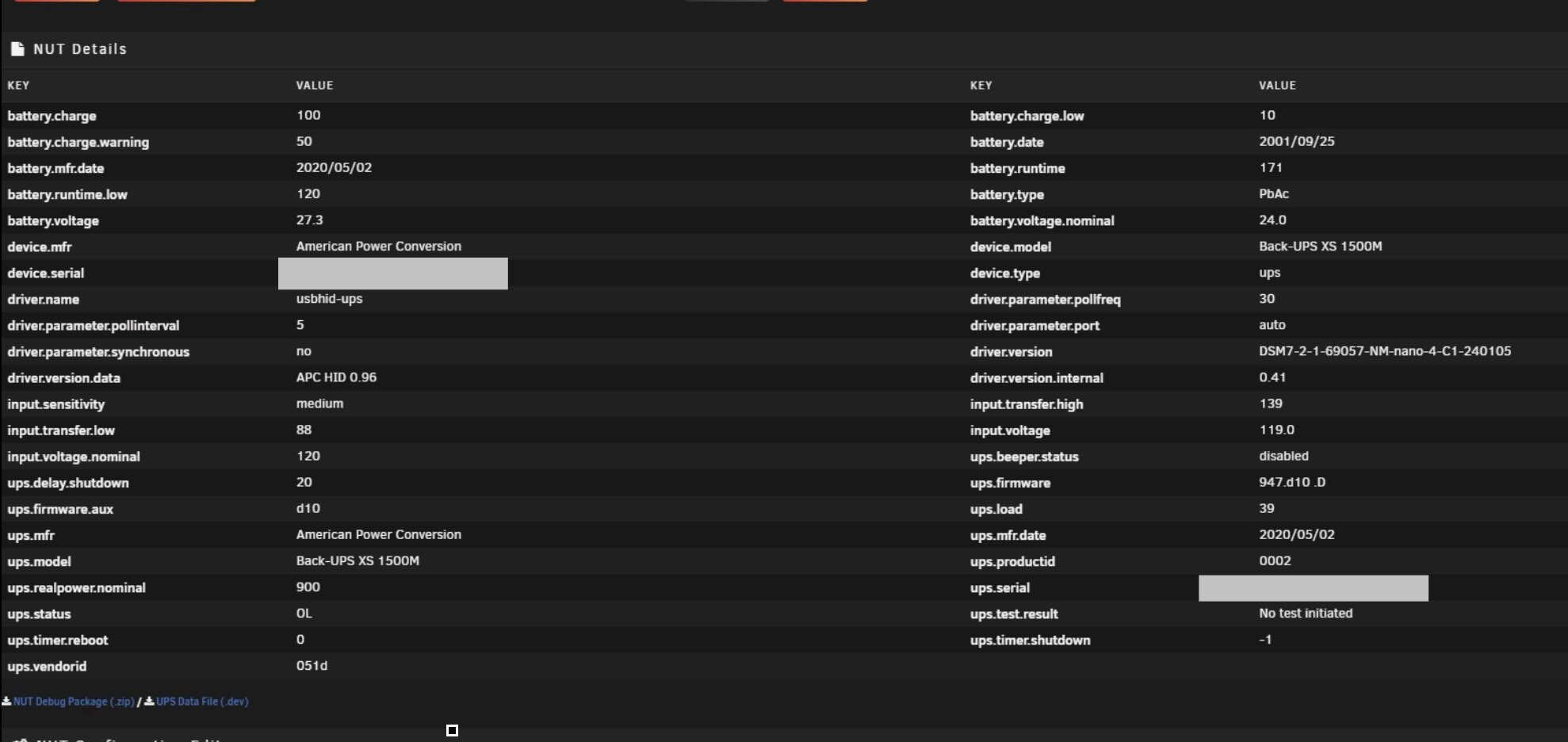

October 30, 20242 yr Author I added the unraid up to my synology devices in the ups section and have the setting applied below. Here is an image in unraid showing that it does see my synology ups and can read the information from the ups. So they are definitely linked.
October 30, 20242 yr Author It’s just for some reason after unraid initially shuts down when it’s supposed to during a power outage, it’s like synology is continuing to send a shutdown signal to unraid that persists indefinitely until I shut off the synology ups server. When I shut down the ups server on synology then unraid can reboot and I can turn back on the ups server.
October 30, 20242 yr Problem likely once Synology enter standby mode when UPS on battery timer reach, as below post said you need reboot Synology ( to exit standby mode ), then reboot Unraid. Suggest solution are don't use Synology be NUT server or use other platform / device as NUT server. Or you can swap Unriad be NUT master and Synology as client, but if that, Synology must react before Unraid shutdown. Or very simple, restart Synology first. https://community.synology.com/enu/forum/1/post/188928 Edited October 30, 20242 yr by Vr2Io
