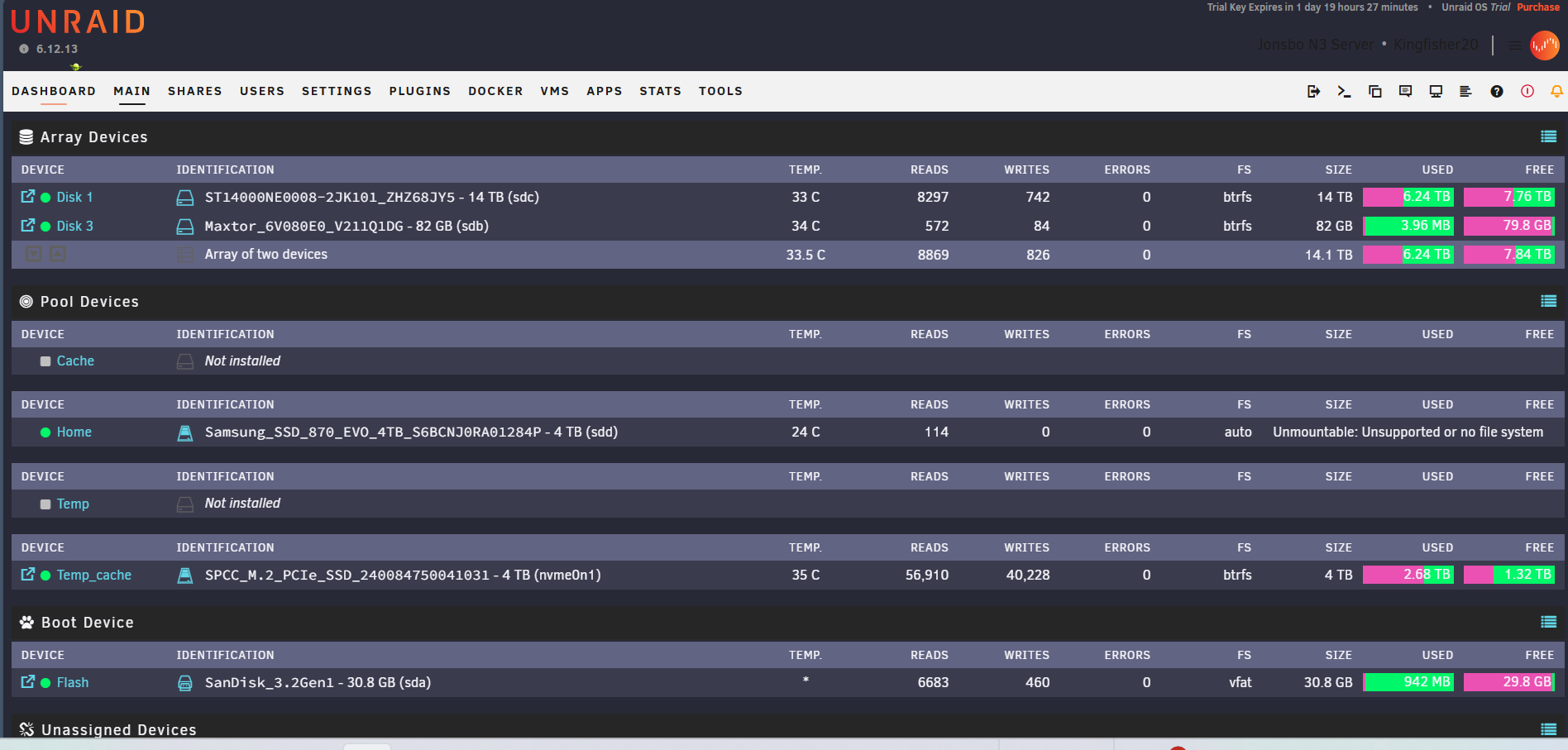

I need help to recover my disk. Hopefully my data are not lost.
I had 4 disks in my Unraid PC with no parity:
2 x spin disks on the array called Disk 1 and 3 (btrfs).
1 x SSD Pool device called Home (zfs before)
1 x SSD Pool device called Temp-cache (btrfs)
I wanted to add 3 more devices:
1 x spin as Disk 2
1 x SSD as another temp disk for parity device for one of the SSD Pool (for later on for Unraid 7)
1 x SSD as a normal disk.
I have put all the disks in and assigned them without New Config. Probably a mistake here. But I have added one of the disk in my Home Pool (mistake here as well), one as Disk 2 and another as Temp-cache.
I then clicked on start and found out the 1st Home disk was in the list of disks to reformat (so 4 disks to reformat instead of the 3 new ones). So I have stopped the operation imediatly and restarted the PC. Unfortunately it wouldn't start as the WebGUI wouldn't come up. So I have remove all the disk except Disk 1 and 2. I was then able to get back to the WebGUI and went to New Config to try to fix it. Afterward, I couldn't see any data in the user's home in that Home device after. I must say that there is a smart error in that Home disk which I was hoping to sort out a bit later on.
Is it a problem which can be fixed? Would I be able to recover the shares in my Home disk?
I have forgotten to download the diagnostic file before rebooting. But I have done so after rebooting with the present errors.

Here is a picture.
