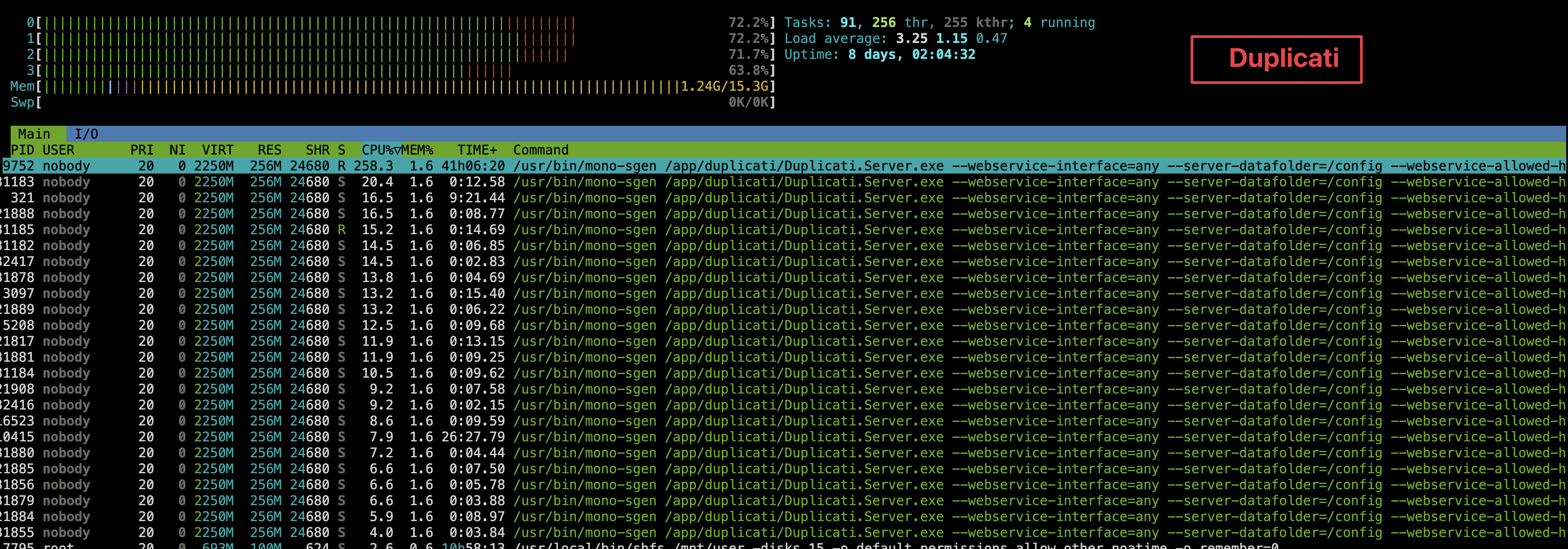

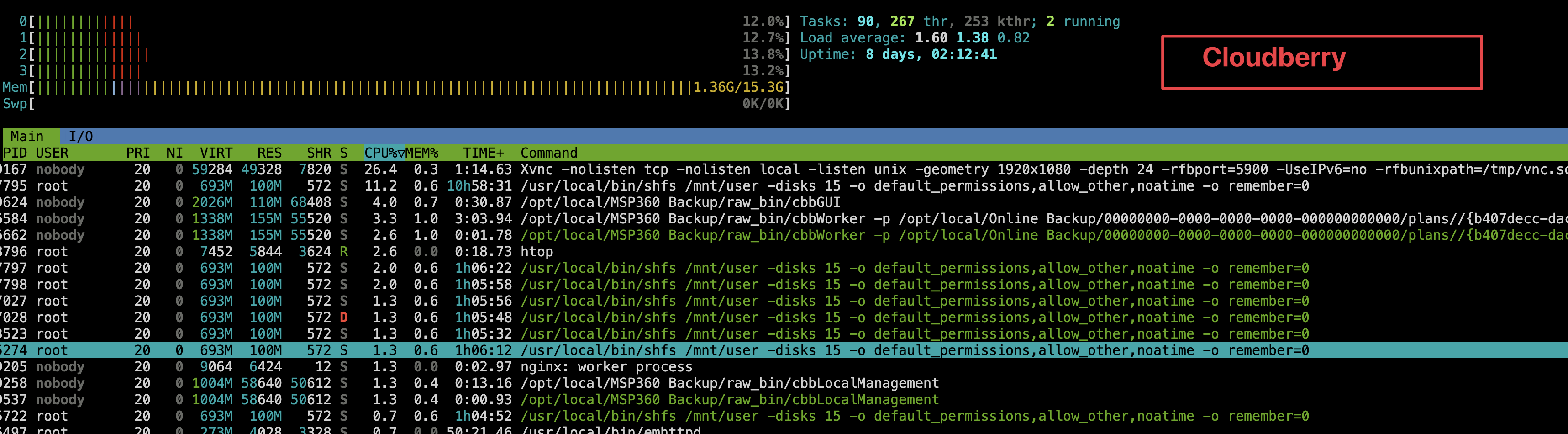

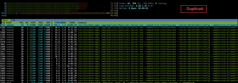

So, I set up two backup scenarios of the same folder with AES256 encryption - one using Duplicati and one using Cloudberry (now MSP360) and monitored in htop. Both have a bucket on Backblaze B2 as the destination.
There's a definite difference in CPU usage.
