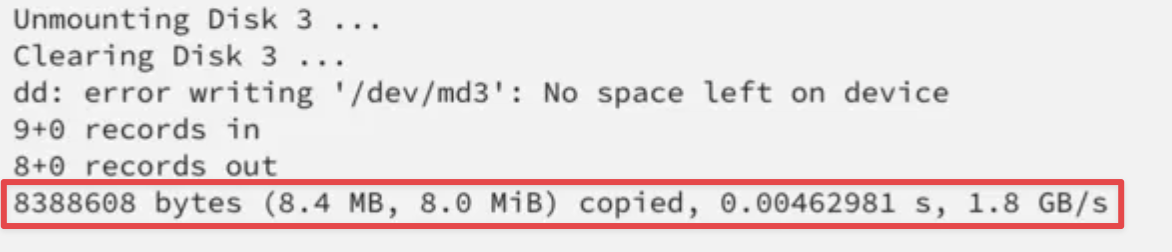

  11. Wanted to wrap this up, so here goes. 1. I never managed to get the script for method 2 to complete. So while it seemed a good way, either I was doing something wrong that made the script complete prematurely and without any errors in log or it is not mature enough for general use? 2. After considering that I had enough backup and safety net, I ended up doing what I stated in option B (see quote below) and then weathered the parity rebuild time and the (slightly) higher exposure to risk. Everything went well 🙂

  13. @bmartino1 Before the clear, the drive had approx 500GB on it, which was written over the last couple of months after a preclear. Data was moved away, the drive was reformatted (stop array, swap to XFS encrypted, start array and wait for format. Then the same, swapping back to XFS) Then created the 'clear-me' folder and that was it.
  14. Unsure what you mean by "I wnat to know how much space was written to it." - if you mean as a result of running the script: I'm not concerned per se, I just want to make the right choice to proceed and not botch things and make more work for myself than necessary :-)
