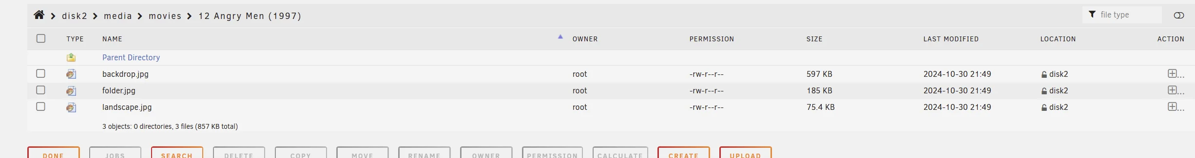

Missing files: All drives show significantly decreased used storage. For all my movie files, the video file is missing, but the images (.jpg, .png art) are still intact. The video files are not shown when browsing with smb form windows or unraid GUI

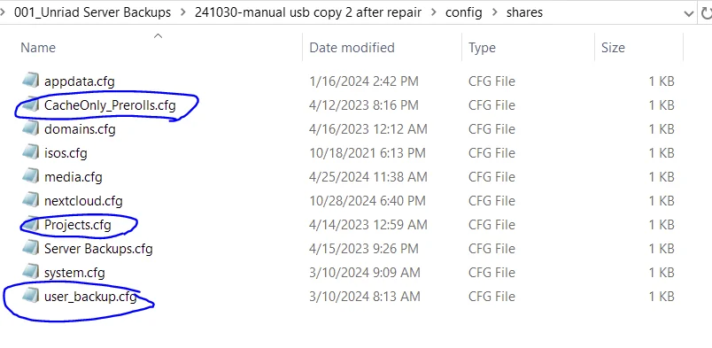

Missing shares: Seems random, have a recently created nextcloud share, but not other older ones. Missing shares "Projects" for instance are listed in the config folder in my usb backup.

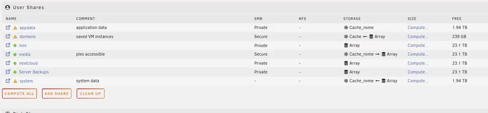

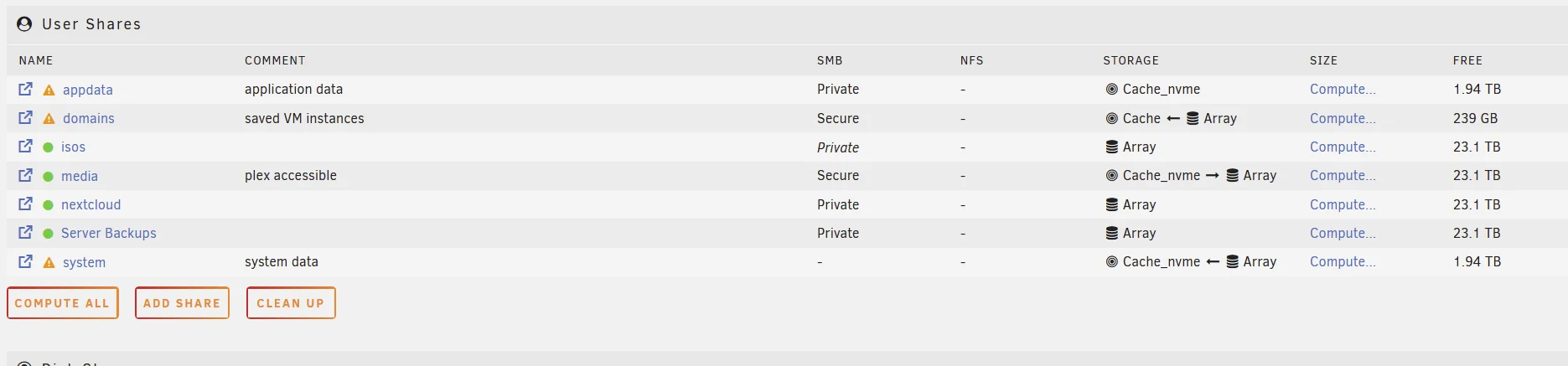

Additionally, how do I deal with the missing shares? Diagnosis shows the following on shareDisks.txt:
appdata                           shareUseCache="only"    # Share exists on cache_nvme
C----------------s                shareUseCache="yes"     # Share does not exist
domains                           shareUseCache="prefer"  # Share exists on cache
isos                              shareUseCache="no"      # Share exists on disk1
m---a                             shareUseCache="yes"     # Share exists on disk1, disk2, disk3
n-------d                         shareUseCache="no"      # Share exists on disk2, disk3
P------s                          shareUseCache="yes"     # Share does not exist
S------------s                    shareUseCache="no"      # Share exists on disk3
system                            shareUseCache="prefer"  # Share exists on cache_nvme
u---------p                       shareUseCache="no"      # Share does not exist
