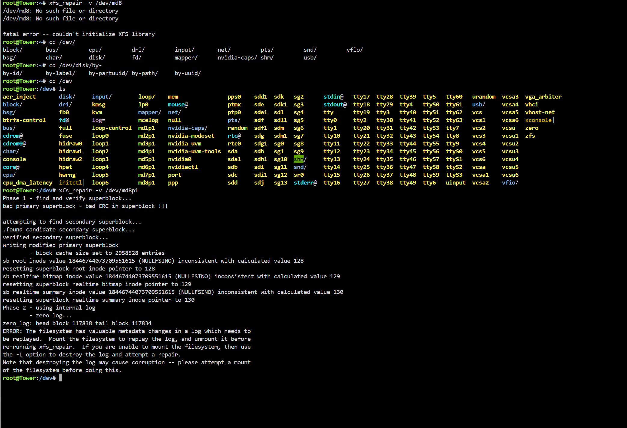

I cannot find it on disk8
You need to rerun adding the -L option.
Ok got an error
Phase 6 - check inode connectivity...
reinitializing root directory
reinitializing realtime bitmap inode
reinitializing realtime summary inode
        - resetting contents of realtime bitmap and summary inodes
        - traversing filesystem ...
bad hash table for directory inode 1835471 (no data entry): rebuilding
rebuilding directory inode 1835471
bad hash table for directory inode 52330859 (no data entry): rebuilding
rebuilding directory inode 52330859
entry ".." in directory inode 2232701676 points to free inode 139
bad hash table for directory inode 2232701676 (no data entry): rebuilding
rebuilding directory inode 2232701676
bad hash table for directory inode 4294967424 (no data entry): rebuilding
rebuilding directory inode 4294967424
Metadata corruption detected at 0x46fa05, inode 0x100000083 dinode
fatal error -- couldn't map inode 4294967427, err = 117
root@Tower:/dev#
Edited by sibetron
Try again, but that doesn't look good, if xfs_repair cannot repair the filesystem, only option is using a file recovery app like UFS explorer.
xfs_repair didn't work. I guess the data is lost forever. Thank you for your assistance

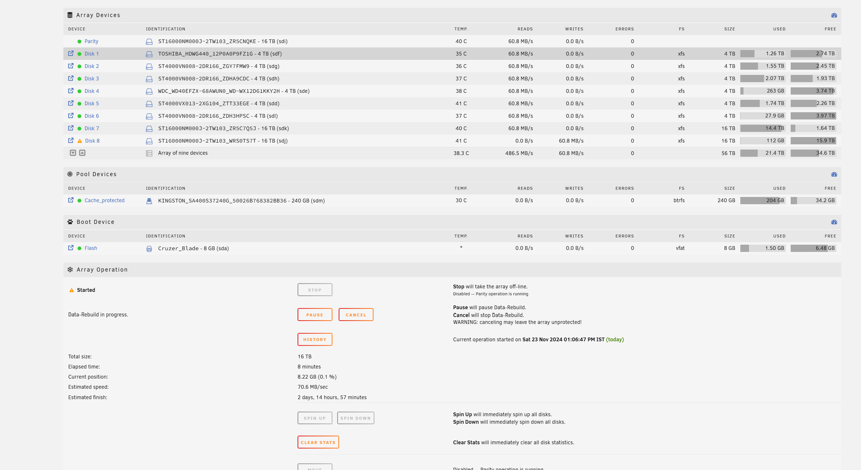

I copied the necessary files from disk8 using ufs explorer. Now, when i add the disk to the array , its rebuilding the disk8 with empty filesystem. Should i continue with the data rebuild ? or is there any other option to add the drive to the array without it .
tower-diagnostics-20241123-1309.zip
Edited by sibetron
You could do a new config and resync parity, but it will take about the same time, so if the rebuild is already going, just let it finish.
