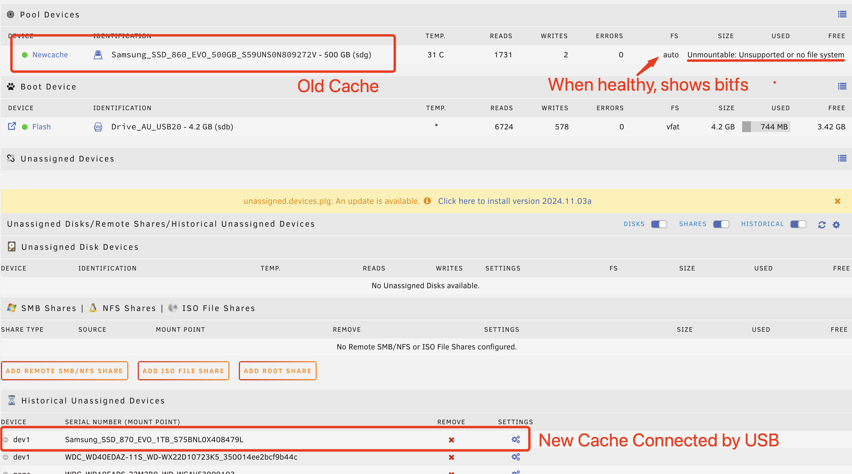

I am trying to replace my cache drive (btrfs). My chassis is somewhat dated and all my PCI slots are taken. Giving this a shot, I disconnected the parity drive and connected the new cache drive, which was not yet formatted.  I added the new drive to the cache pool, but I did not see a way to format it.
So I shut down the machine, removed the new cache drive and reconnected the parity drive. Changed the cache pool size back to 1. Started the array, and parity re-ran automatically.

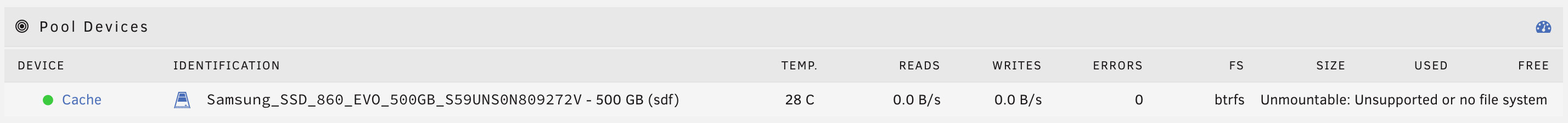

However the cache drive now shows "Unmountable: Unsupported or no file system"
The cache drive contains a few VMs which are not mirrored to the array, so I want to be careful that I don't lose its contents.

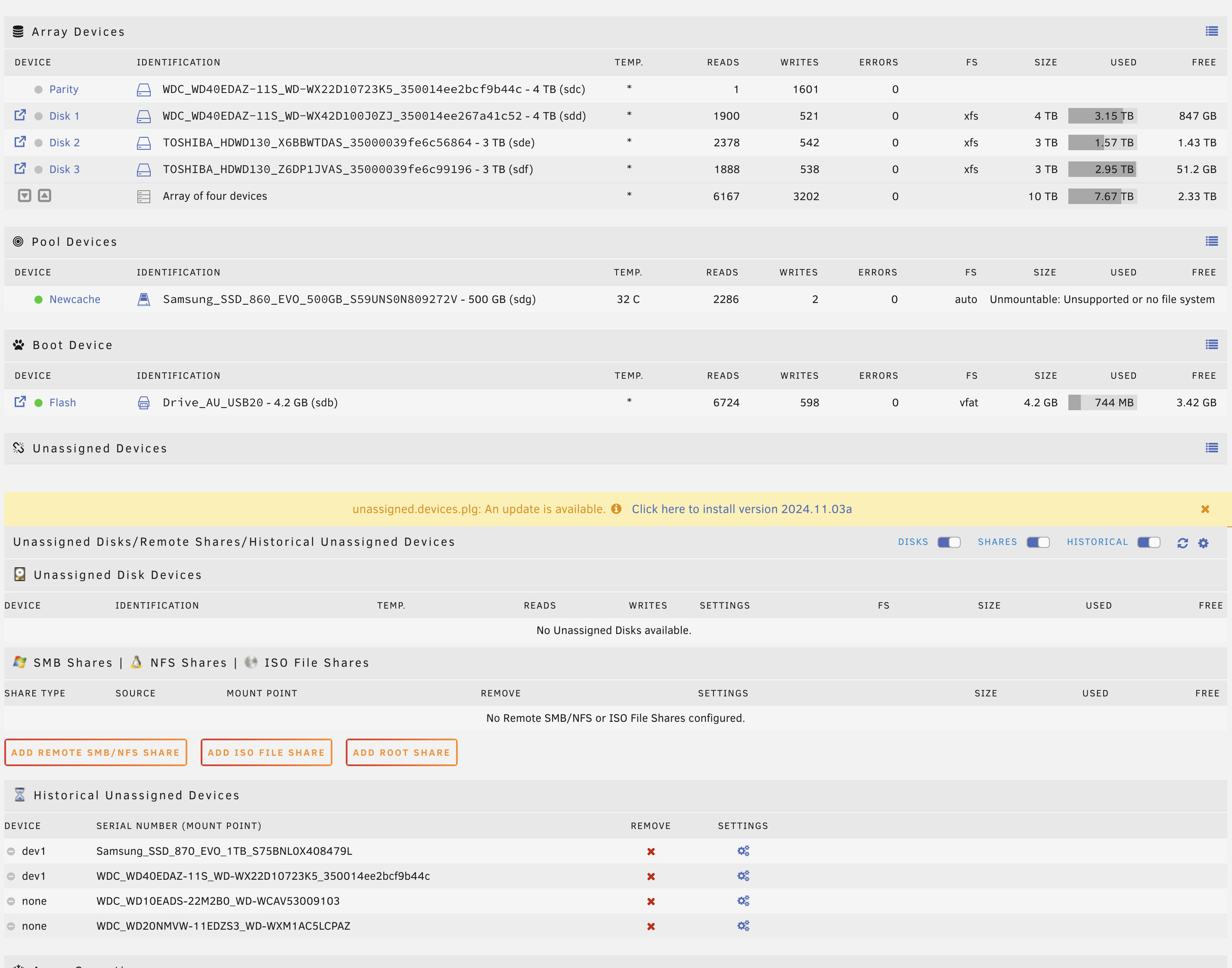

The first thing I did was connect the new drive via PCI, expand the cache to 2 devices, and add the new one alongside the old one. (In doing so, I disconnected the parity drive because I needed the PCI slot.)
The system recognized the new drive in the pool, but did not format it, and nothing was written to it.  So I removed the new drive, reconnected the parity drive, and shrunk the cache back to 1. This resulted in the old cache giving the "Unmountable: Unsupported or no file system" error as shown in my screenshot. Trying to get the system to mount the cache drive, I created a new pool with the old drive only (with a new name, "newcache") and removed the original cache pool.
Currently, the new drive is attached via USB and shows in historical unassigned devices.
If it only shows up on historical devices it's not currently attached, attached it and post the btrfs fi show output again, but note that some USB bridges are not transparent, ideally it would be connected to a SATA port.

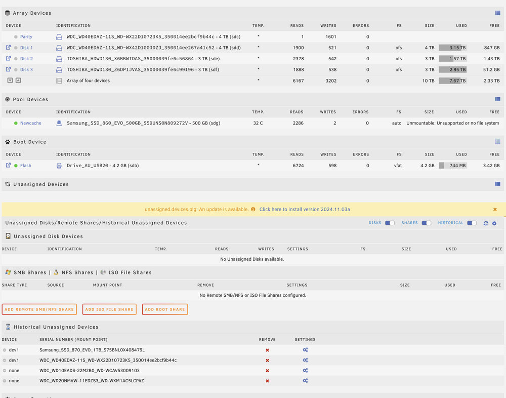

I don't intend to run the cache off USB, I'm going to replace the 500gb drive in sdg. I had the new one in USB to see if I could try to format it. I've removed it and re-ran the commands:

The other SSD is still not connected.
