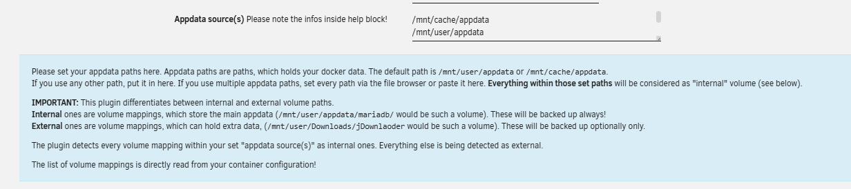

if i change my appdata from /mnt/user/appdata/xxxx to /mnt/cache_nvme/appdata/xxxxx do i have to go manually through each container and change the path? Because i getting this on the appdata backup and restore, [04.11.2024 17:39:36][⚠️][ xxxxx does not have any volume to back up! Skipping. Please consider ignoring this container.
you have to add the additional paths to the app data plugin.

example of aditrional folder for appdata plugin to work for my needs:
/mnt/cache/appdata
/mnt/user/appdata
/mnt/user/Dockers
/mnt/vm-zfs/Dockers
/mnt/vm-zfs/Dockers/ClamAV
/mnt/vm-zfs/Dockers/FastAPI-DLS
/mnt/vm-zfs/Dockers/Grafana
/mnt/vm-zfs/Dockers/LocalAI
/mnt/vm-zfs/Dockers/MakeMKV
/mnt/vm-zfs/Dockers/MariaDB-Mysql
/mnt/vm-zfs/Dockers/netprobe_lite
/mnt/vm-zfs/Dockers/PBS
/mnt/vm-zfs/Dockers/PhotoPrism
/mnt/vm-zfs/Dockers/Plex
/mnt/vm-zfs/Dockers/SFTP

However, the warning you get, is telling me that you are just done doing so? Because it seems to use the new path but you did not entered it as „allowed appdata sources“.
or maybe you did changed the setting but the containers. Would lead to the same message.
