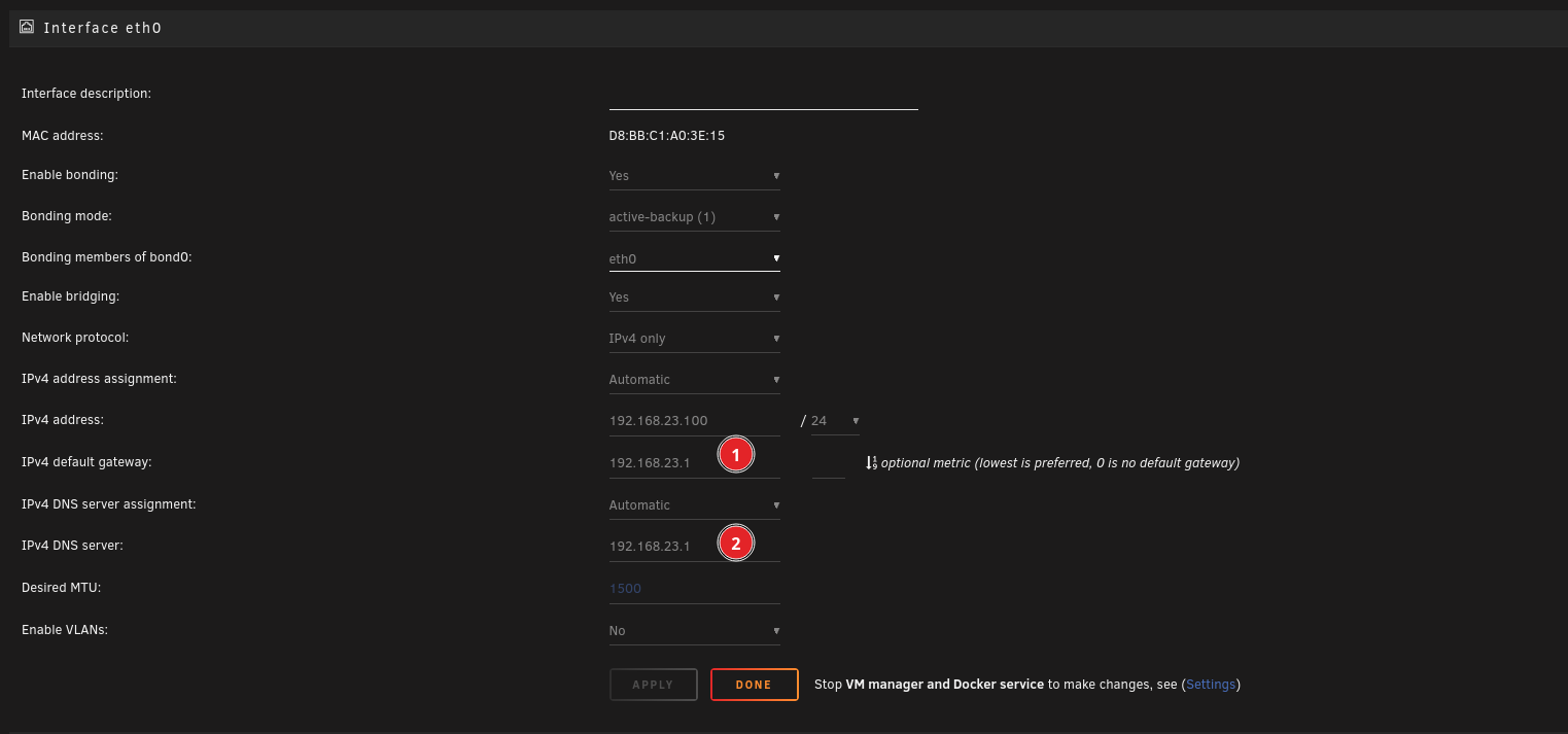

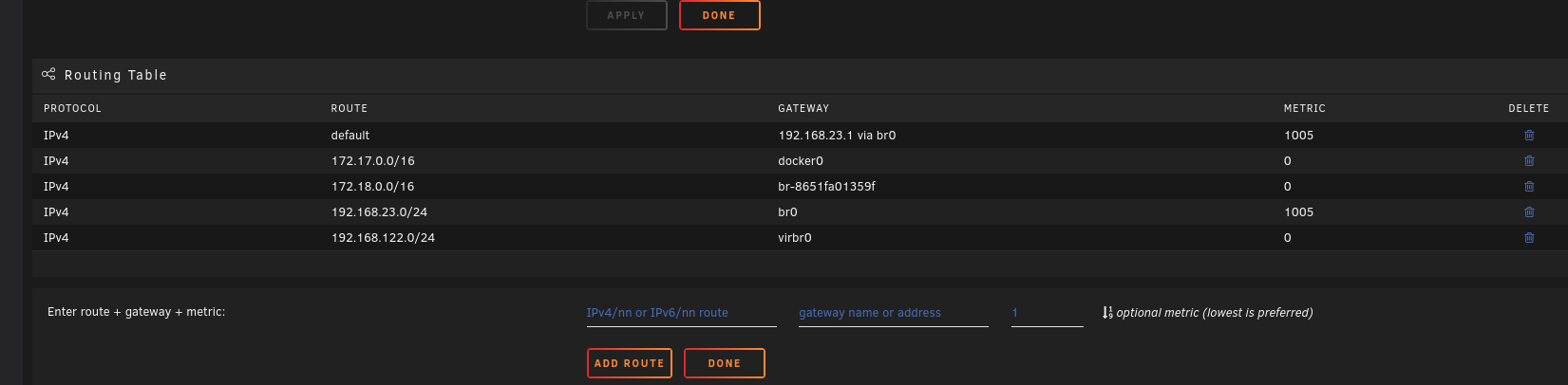

My network has got messed up and Unraid has lost access to internet and my custom network is showing.
I have tried a restore of backup setting to Restore backup config but does not seem to take effect.
I didnt know if i had to reboot Unraid to make changes plus didnt want to lose total access to it before i chaecked with you guys.
If you need and more files to help let me know i was going to do a docker compose but not sure of what to put with it being network ?
My VM's have connection but all containers  have external internet access image.thumb.png.48dceb1b5e958cfbad77bad31558de62.png

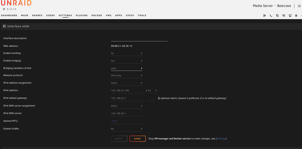

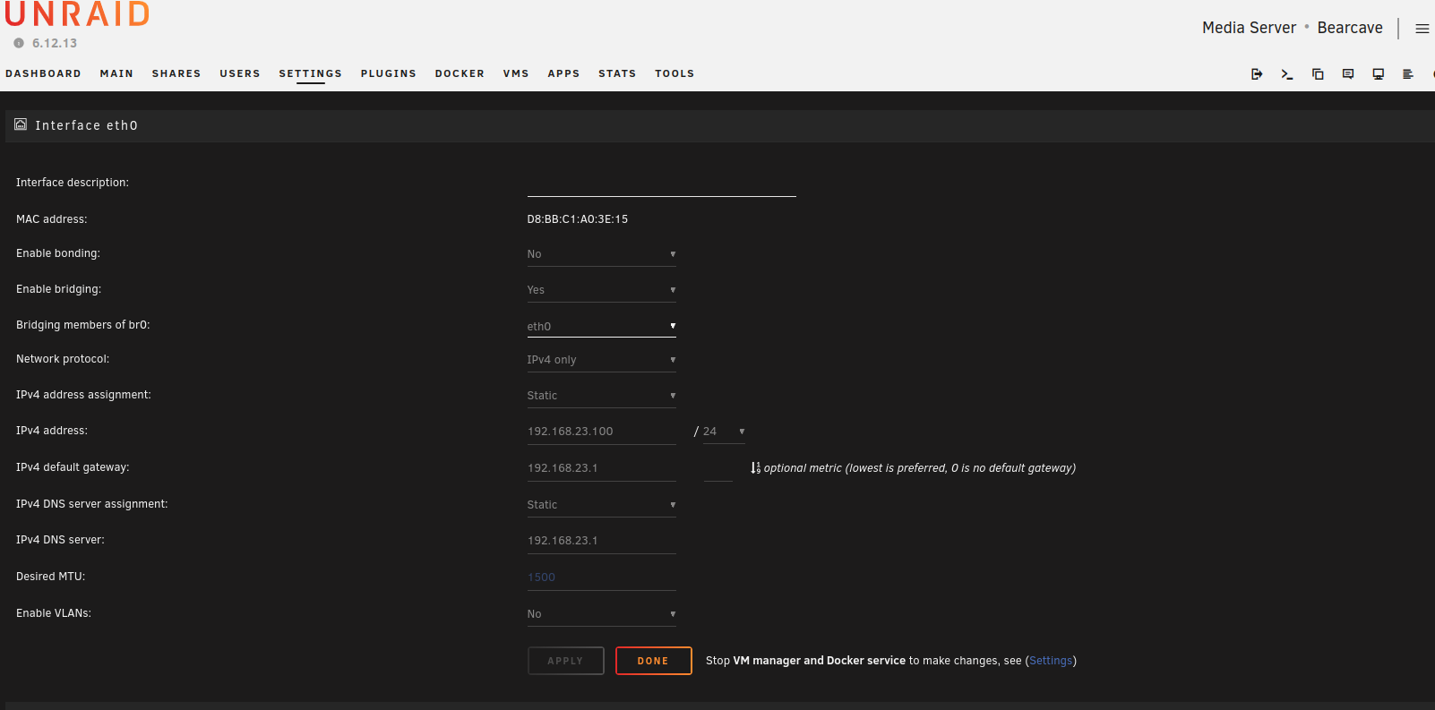

new image

OK i have tried buy same error plus my  custom network bearproxynet not being restored !
I thought restore config would add it back!
Also renaming network is still leaving old DNS settings  in main file
That's normal, it uses DHCP, so it sets your router, and that should work, unless there's a network issue.

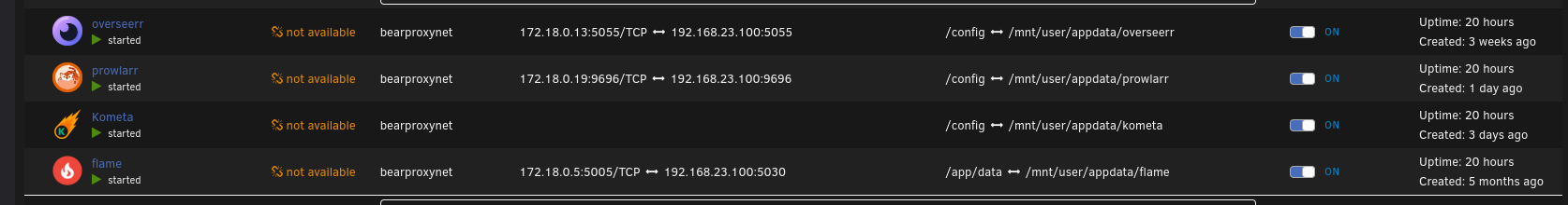

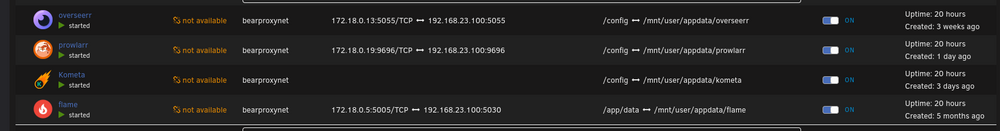

IT seems to be i have containers not able to talk on the custom network how can i track down what is stopping it ?
Would you know where daemon.json file is located i cannot find it i was looking in  /etc/docker/daemon.json but see no docker folder !
I have tried searching in terminal but get no result !

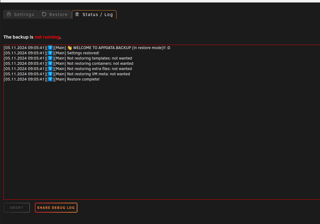

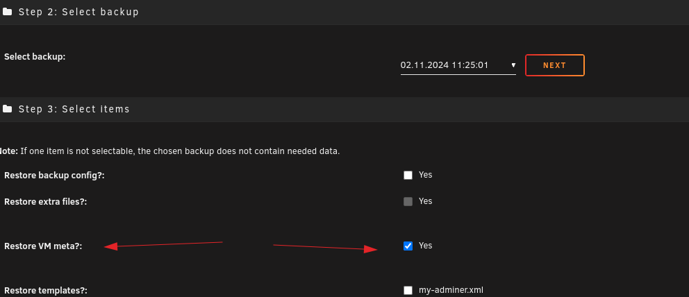

i have it working now but after a restart i have lost me VM's  which i really need  can i use this to fully restore them  ?
image.png.2e20a22881ac2d3aa9f75748e6ac9949.pngcan i restore them using this  ?
That's not stock, recommend asking in the support thread for that, I assume it's a plugin.
