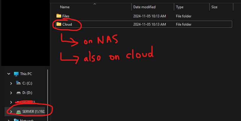

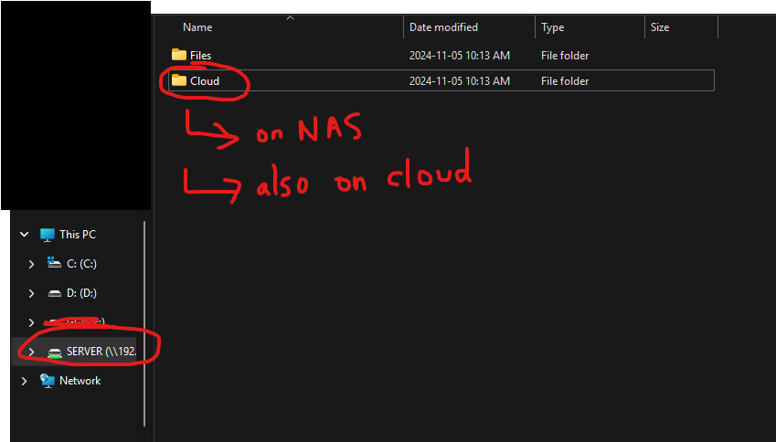

1) Have a folder ("Cloud") on unraid, that I can access through "Y:"
2) This "Cloud" folder = my rclone union. The files exist on my unraid + in my rclone union

So... is mounting the right course of action and shall I attempt to make it work? Will it?
Perhaps I should instead copy the rclone union's files onto my NAS, and then schedule a SYNC via userscripts to run each night?
Image attached = my (hopefully) user experience.

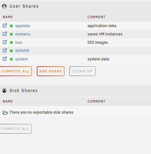

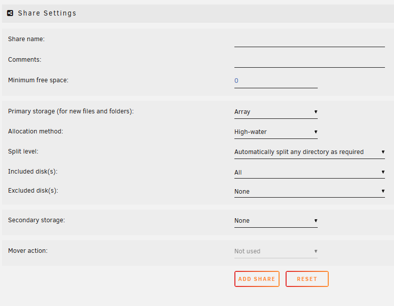

I can't see a field in the Share setup (see attached).
You will need to stop the array and add a share manual to SMB extra. since it not a standard share under /mnt/user
You can make a share beforehand and use that path for the mount. Since you have a mount directly to disk you will need to use samba smb conf option to add the disk share.

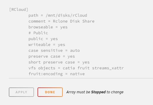

Unraid WebUi > Settings > SMB
SMB Extras
#example that should work:
[RCloud]
        path = /mnt/disks/rCloud
        comment = Rclone Disk Share
        browseable = yes
        # Public
        public = yes
        writeable = yes
        case sensitive = auto
        preserve case = yes
        short preserve case = yes
        vfs objects = catia fruit streams_xattr
        fruit:encoding = native
you can cat/etc/samba/sbm-shares.conf
to see your other shares...

I added the code to SMB extras and restarted the array. On the shares screen I still can't see the share.
You will never see the disk share in the share screen....
the share is now being shared via samba via the extra options... so if you go to you network share on unraid:
you will now see the Rcloud share.

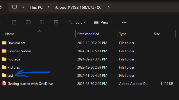

Okay, maybe I jumped the gun. It can only be read from my Win11 PC, but I can't modify.
I used the cmd (in unraid) to see if I could write from there, and it works. The copy command created a file in thedrive: which is reflected in the rCloud folder:

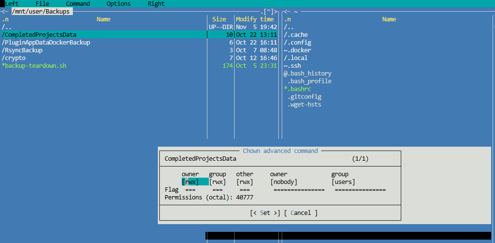

this is where I would open mc terminal and confirm who owns what. As I can't seem to remember/ forget the command to grab that data...
so type mc go to the folder.
file > advance crown
Example
as you can see, completedProject is 777 read write execute and the owner nobody and group users can touch and use the files.
