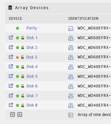

Device is disabled, contents emulated
Hi community,
I am facing a disk issue with Disk 3 since today.
What I already tried:
  • Reboot
  • Changed power cable port of the drive
  • Changed SATA cable of the drive
  • SMART short self-test -> Completed without error
Drive is spinning up after it gets power.
I am running a system with 2 LSI cards where HDD Array drives are connected via SAS->SATA cables.
SSDs are connected to SATA ports of the mainboard.
Diagnostics attached.
Many thanks in avdance
Jules
tower-diagnostics-20241107-2032.zip
Solved by itimpi
Once a drive has been disabled (as indicated by the red ‘x’) this will be because a write to it failed so Unraid will start ‘emulating’ it.   You need to rebuild the drive to clear this status.    According to the diagnostics it looks like the emulated disk is mounting fine so you can  Rebuild the drive to itself.
Thanks for your fast answer.
Rebuild is running, I will report if it worked.
It worked!
Many thanks
