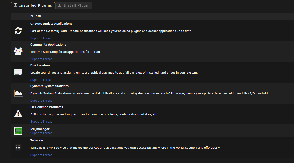

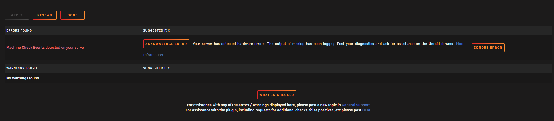

I'm a home user moving from QNAP and just setting up my TVS-871 to run unraid.  I have everything set up to start adding some data, so far so good, except when running the Fix Common Problems plugin I get a hardware error.  My SMART checks all show "completed without error" so I'm hoping it's not a hardware issue with the device as I purchased it used.  The error message suggests I share my logs here. See the attached screenshot of the error, screenshot of my installed plugins, and the attached logs.

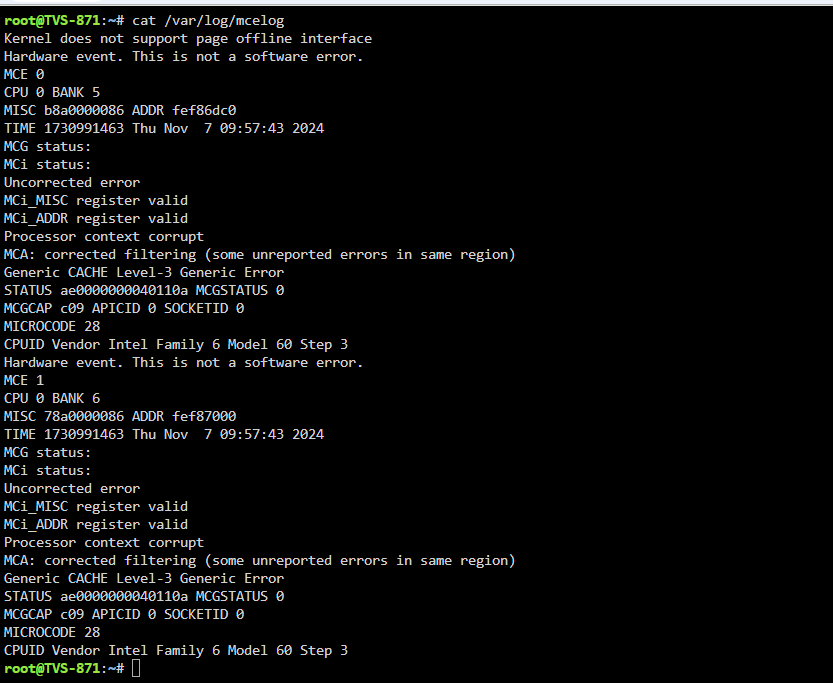

The errors that Fix Common Problems reports are also visible in the log, so the plugin reports them, but you don't need the plugin for it.
As to the errors, Machine check events are events that are reported by the processor. It puts them in a file which you can view by using the terminal or use ssh (if enabled) to the server and type something like
cat /var/log/mcelog
I'm not sure what would show up though, since my machines don't report any errors, and so the file is empty.
If the file doesn't tell you what you need, you can use mcelog to decode it. Again, no idea what it will show. If you do want us to see it, you can dump it in the system log with
mcelog --syslog
and then re-run diagnostics and upload those.

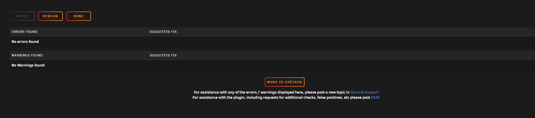

I have since done a shutdown and restart, and now the error is gone.  Could it have been a random one off?
When I posted about this type of issue, I was told to just monitor if more occurred. So far I've only had one on my system.
Thank you
