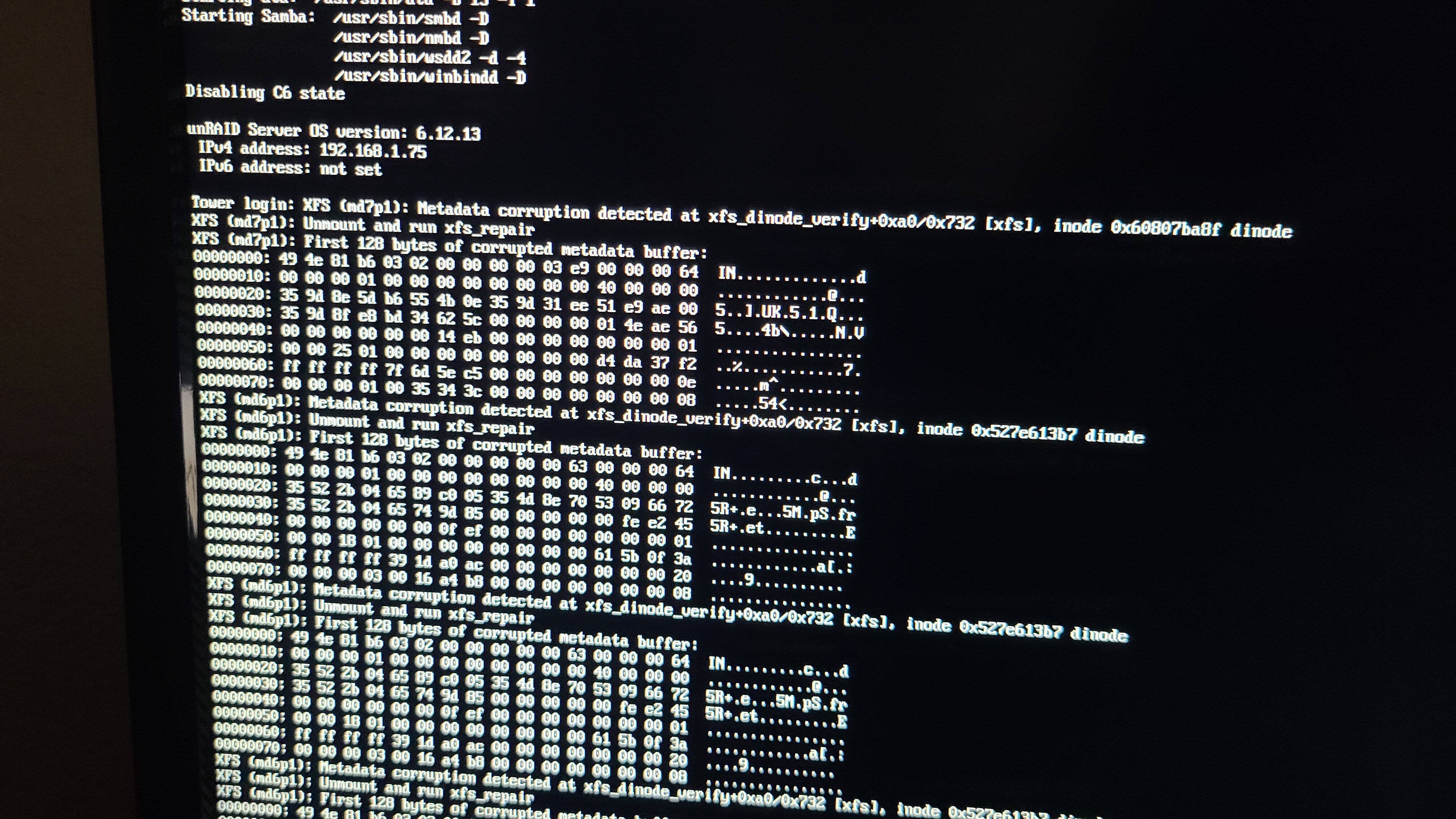

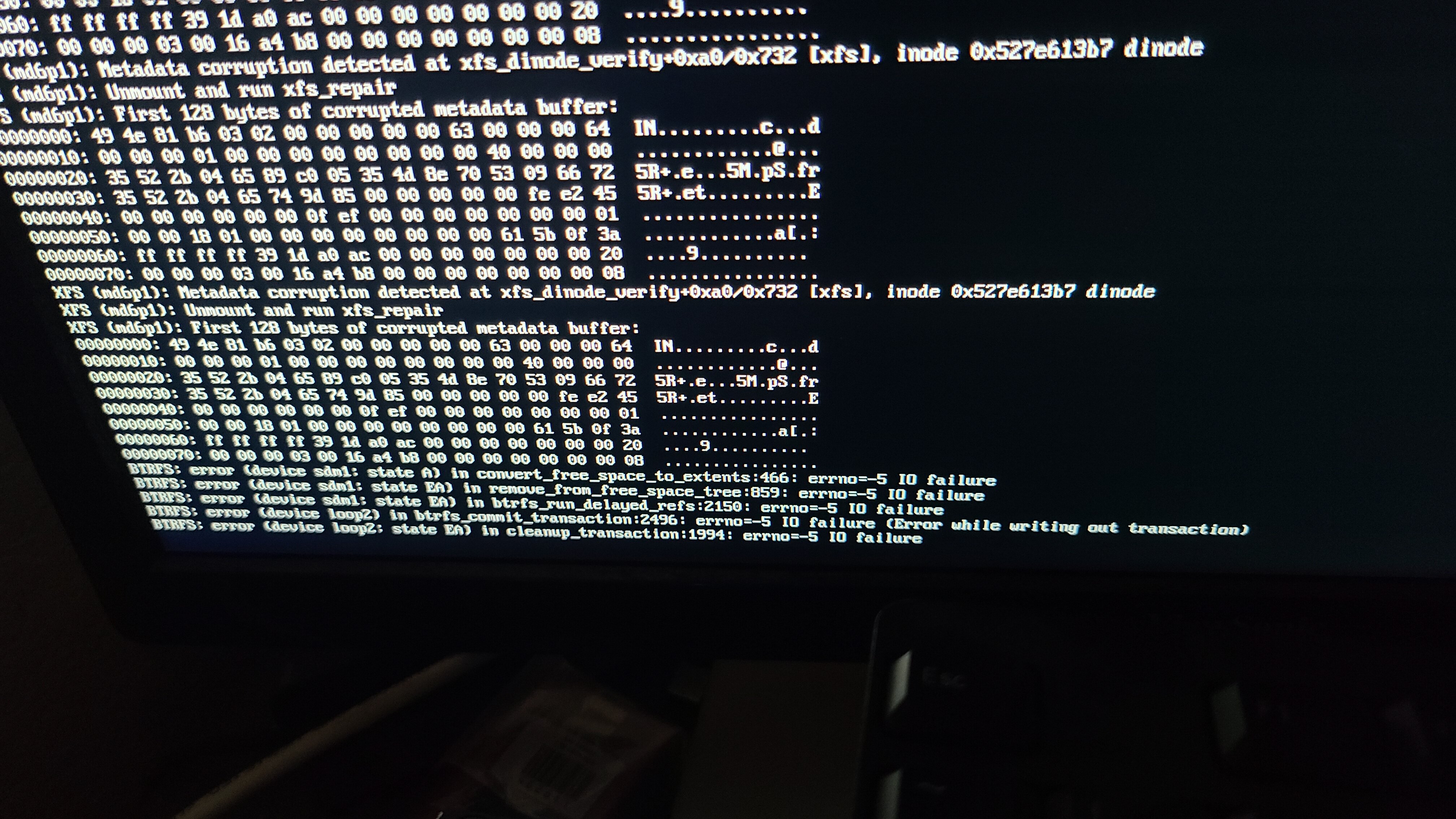

I looked the monitor that's plugged into my server and saw this error that I might have missed in the syslog.syllogism.
How do I do a xfs repair without losing data? Is this on individual drives or the entire system?

Disk6 also has filesystem issues, check filesystem, also a good idea to run memtest.
