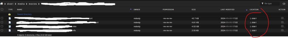

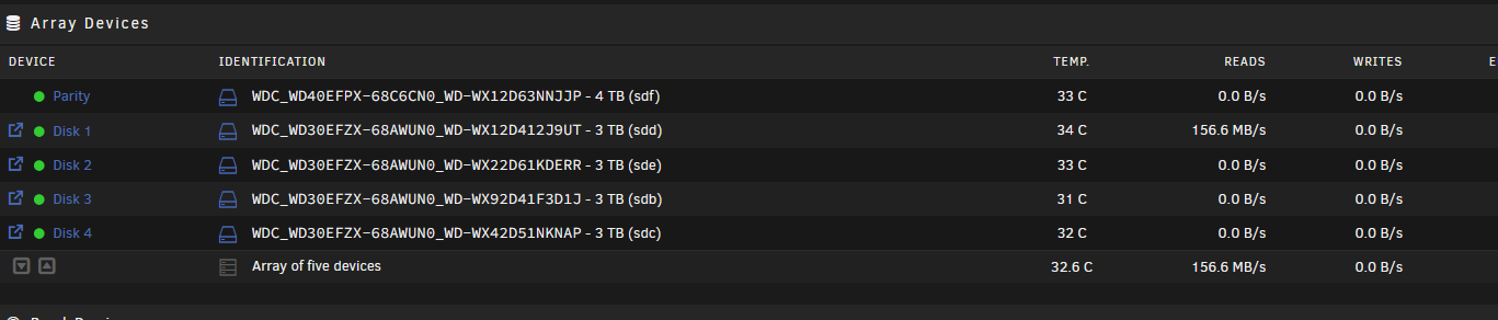

I have a file on disk 1:
but when reading it (VLC) the disk 1 is not spin up, but the file is somehow reading from cache drive1.thumb.png.7eae64af3054e03bb4c35cc7caf95805.png
How is this even possible?
When browsing cache drive can't find this file

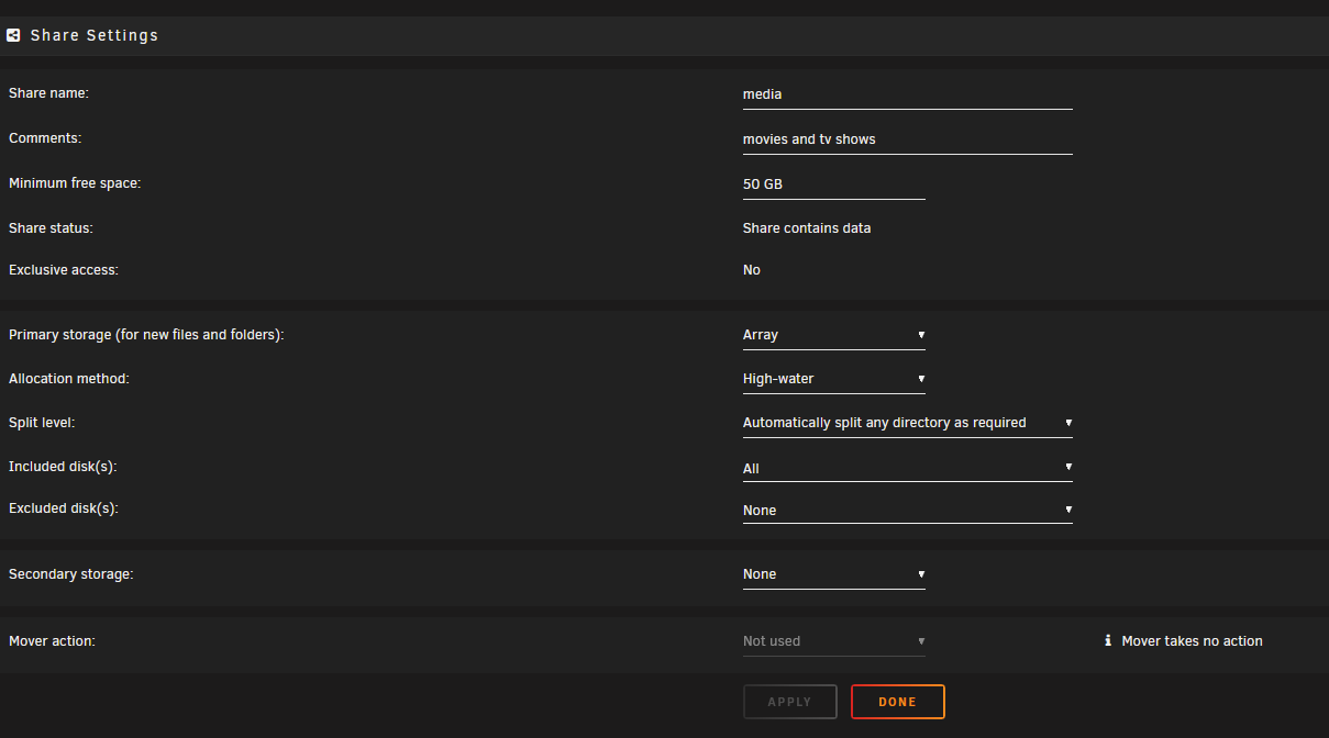

Everything looks fine in the media folder settings:

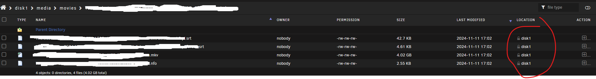

also, file browser shows this file is on disk 1 only:
weird...

The Media folder is on Array (file is on disk 1) as expected:
Sorry I meant media, if that share only exists on the array, it must be read from the array, unless you have a container/plugin/script caching it.

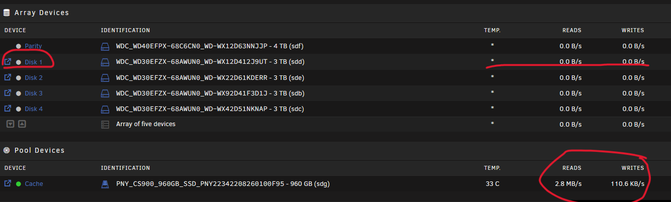

I don't have any caching script/plugin and still, the file is reading from the cache (at least the dashboard is showing reading/writing on cache drive when accessing this file) meanwhile disk 1 where the file is placing is sleeping.
That is really weird because when I open other files, data disk is spins up correctly.
File activity plugin shows correct disk:
But the disk 1 is spin down :D
And the Main tab is showing activity on the Cache drive when accessing this file. My God...

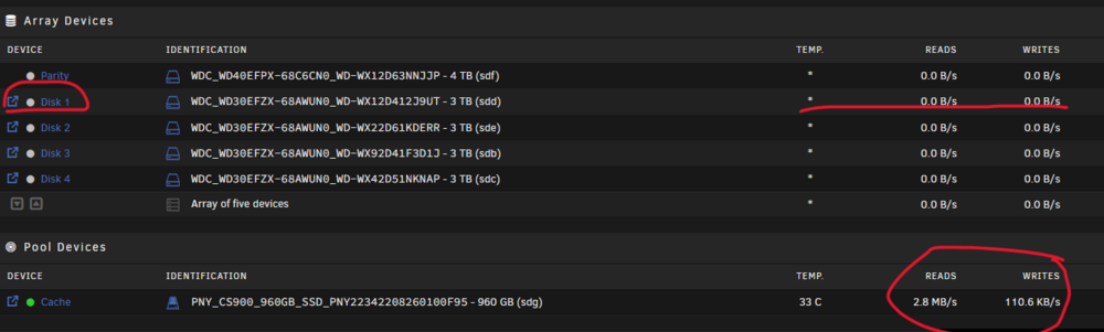

1. Array restarted, run pv command, first run, disk 1 spin up and the file is accessed from disk 1:
2. second run reading from the cache drive
You can see the difference in speed when running command pv for the second time because the cache drive is reading.
From now every time I access the file it is accessible from the cache drive, WTF...
It seems somehow the file is caching in the cache drive, but again, I don't use any plugin/script for caching...
