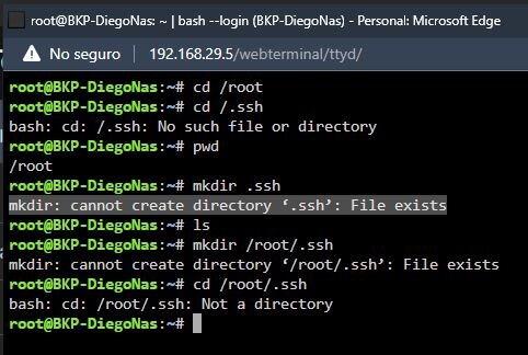

I can not access via command line to the folder /root/.ssh of my server
If I access as root and try to cd /root/.ssh says "bash: cd: /root/.ssh: Not a directory"
If I try to create a folder .ssh inside /root it says "mkdir: cannot create directory ‘.ssh’: File exists"

/root/.ssh is a pointer to /boot/config/ssh/root/
