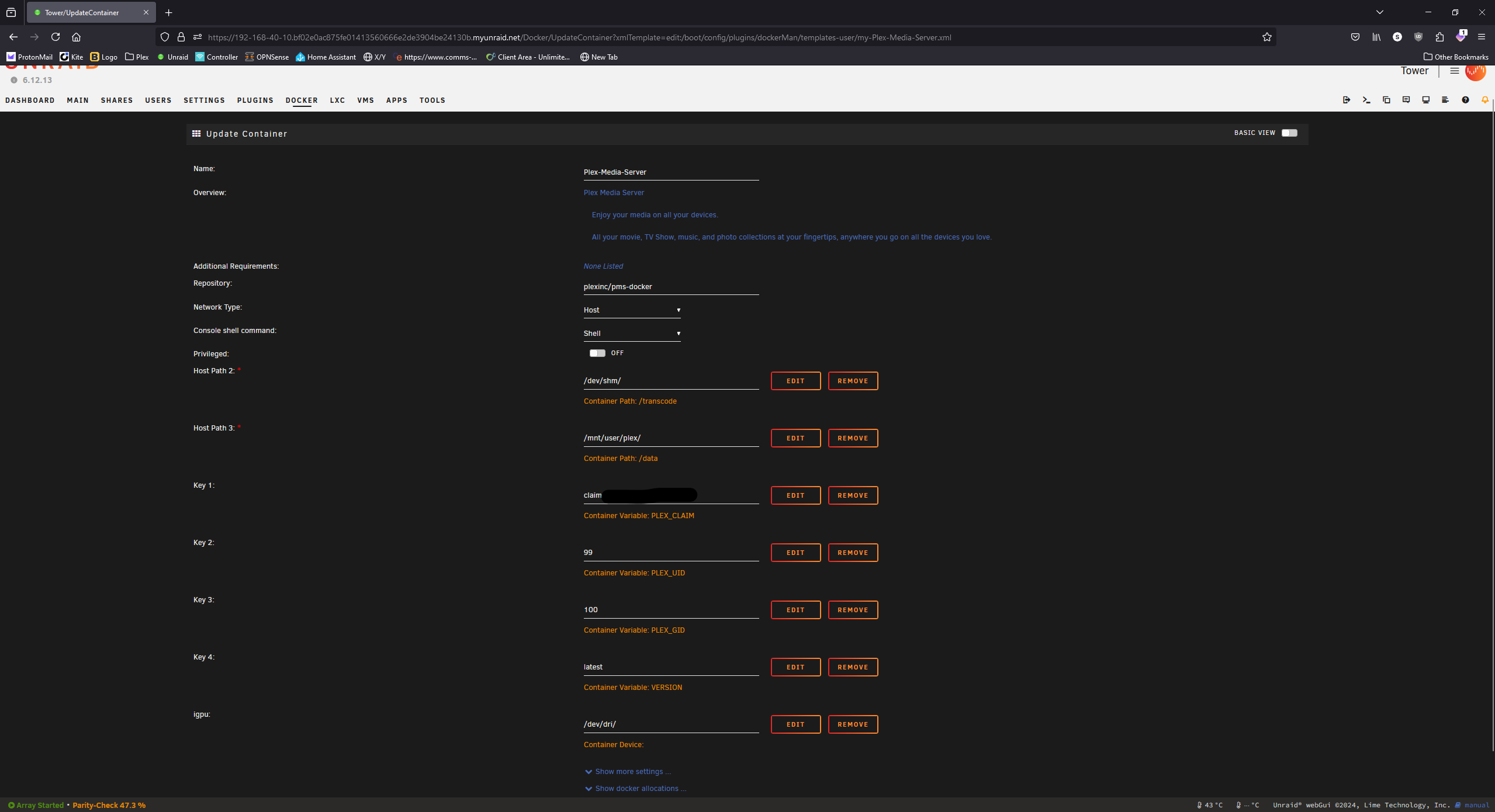

Anyway, I've attached a SS of the settings to see if there's anything of note there.
I am assuming that you have a share named  plex  under the SHARES tab.  (Capitalization is important as Linux is case-sensitive!)
Now at the bottom of that screenshot, look for these two dropdowns:
Let's see what settings are hidden there.
Edited by Frank1940
It's just my appdata config path which is /mnt/cache/appdata/Plex-Media-Server
As I mentioned, Plex works perfectly and everything functions as it should. All media works without issue. Until 1-1.5hrs when the entire Unraid crashes and becomes unusable.
I'm hoping someone can see something in the logs I posted which will explain why.
