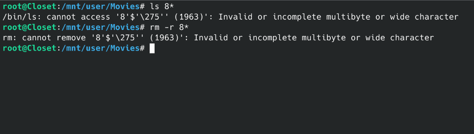

I have a folder on my Unraid server for the movie 8 1/2. Except I it's seemed to be named something strange because whenever I do anything to modify that folder through the terminal I get the error "Invalid or incomplete multibyte or wide character".
How can I delete this folder and all the contents?

This file is really stubborn. Or I'm really stupid.
First I tried solution 3, wildcards:
rm -rf 8*
deleted anything that started with an 8 and didn't give that same error but that file still seems to be there.

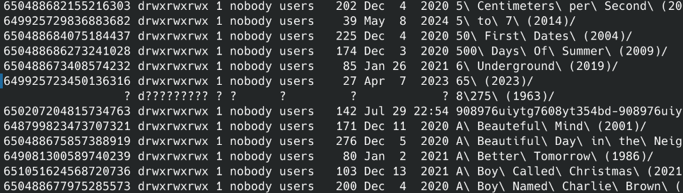

Second I tried solution 2, using the Inode Number:
But
-li | less
shows the file has no lnode number:

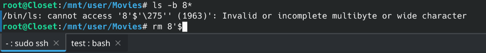

Option 1 I also tried but the escape commands as shown by
ls -b 8*
make it seem like the file doesn't exist.

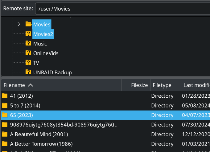

Your 5th recomendation (use mc)
 would that be midnight commander? I've tried to delete it with FileZilla which seems to be somewhat similar. But this method shows the file isn't there at all:

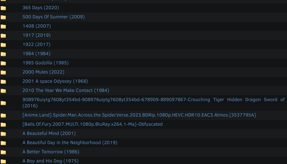

Since none of those worked I went to do a Filesystem Integrity check but the file doesn't seem to be on the share at all. Browsing the index through the Unraid GUI shows the file not there:
Any other suggestions or idea what I'm doing wrong?
