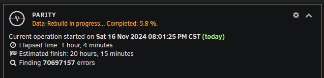

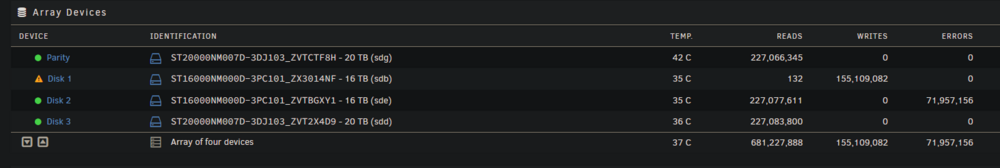

I canceled the extended self- test and have begun the data rebuild (in maintenance mode) and am getting errors. Is this an issue?
Edited by spiralout154
Cancel the rebuild, check/replace cables on disk2 and try again.
Just posting to confirm the solution for this issue. I believe the sata power cable I was using had too many daisy-chains and was not providing enough power to the drives that were getting errors. After doing some cable changes I was able to rebuild with no issues and then add my new drives.
