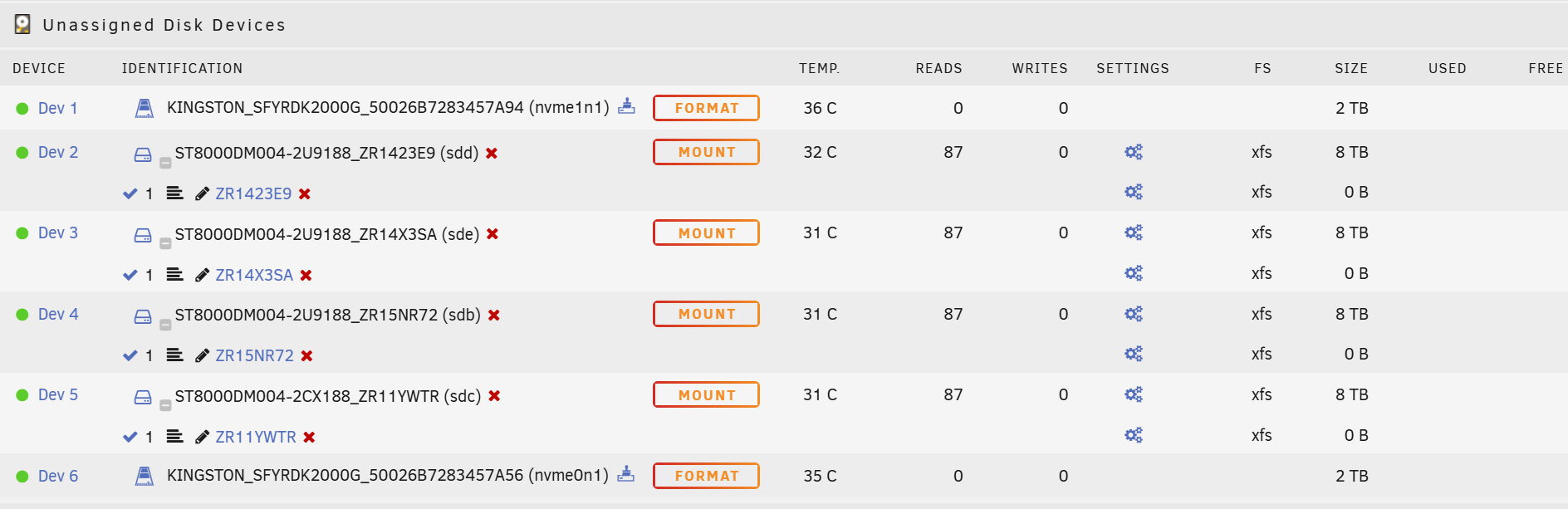

Thank you for the reply. How can I check what drive has a file system and what one does not?
The Unassigned Devices plugin should list you the drives with their respective filesystem on the main page
It looks like they all have file systems.
If you mount any disks you will have to rebuild parity.
Mhmm
You could check the smart data to see which disk has the highest amount of data written, if the parity drive has been in use for the same amount of time.

Don't see how all the HDDs are showing up as xfs in UD though.

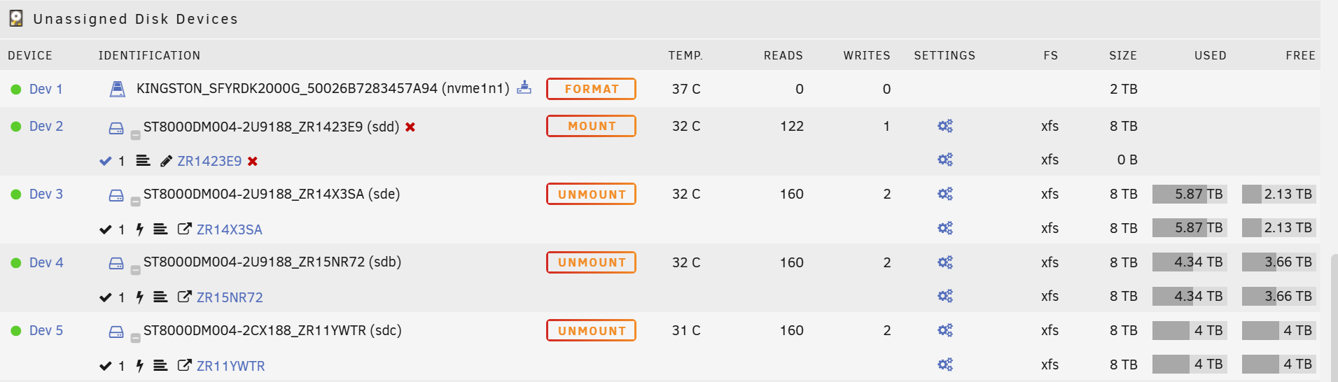

See if you can mount each of the HDDs readonly in UD and see what is on them.
Thanks! 3 mounted and one failed.
So I should be able to assign the failed to mount disk as parity and the other 3 in any array disk spot, correct?
I appreciate the help!
Correct, check parity is already valid, but run a correcting check.
It worked, thank you!
