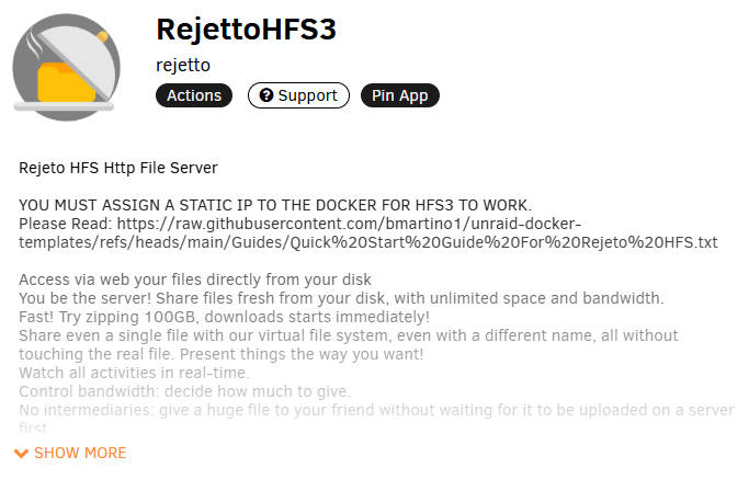

[SUPPORT] Rejetto HFS 3
Please read Setup notes:
https://raw.githubusercontent.com/bmartino1/unraid-docker-templates/refs/heads/main/Guides/Quick Start Guide For Rejeto HFS.txt
Support from the developer of hfs:
https://github.com/rejetto/hfs/discussions
Rejetto HFS
Access via web your files directly from your disk
You be the server! Share files fresh from your disk, with unlimited space and bandwidth.
Fast! Try zipping 100GB, downloads starts immediately!
Share even a single file with our virtual file system, even with a different name, all without touching the real file. Present things the way you want!
Watch all activities in real-time.
Control bandwidth: decide how much to give.
No intermediaries: give a huge file to your friend without waiting for it to be uploaded on a server first.
Intelligent: HFS tries to detect problems and suggest solutions.
Expandable: find the right plugin, or make you own.
Runs on Node.js has custom plugin support: https://github.com/rejetto/hfs/blob/main/dev-plugins.md
Edited by bmartino1
Currently working with Dev on some fixes to easily streamline the unraid setup, install and go process.
For the time being please follow the setup note
WIP Discusions:
Example: (self singed certs)
https://github.com/rejetto/hfs/discussions/801
VFS single docker line for a mount:
https://github.com/rejetto/hfs/discussions/792
Other information can be found in the wiki: https://github.com/rejetto/hfs/wiki
This app is still in Beta there are some growing pains...
Edited by bmartino1

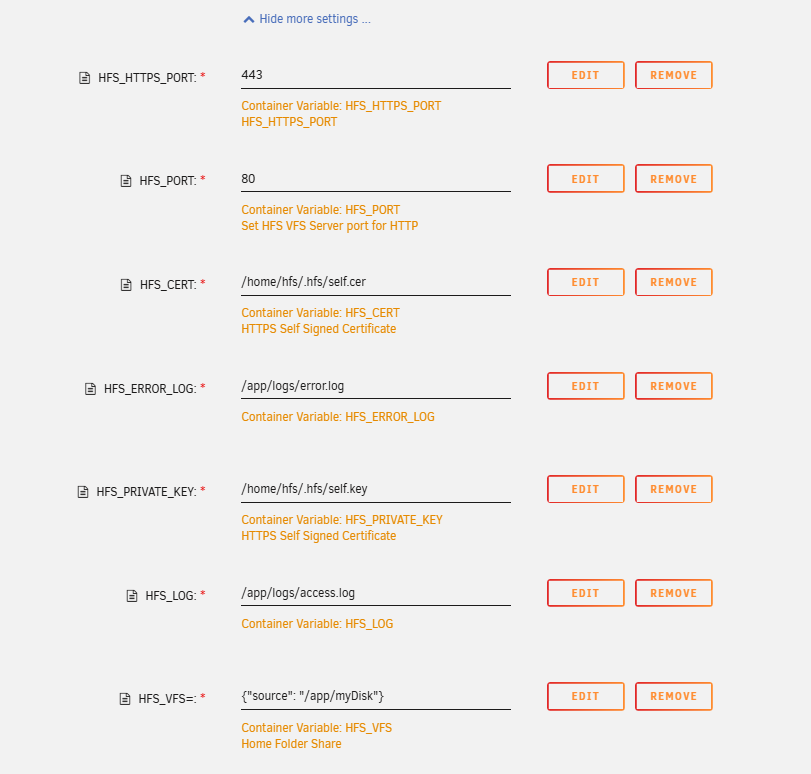

Hey,
Thanks for releasing the RejettoHFS3 Beta on UNRAID community app.
I want to access RejettoHFS3 with my own subdomain (hfs3.mysubdomain.com) using nginx proxy manager.
I dont want to upload HTTPS Certificate files or keys; I want NPM to take care of the certificates.
I have assigned a static ip (192.168.1.123) to RejettoHFS3 container and set HFS_FORCE_HTTPS: false.
Also set HFS_HTTPS_PORT:9443 and HFS_PORT: 9000 on the UNRAID Docker.
I can confirm I can access the HFS with http://192.168.1.123:9000/ but when I try to access over https with NPM and my subdomain, I get
502 Bade Gateway
openresty
error
In the HFS options menu below are my settings:
What am I doing wrong here?
All the other HFS instances on windows PCs are working with the same settings and NPM.
Any help would be appreciated!
Thanks again!!!
Dealing with ssl certs and sub domain can be a bit tricky.
My recommendation is make a self-signed cert and use the reverse proxy subdomain tie in to point to the hfs IP.
I'm not 100% familiar with NPM and node JS to assist here. My data on NPM is limited, I have used it in the past.
This may not be possible, and I recommend opening a discussion on Rejetto Github Discussion board for further support with reverse proxy and subdomain additions on HFS3.
Review previous topics
lets encrypt: https://github.com/rejetto/hfs/discussions/346
npm: https://github.com/rejetto/hfs/discussions/822
make a post:
*github account...
What I can say is in order to make this compatible with Unraid and to set up some things pre-defined in the config. I had to have some duplicate options.
*You may need to edit add variables to docker or remove them in favor of editing HFS config in the config folder for some settings...
You may need to change some of the default config options, as these will overwrite the hfs config at a docker reboot.
Review some of the other template options that are hidden:
*Advance Toggle > Show more settings.
As you can see, I have an HFS_cert option and HFS_Private_Key option. These may need to point to your custom folder.
By Default for use of a self-signed cert the default places the certs to be used in the config folder when created:
Example:
Since this is in Beta, But to use the certificate folder as I also made a custom path exist for some use case when using your own supplied certificate...
One would need to edit HFS_Cert and HFS_Private_Key to point to that within the docker. (or replace the certs in the config folder...)
To use a custom "lets encrypt" certificate. This can be done with in the docker by removing the advance hidden .key and .cer option and use the default values which point to where the certs would be when consoled inside the docker per the path folder created.
Example:
would be:
The key is fickle it must be .key format...
You can edit your key file as text and copy and paste the data and save the key as ###.key to fix a OpenSSL generated key
Edited by bmartino1
typo-data

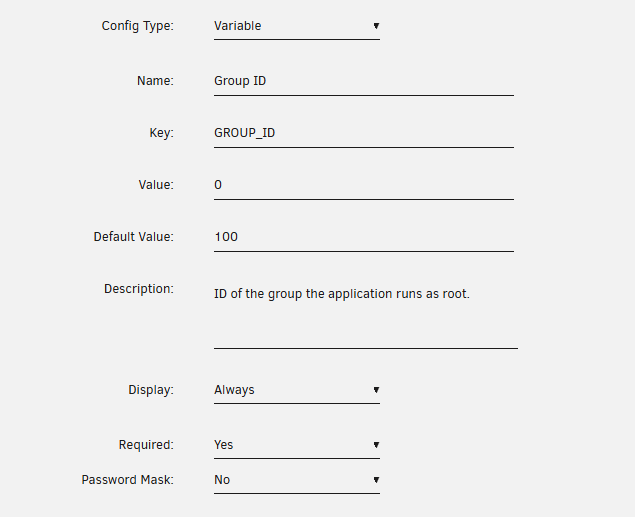

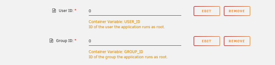

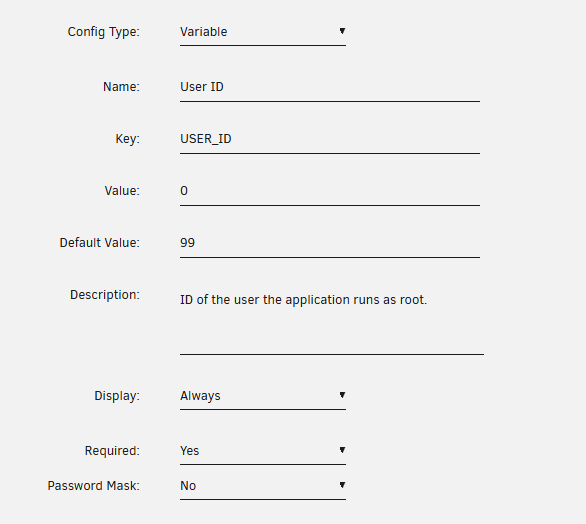

Hi and thanks for your effort: I did install the docker several months ago, but I was unable to solve a problem with folders permission (i had to set 777 to the one I'm sharing, as PUID PGID definition wasn't enough?).
Where you able to overcome this problem? If yes I don't mind to switch to your container.
I have not had any folder share issues and this sounds like a permission "owner" issues not a permission rwx issues.
chmod 777 -R *
chown nobody:users -R *
*I would advise you rerun docker safe permissions.
Unraid Web > tools > docker safe permission...
*Turn off docker to apply the permission correctly!
Otherwise its how you are telling the dockers PUID, PGID and UMASK
0 - root
99 - nobody
100 - users
you can add this to assist in file access... to help answer who touched what where.
PUID:
PGID:
Each docker is different in how it handles these variables...
Be sure that key is set to PUID, PGID and UMASK ...
Review/see more:
Anyways to help understand.
In rejetto hfs3 unriad template, I have this set to auto add this folder to the VFS as the main root file system:
So in my case /mnt/user/Users is my website root/home page and the folders/files are web accessible. I also don't have any issues with the default template, as it is written in the CA template. I can upload download etc but I do have 777 nobody:users set in that folder.
Please double-check your folder pathing and file permissions.
Edited by bmartino1
Data-tyoo
Thanks, That is more or less what I did. At least I have the confirmation that this is the right path to follow.
