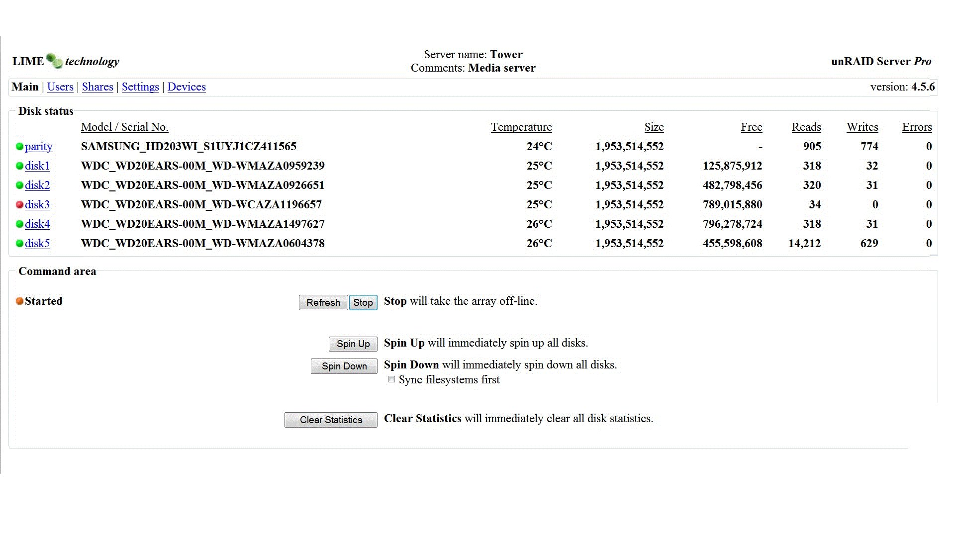

Hello,
A couple off days ago i noticed that a disk is showing up red. I believe it also showed errors. However when i look now it says 0. It still shows up red though. I've never had this before so i looked into the manuel, there it says: Red: the disk is disabled.
But i can still access the disk and files on that disk. I've attached a screenshot. Do i need to buy a new drive or what? All the drives are jumpered ears. I hope i don't have to buy a new drive because i see that the price of the disks are way higher than when i bought them.
Anyway can someone please tell me what to do.

But if it's ok then how come it's red in my unraid server?
It's red because a write to it failed. Replace with a pre-cleared spare and the pre-clear the fautly drive. Or rebuild the drive in place by starting the array with the disk unassigned and the restarting the array with the disk assigned. Run parity check after the rebuild.
