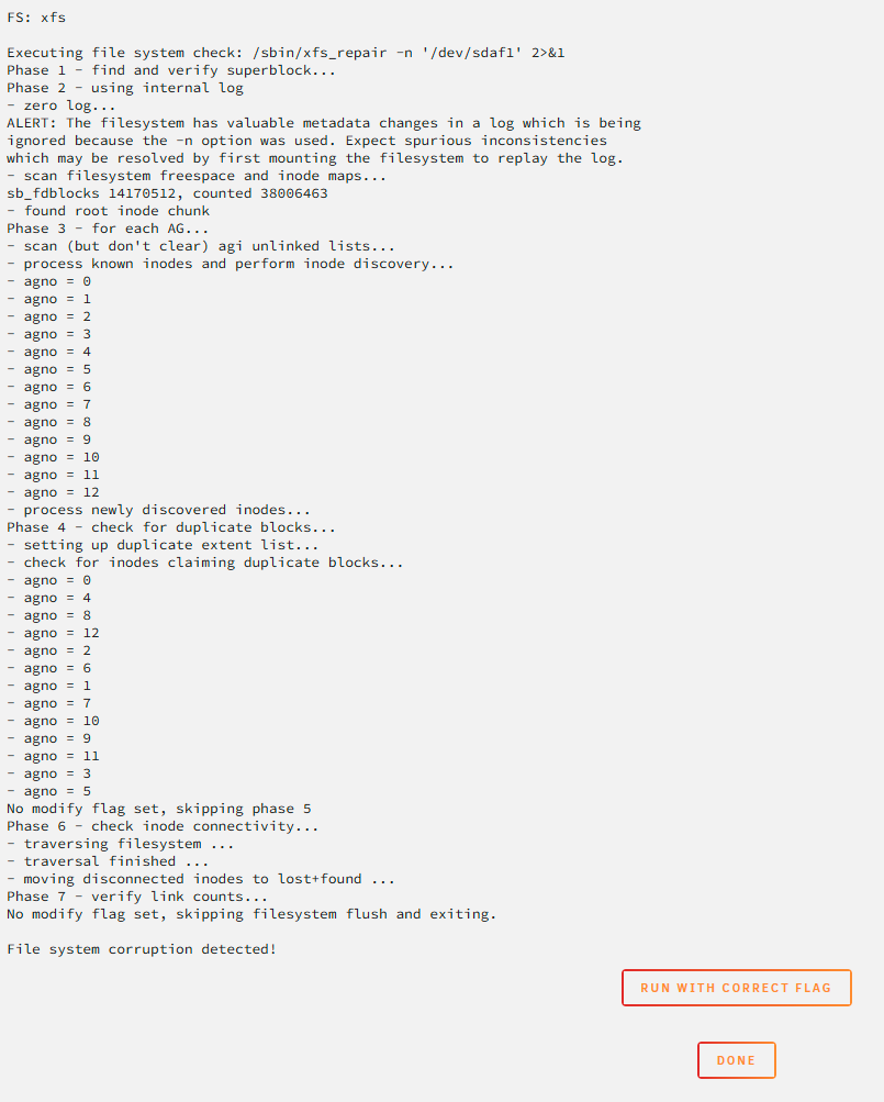

Today my luck ran out xD and Disk1 (1.5 year old Seagate 14TB with XFS) threw 2048 read errors and went offline (red X) about 30 mins into the rebuild. It is now showing up in the Unassigned devices area. I checked the file system and it shows corruption. Short SMART was perfect. Long SMART is not able to be run currently (greyed out). All attributes look normal.

Questions on #2. If I did want to attempt a XFS file system repair, and if that was successful, how do I get it back into the array? I was planning on a full shutdown, re-seating disk1, then attempting the repair via the "RUN WITH CORRECT FLAG" button. I've never ran this before, so have no idea what to expect. If it is successful, will the disk just pop back into the array like normal, or after a reboot?
