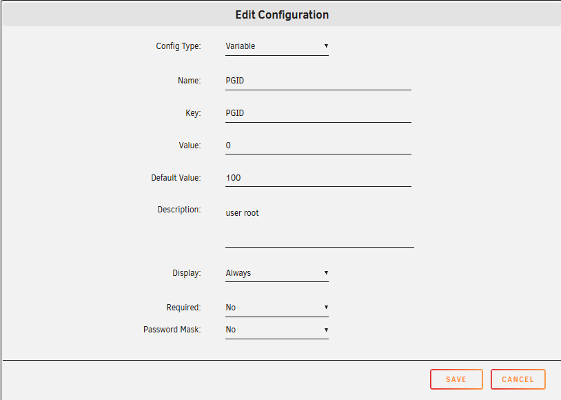

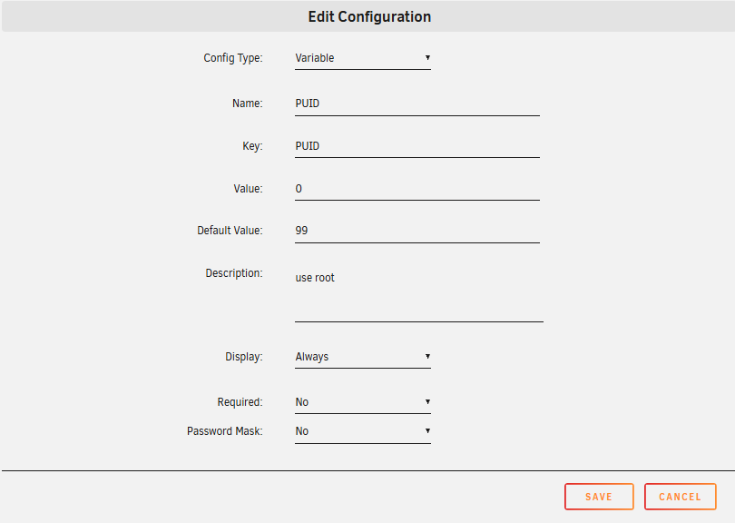

I also recommend running these with uuid and puid varibales set to 0 run as root
add at bottom example:

edit the docker and add thoese 2 variables
puid/pgid
