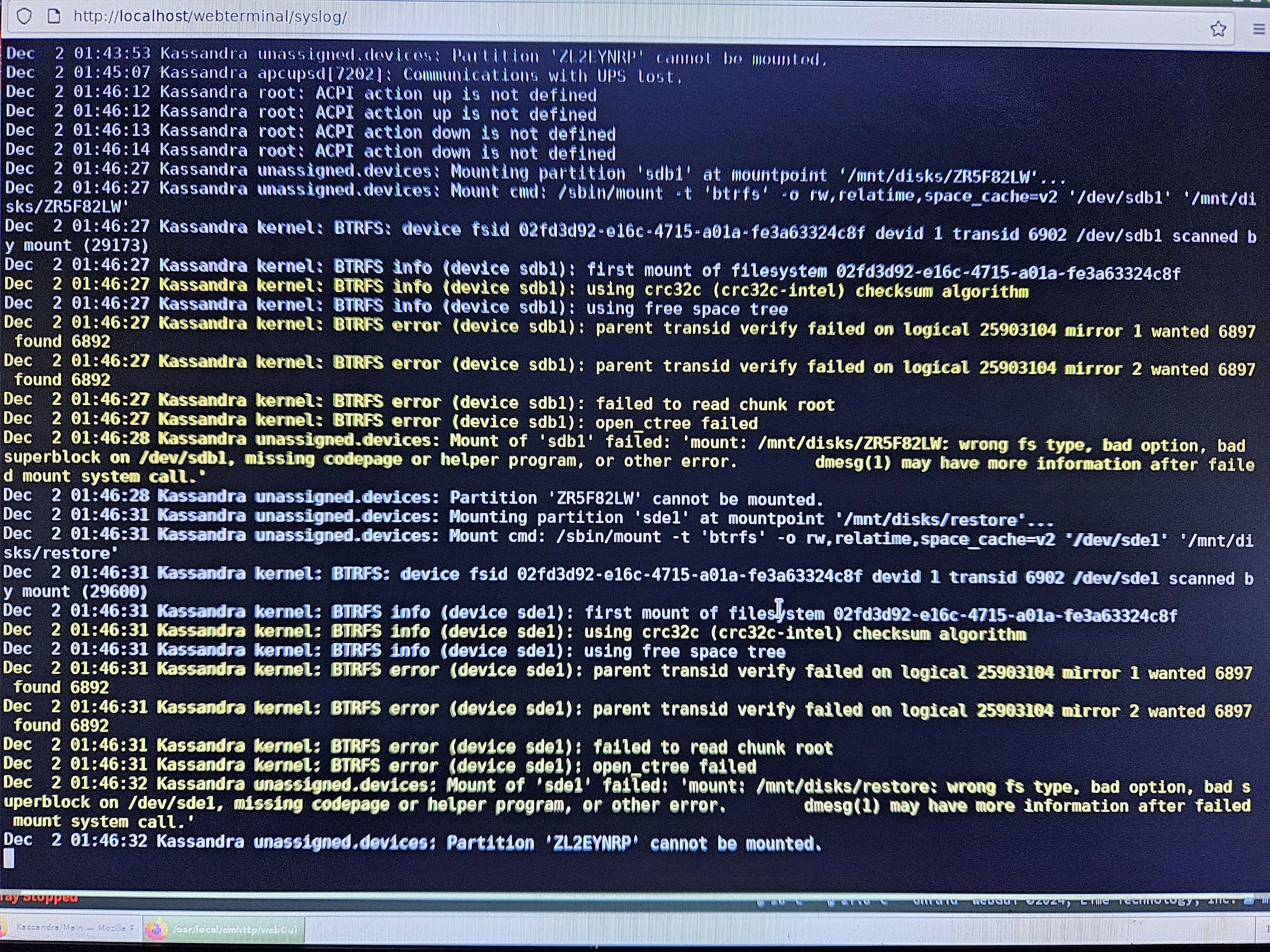

It all started when i was recieving very slow copy speeds on my array (around 200kbps) so i then rebooted the server only to find one of my drives had parents transid error, then i then attached another 16tb drive and followed the official data recovery guide and recovered all my data to new drive using btrfs rescue but now both the drives are unmountable with the exact same parent transid verify failed error (screenshot attached)

3 hours ago, JorgeB said:
parent transid verify failed on logical 25903104 mirror 1 wanted 6897 found 6892
This error is typically fatal with btrfs, it means some writes were lost and the device/controller lied about it, btrfs restore can sometimes recover the data, 2nd option here:
https://forums.unraid.net/topic/46802-faq-for-unraid-v6/page/2/#findComment-543490
my problem is that using the guide indeed restores my data to a new 16Tb drive, but then after a reboot, the drive to which the data was restored gives the similar error to the point where both drives say wanted “6897 found 6892”, like in the screenshot where both sdb1 and sde1 are giving the same error
That would mean that filesystem also has filesystem corruption issues, unrelated to btrfs the restore, but seems extremely unlikely that two filesystems would have issues with the exact same transid.
Also note that you can restore to a disk/pool using a different filesystem.

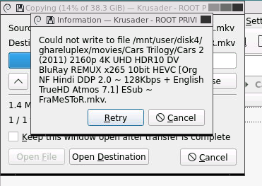

So I finally finally restored data from my failed HDD to Disk 4 in my array (using btrfs restore), but now im encountering another problem, out of all of 14.5 TB of data, everything was recovered almost, except around 140gb of data, and the reason being unraid doesnt let me write anymore files to disk 4, as soon as i start to write anything it slows down to mere 400kbps after 5gb, it just writes exactly 5.6GB (tried with different files) and then says space unavailble, tried in both Krusader and MC, i think brfs restore was also stopped due to this issue, Since i ran preclear on the disk and everything was ok,  but why isnt the disk letting me write anything even though there is 360gb free ?,
does this issue havev to do anything with the parity drive?, maybe the parity drive isnt letting me write data or something ?

Could be the share floor setting, which share are you writing to?
I was writing directly to the disk and the minimum share space setting is well below the free space
Edited by Vyktrii
Try using a different tool, I'm not familiar with Kruzader, and if it fails post new diags and the paths used.
I changed the HDD and now the data was fully recovered, but it seems that i have just shifted and delayed the problem as a unassigned drive is now experiencing the read fpdma errors, but atleast my array is working, but i think this issue could come back to my array disks, can a a faulty PSU be the reason for these errors ? Im currently using a silverstone ES230 PSU, which is an 80+ PSU but has fairly powerful 5V output (110w) for HDDs (im using 8 of them)
