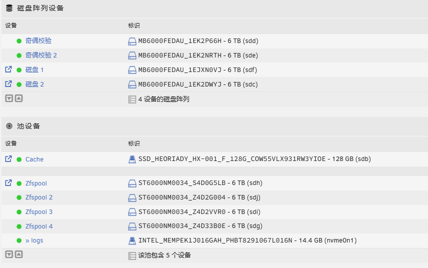

Hard Disk:
disk ATA SSD HEORIADY HX- 0A0 /dev/sdb 128GB
disk HP MB6000FEDAU HPD1 /dev/sdc 6.00TB
disk HP MB6000FEDAU HPD1 /dev/sdd 6.00TB
disk HP MB6000FEDAU HPD1 /dev/sde 6.00TB
disk HP MB6000FEDAU HPD1 /dev/sdf 6.00TB
disk SEAGATE ST6000NM0034 MS2D /dev/sdg 6.00TB
disk SEAGATE ST6000NM0034 MS2D /dev/sdh 6.00TB
disk SEAGATE ST6000NM0034 MS2D /dev/sdi 6.00TB
disk SEAGATE ST6000NM0034 MS2E /dev/sdj 6.00TB
disk INTEL MEMPEK1J016GAH__1 /dev/nvme0n1 14.4GB

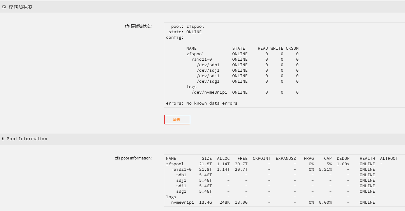

where the specific arrays are shown in the figure:
image.png.c1483fac8a2b6647273e89cc3b02ee87.pngimage.thumb.png.88fff693e23c2168487ffa95a9aacae4.png
The eight 6T mechanical disks are all connected via an LSI SAS2308 array, connected to the PCI-e3.0 x4 slot on the motherboard, which theoretically won't be any slower than a 10Gbps network speed, and won't cause a bottleneck in the hard drive transfers

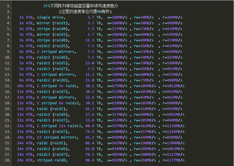

This is the speed of various arrays tested by others I found online:

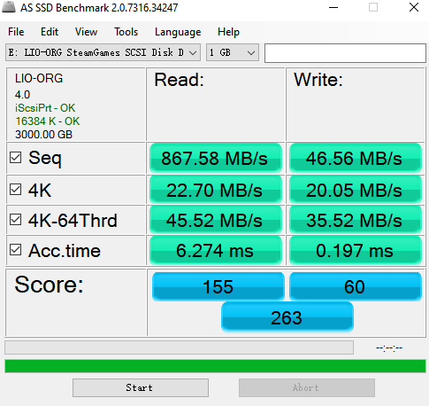

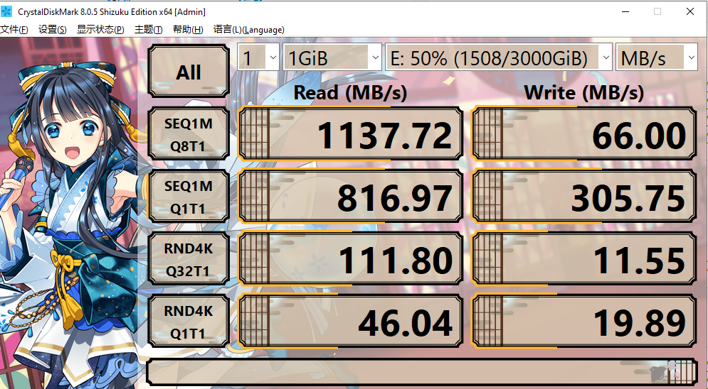

Below is the speed I tested by connecting to zfspool, via an ISCSI virtual disk:
Where Q1T1 performance is normal
It's really amazing, excuse my limited knowledge, I don't know how to explain and deal with such a situation

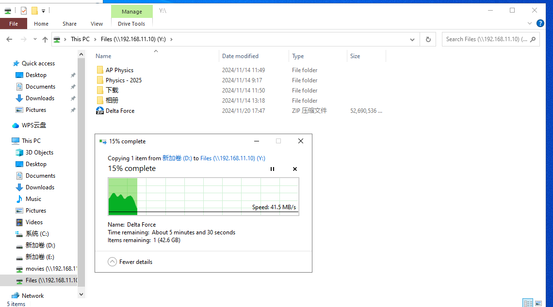

Repeat using SMB.
22 hours ago, JorgeB said:
Repeat using SMB.
When using the SMB protocol, it's pretty much the same after the out-of-cache
Speed starts fast and then decreases once the RAM cache is exhausted, suggesting a device issue, try creating a single pool device with one of the disks and retest with at least two different disks, in case there's an issue with one of them, even a single disk pool should be faster than that.
