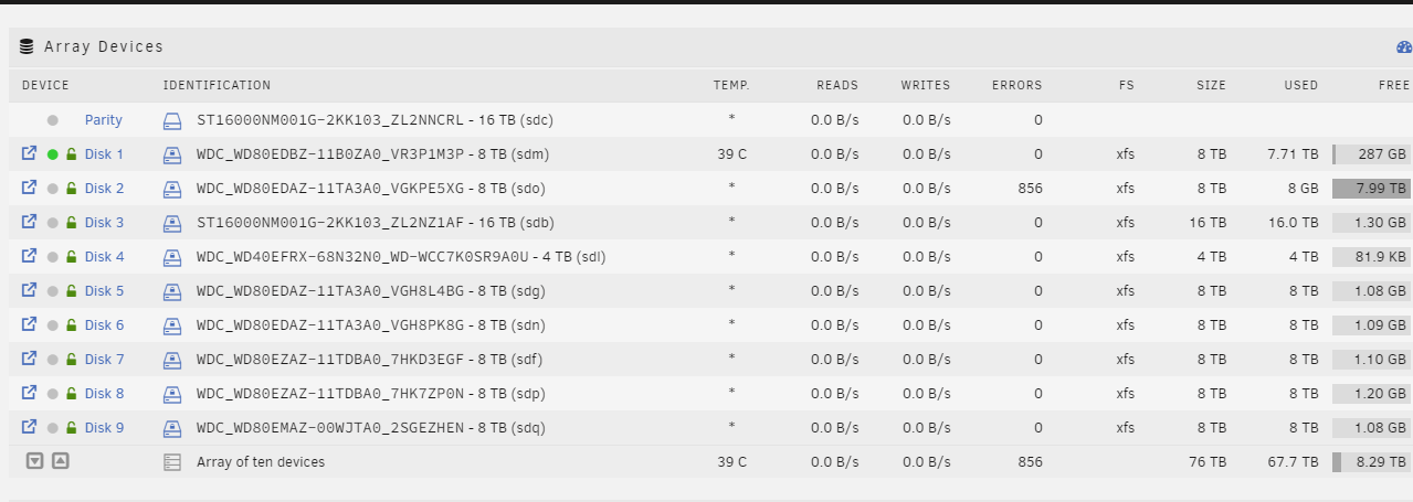

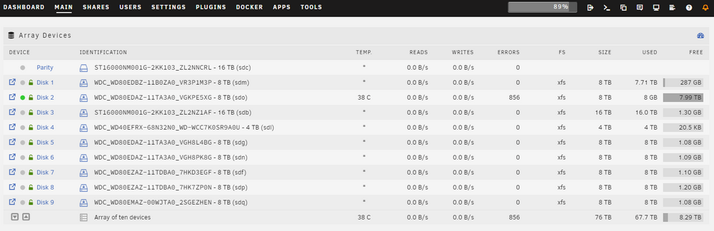

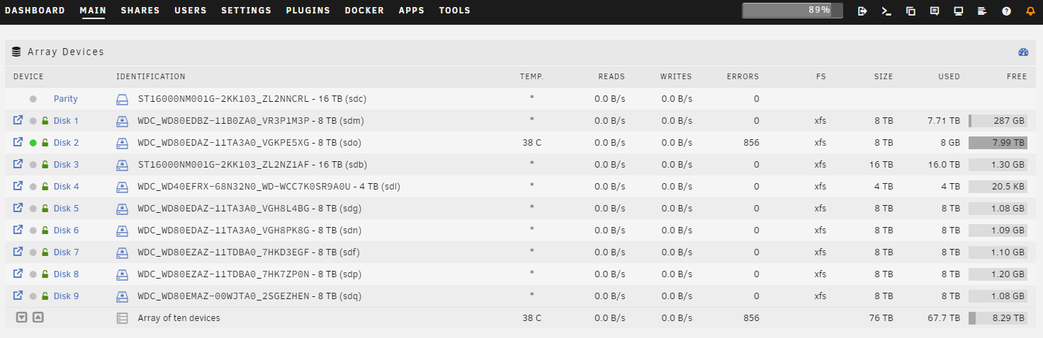

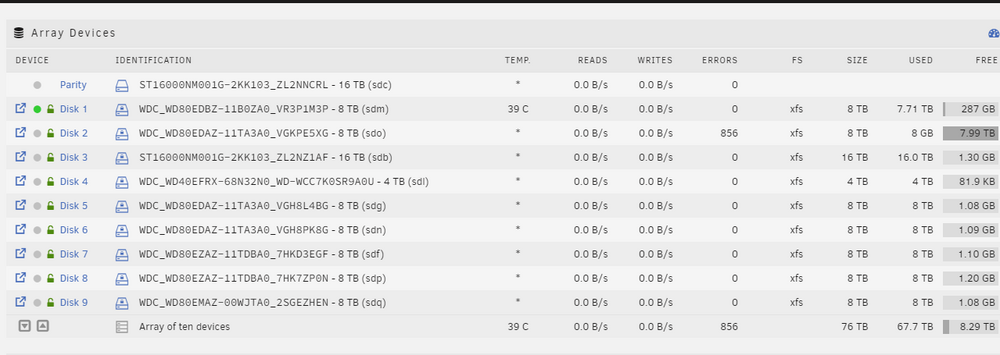

In the UI I see this, still:
If these errors won't rise, it should be fine, right?
If you restart the array they should go away (or maybe it needs a reboot, not sure).
