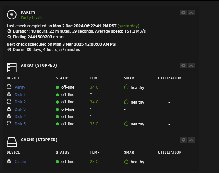

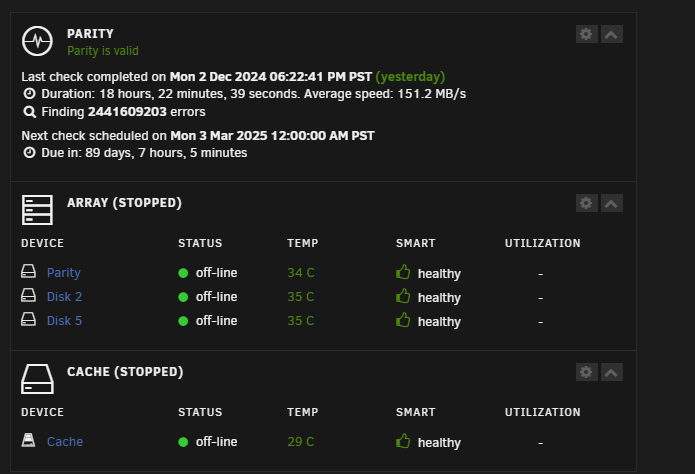

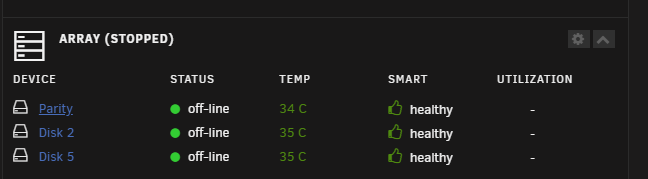

Array won't start. 2 out of 6 disks found.
Any suggestions on how to get it back running? I'll admit it's just been running for years without any hiccups until recently so I'm a bit out of the loop on how to debug. I attached the tools --> Diagnostics. I went on vacation and then came back and saw a couple disk failed errors with no shares showing so I rebooted and this is now what I see.
It's only see 2/6 disks for some reason.

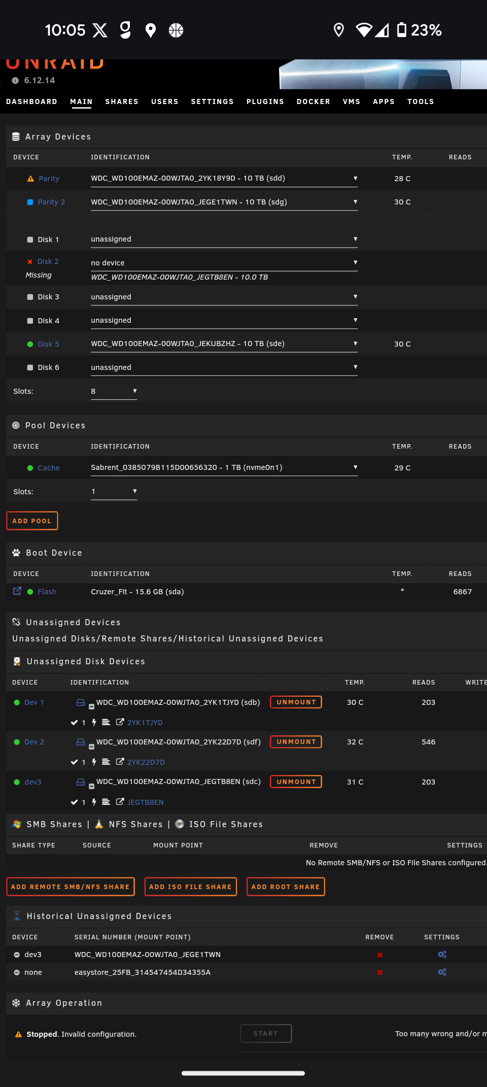

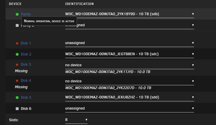

Strange... 2 hours later I see this now. Although I did upgrade the OS to the newest stable version.
Here's some screen caps.

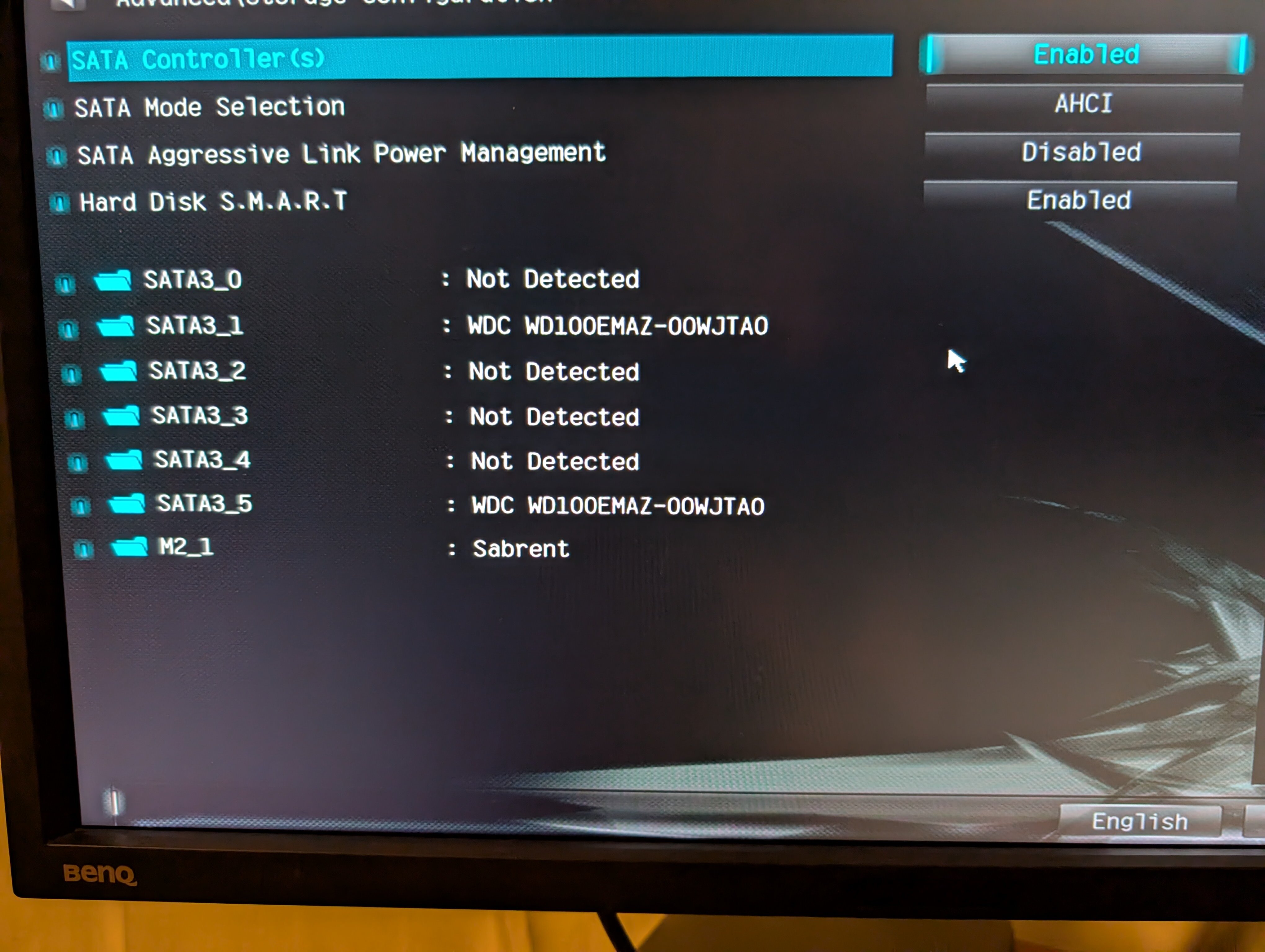

Check all connectiosn, and see if the missing disks are detected in the board BIOS

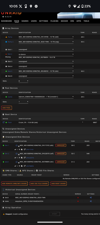

After blowing out the enclosure/dust, and moving it back to my basement it seems to see all but 1 disk?

Disk1 was also being detected, it was just disabled.

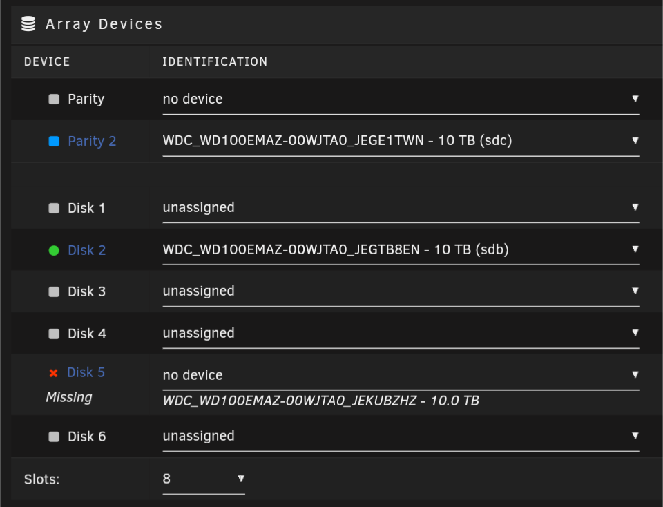

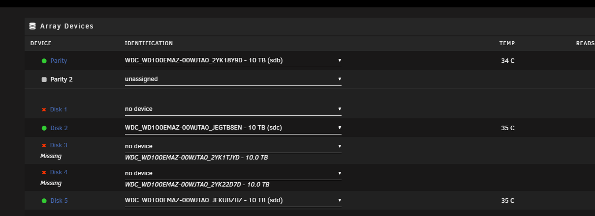

After replacing the disabled disk sata cable I'm back to this and array won't start.
There are multiple missing disks again, check power also.

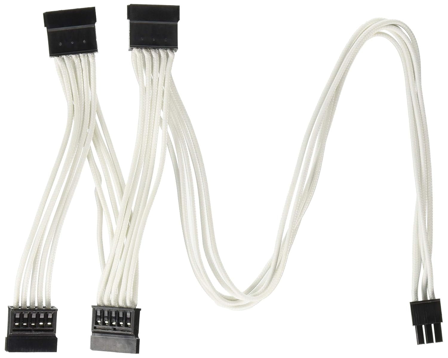

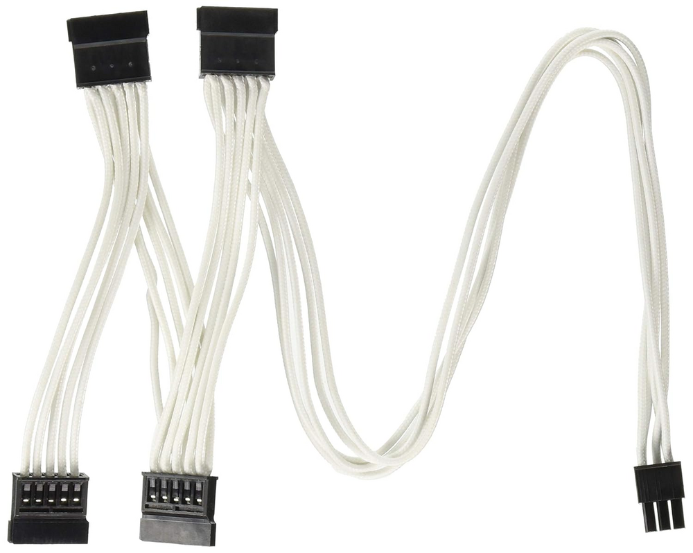

Will use 2x of these from PSU to SATA power. https://www.amazon.com/dp/B01N6G22IU?ref=ppx_yo2ov_dt_b_fed_asin_title
Then Just 6 individual sata cables as I have 6 ports on my motherboard. Currently I have a single PSU sata port being used that is spliced into a molex connector which goes from molex to 2 sata, form the 2 sata to the 6 drives...

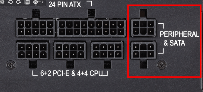

Make sure that cable is the correct one for that PSU, they are not all compatible, even with PSUs from the same brand.
I assume so but will ask.
I replaced all power and data cables with new ones and no luck. Still won't detect the HDD's. So have to figure out the non-Unraid  issues now :'(
"These cables are specifically designed to work with our power supplies using the Type 4 pinout including our SF Series™ power supplies."

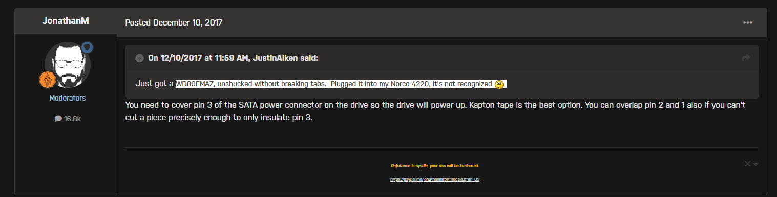

You know what.. I think this is the issue... I just had totally forgotten about this as these are 10TB shucked drives and have a 3.3V issue.
"You can also use a Molex to SATA power plug.  These will contain no 3.3V only 12V and 5V connections.  "

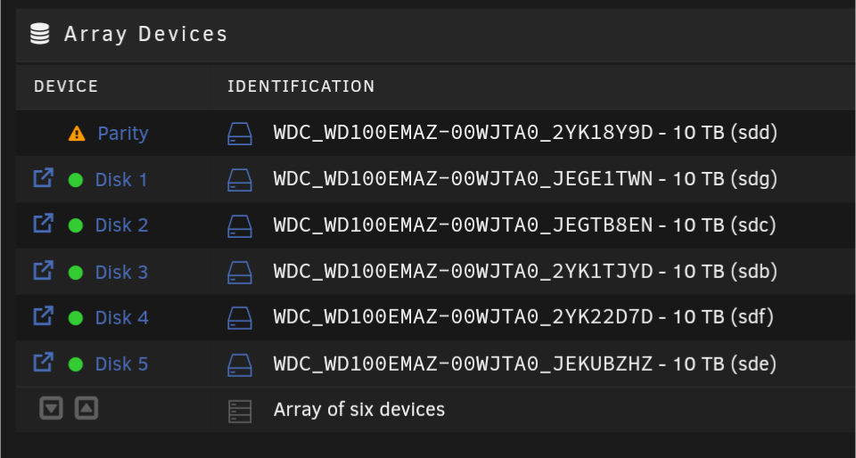

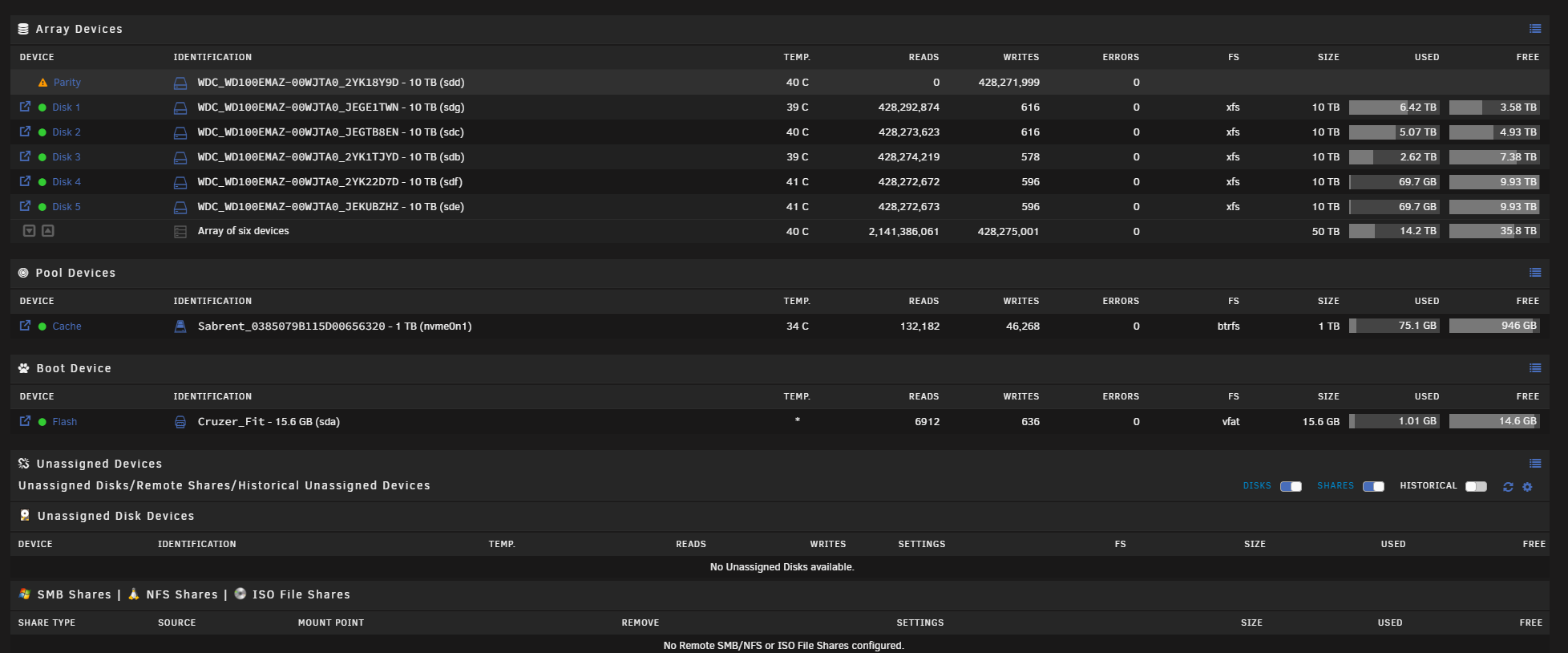

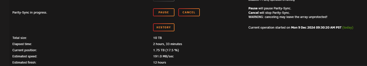

I think I got it worked out. I looked at the drive names / position they were previously and it's rebuilding the Parity now. Not 100% sure if I fucked up my data but I don't think so. I re-added the drive names to the same Disk as before.
