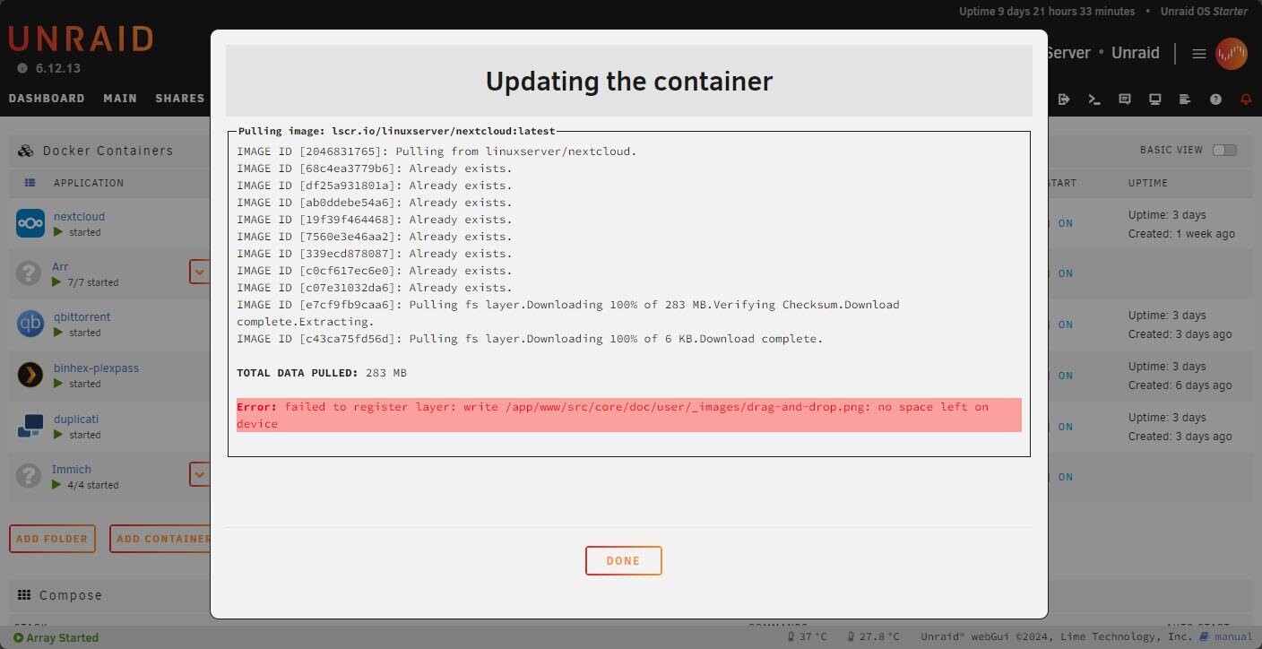

I need some assistance understanding the error in the attached picture that I experience when attempting to update my Nextcloud Linuxserver container.
The error is "failed to register layer, no space left on device."

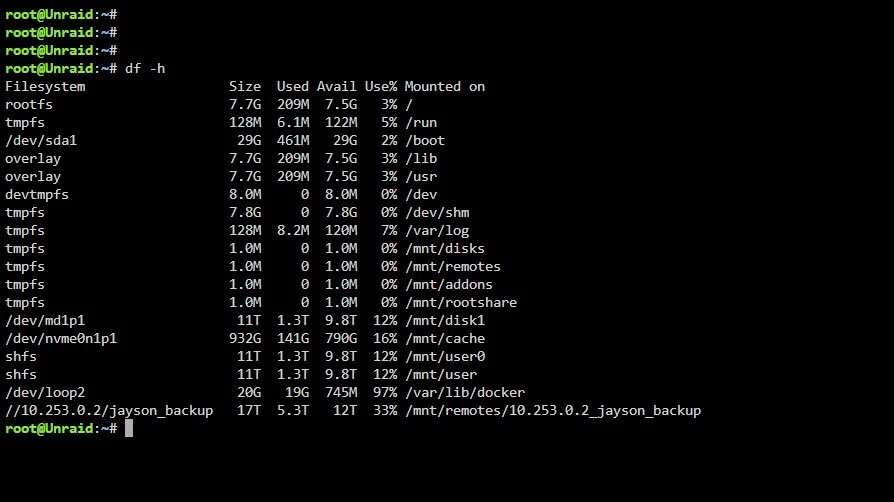

Attached is the output of df -h on my Unraid server. I note the /dev/loop2 filesystem being near to full but I'm not sure what this is nor how it would relate to this docker container.
That's the problem, you can increase the size of the image, but make sure it's not growing by itself, or there could be some wrong mappings.
Thanks, how can I increase the image size?
You can do it under Settings->Docker if the docker service is set to disabled.
