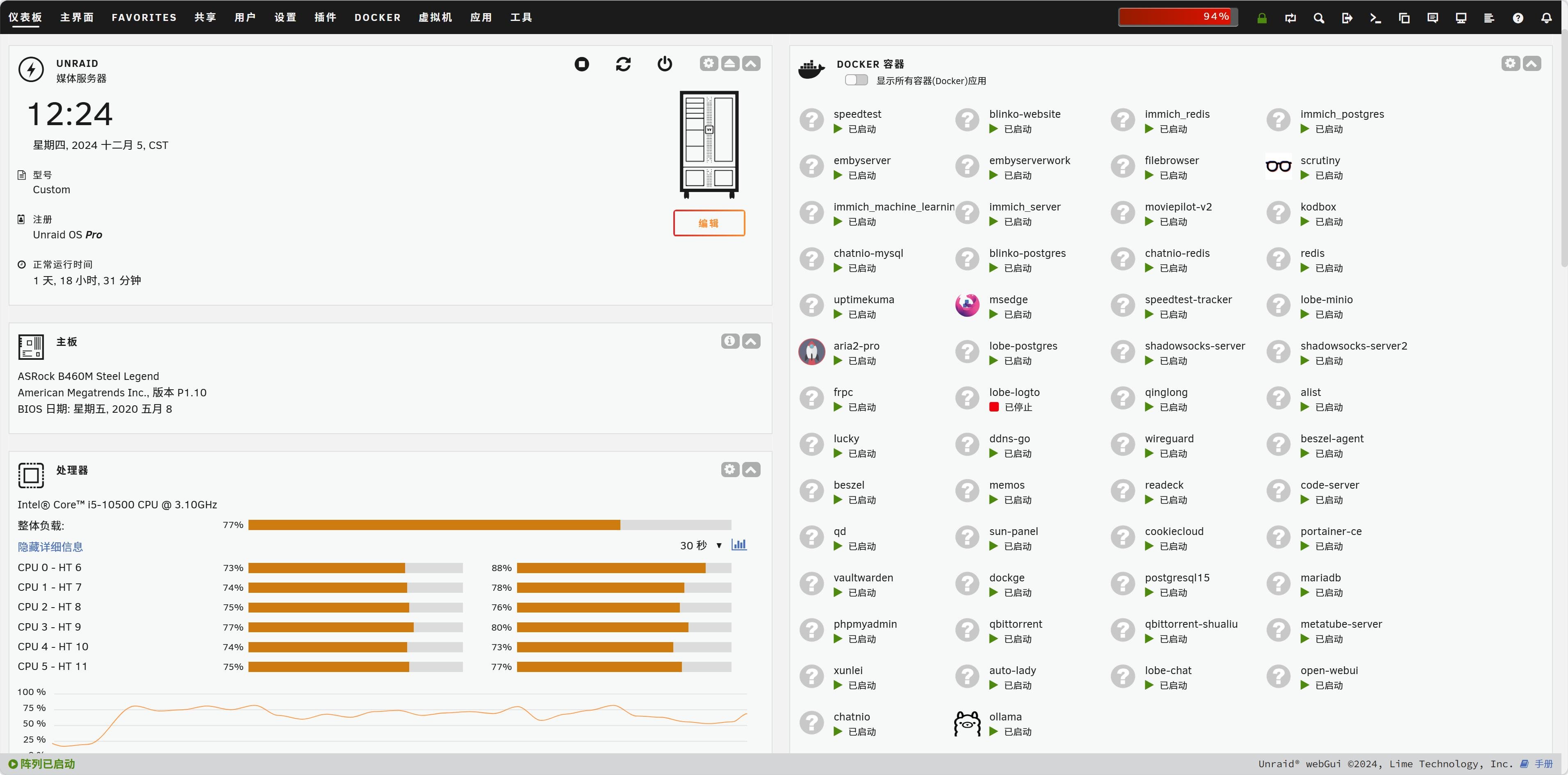

Hi everyone,
I recently upgraded my Unraid system from version 6.0 to 7.0 beta, and I've noticed an issue with unusually high CPU usage. On version 6.0, the CPU usage was consistently around 10%, but after the upgrade, it has increased to 50-60%. Additionally, the system's responsiveness has significantly slowed down—for example, it takes 20-30 seconds to refresh the Docker containers page.
Interestingly, when I stop the Docker service from the system settings, the CPU usage returns to normal, and the system operates smoothly. I’ve checked the logs but didn’t find any errors or issues recorded.
Could anyone provide guidance on how I should approach diagnosing and resolving this issue? Any help or similar experiences would be greatly appreciated!
