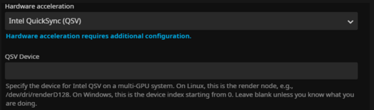

QSV Device is blank. I know it says to leave it blank but I think you need to fill it in with /dev/dri/renderD128

4 minutes ago, MowMdown said:
/dev/dri/renderD218
218? I put in renderD128 but it didn't work. Is there anything else wrong? I don't think the codecs should be wrong right?
You need the entire path with it. "/dev/dri/renderD128" (no quotes) just like it says in the subtext.
edit: dyslexic numbers
Edited by MowMdown
@MowMdown I meant that I put in 128 instead of 218, so /dev/dri/renderD128
Sorry, that's my fault, the numbers are supposed to be 128 not 218.
