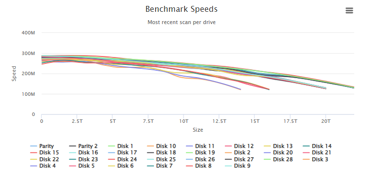

I've been reading through quite a few topics and have tried quite a few things, but i'm not able to get over ~105MBps during a parity check or mover operation and wanted to see if there is anything I'm overlooking or if this is just a unraid limitation with my setup. I've seen that a lot of the tunables do pretty little on latest versions though I have tried playing with a few but have them back to defaults now. I'm running 7.0 rc1 but this has been the same for quite a while (at least through the 6.12.x releases). mover tops out around the same speed when on reconstruct write. drops a bit to around 80MBps when on read/modify/write. I do believe my old netapp disk shelf was a bottleneck so i replaced some hardware but haven't seen an increase in speed which led me to doing all the disk speed testing below.

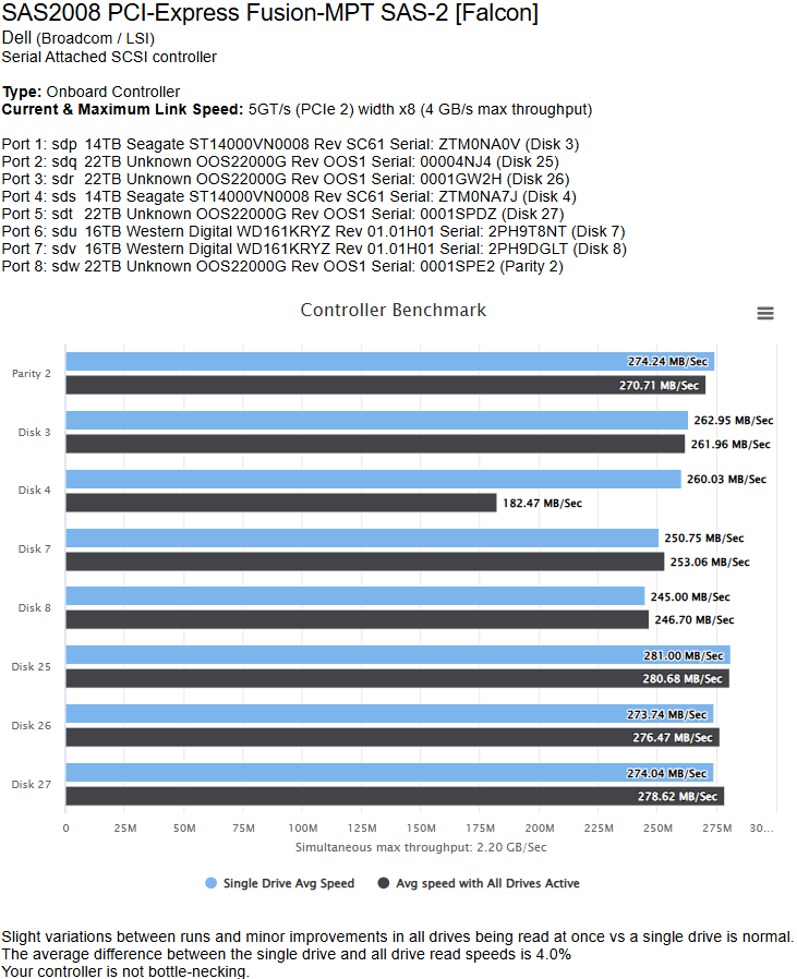

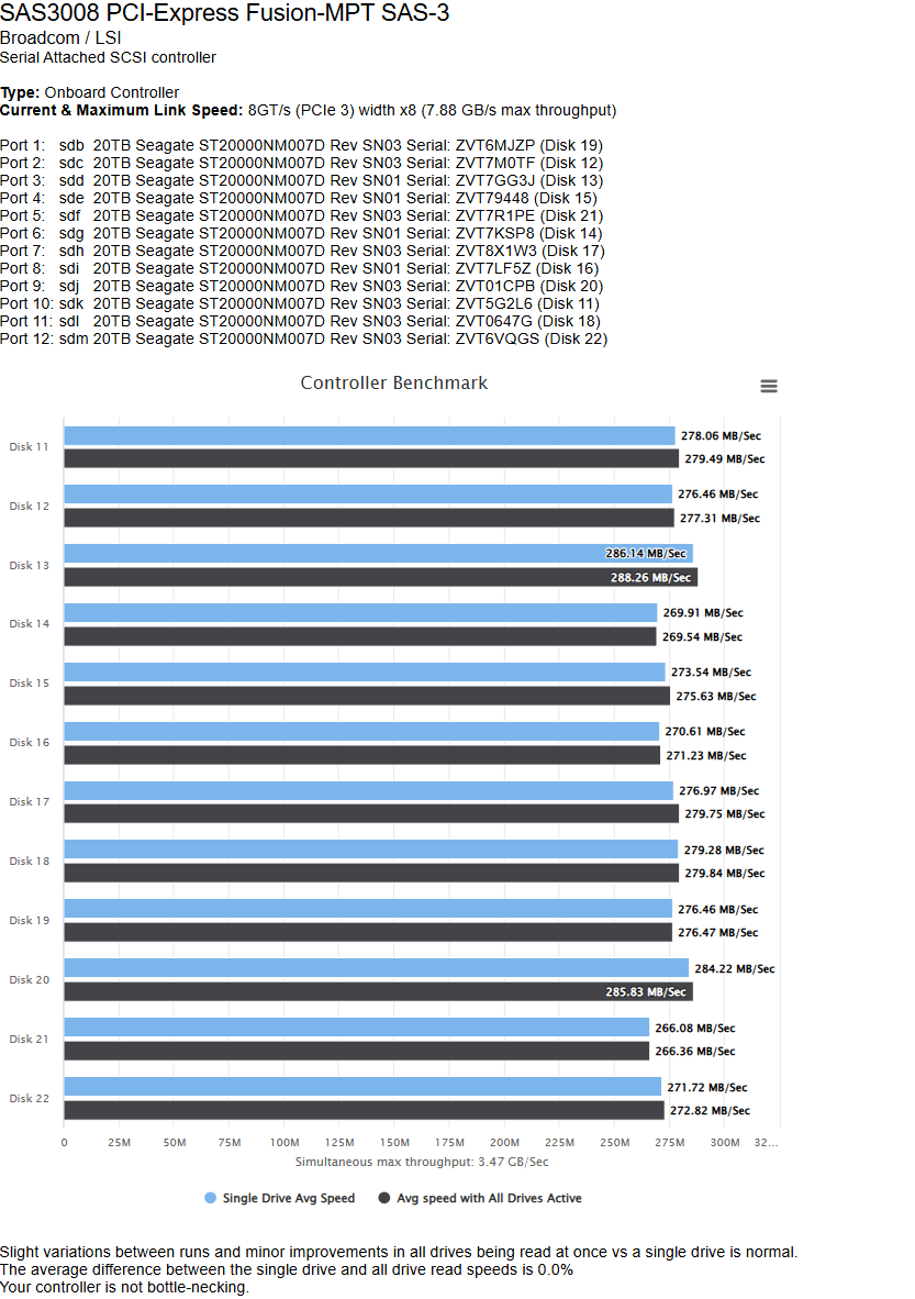

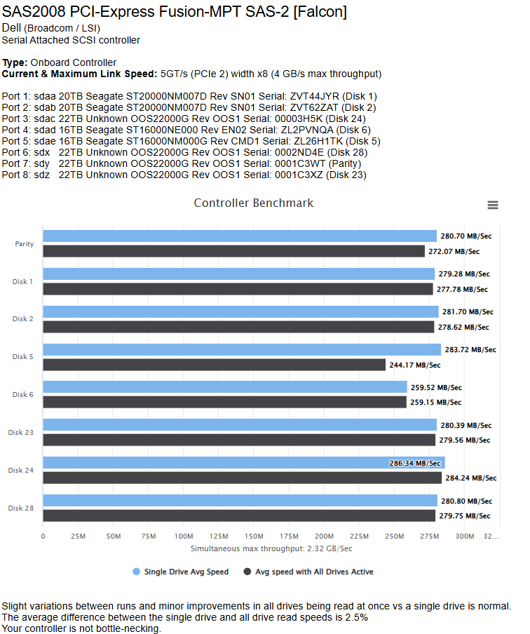

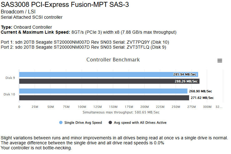

My slowest drive has tested around 245-250MBps and the controller benchmark shows full drive speed (up to lowest drive speed) for all 4 of my hbas. The link speeds to the controllers all look correct, and I don't think it should be a pcie lane issue. Array has 30 drives (xfs) and I have 3 cache pools (all zfs) with a total of 8 nvme drives spread across those pools.

HBA's: 2x LSI 9300-8e connected to supermicro sas 3 backplanes. 2x LSI 9211-8i with breakout cables to those drives.

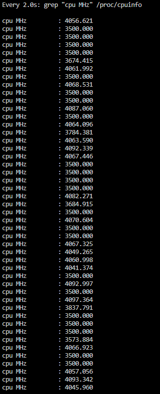

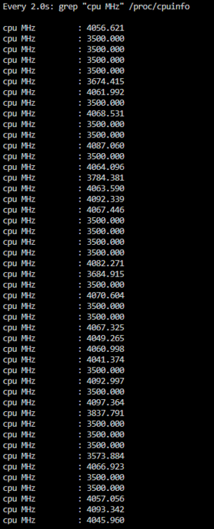

Is the CPU in performance mode? Al check that it's boosting and not running at base speeds.

CPU frequency is going over base clock of 3.5, boost is supposed to be 4.2 and I'm seeing cores over 4.1 so i'm assuming this is working as expected. also checked that it's set to performance mode in the tips and tweaks plugin.
Did a little more digging and this CPU doesn't support any overclocking so I believe It's running normally and is as much as I can push it without upgrading to a unlocked/newer cpu but i'm guessing that won't get me a ton more speed.
