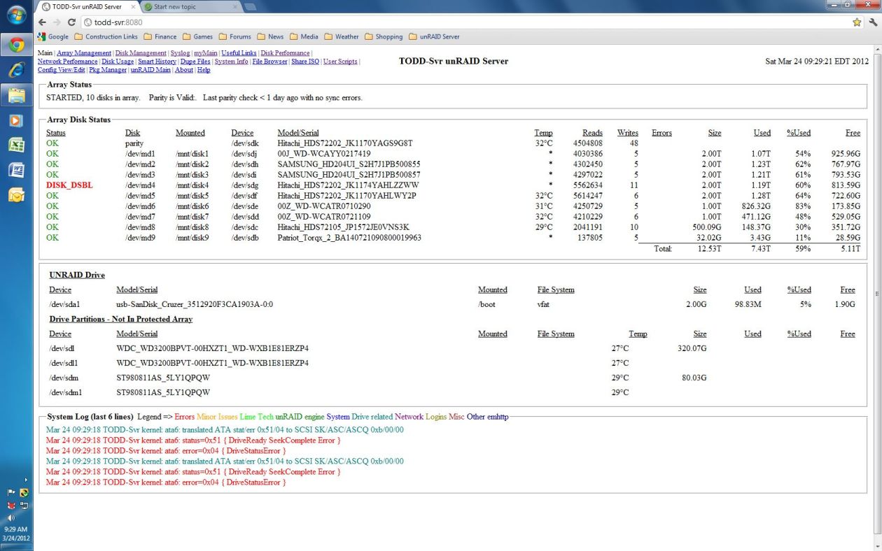

When I got up this morning, I have this screen (see attached screenshot).

1. It says parity check complete with no errors, but I figured this occurred during the parity check, so a little confused there.
2. It is showing some writes to the failed disk and the parity disk (see screenshot).  The writes to disk 8 are probably due to me opening a file off that disk this morning.  Is there any chance the parity was corrupted having a drive fail during a parity check and still show up as valid?
3. I have a spare drive already precleared here.  Is there any reason not to just go replace the drive?  Anything else I should check first?

The SMART report looks ok except for a single pending sector. Rebuild the drive: Start the array with the drive unassigned. The assign the drive and restart the array. The drive will rebuild.
Rebuild the same drive or replace it and rebuild?  Is there any way to "test" and make sure it is reliable?
I could install the new drive in place of this  drive, rebuild.  Then preclear this one again?  Or based on what you see is this not necessary?
The safest course is to rebuild with a pre-cleared replacement then the pre-clear the problem drive to test it's reliability.
