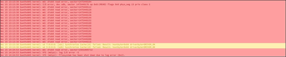

Did you check my Syslog and diagnostics files? Before the last shutdown I had following entries:
