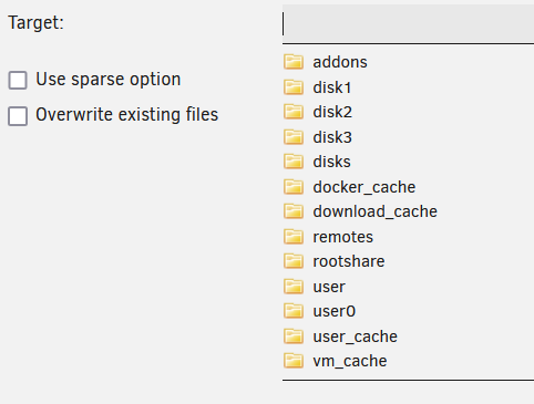

What did I do wrong? I mounted my existing SMB shares in Unraid and I used the Dynamix File Manager to queue up jobs copying folders in the existing shares to the newly created shares. For the destination of the copy all shares and disks are listed, and my user share names were found under both "user" and "user0". I copied them to the share names listed under "User".
What could be the problem? I'm attaching a screenshot of the resulting error on Windows. And one of the target selection for the initial copy.

Whew. I solved this one. When setting up the individual shares I'd set "case-sensitive names" to "force" under SMB Security Settings. I vaguely remember thinking that would help avoid problems. I didn't know what I was doing. Reading the help actually sounds like it's a good thing for new shares. Changing it to "auto" immediately gives me the expected access to all the files in all of my shares.
