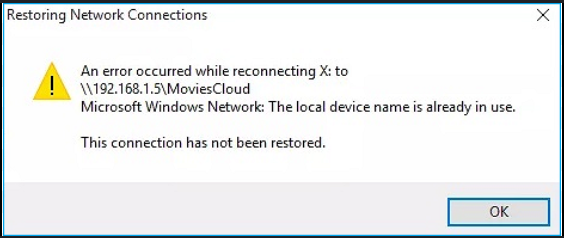

3. The normal error I get once this happens is (Error 1 photo attached) Microsoft Windows Network: The local device name is already in use."

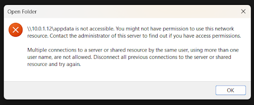

4. The other error I sometimes get is (Error 2 photo attached) Multiple connections to a server or shared resource by the same user, using more than one user name, are not allowed."

I'll give this a shot and report back, thank you for your reply!
This seems to have fixed the issue, although a silly workaround. Now I have an additional profile on all of my Windows devices just to access shares on Unraid.
This the result of a security update to Windows SMB from Microsoft.  It is how Microsoft wants Windows to be configured.  They do not want to allow Windows client computers to be able to willy-nilly log onto rogue servers on public WIFI access points.   It is not a workaround!
