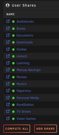

When I look into my Shares tab:
Appdata is not shown.

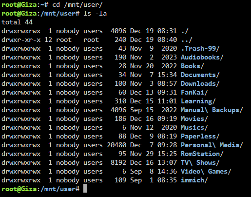

When I use CLI:
No sign of it either. Nor in /mnt/cache.

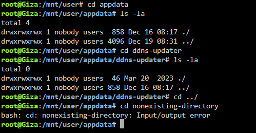

But, here's the trick... I can cd into it. Once into it, I cannot ls either, but I can cd into existing directories. If the directory does not exist, I get an error.
But once I'm in one of them, I cannot cat any file, as I get an Input/output error.
On the other hand, if I use the CLI of my containers, I can access the files without any problem (although they are directly linked from appdata).
