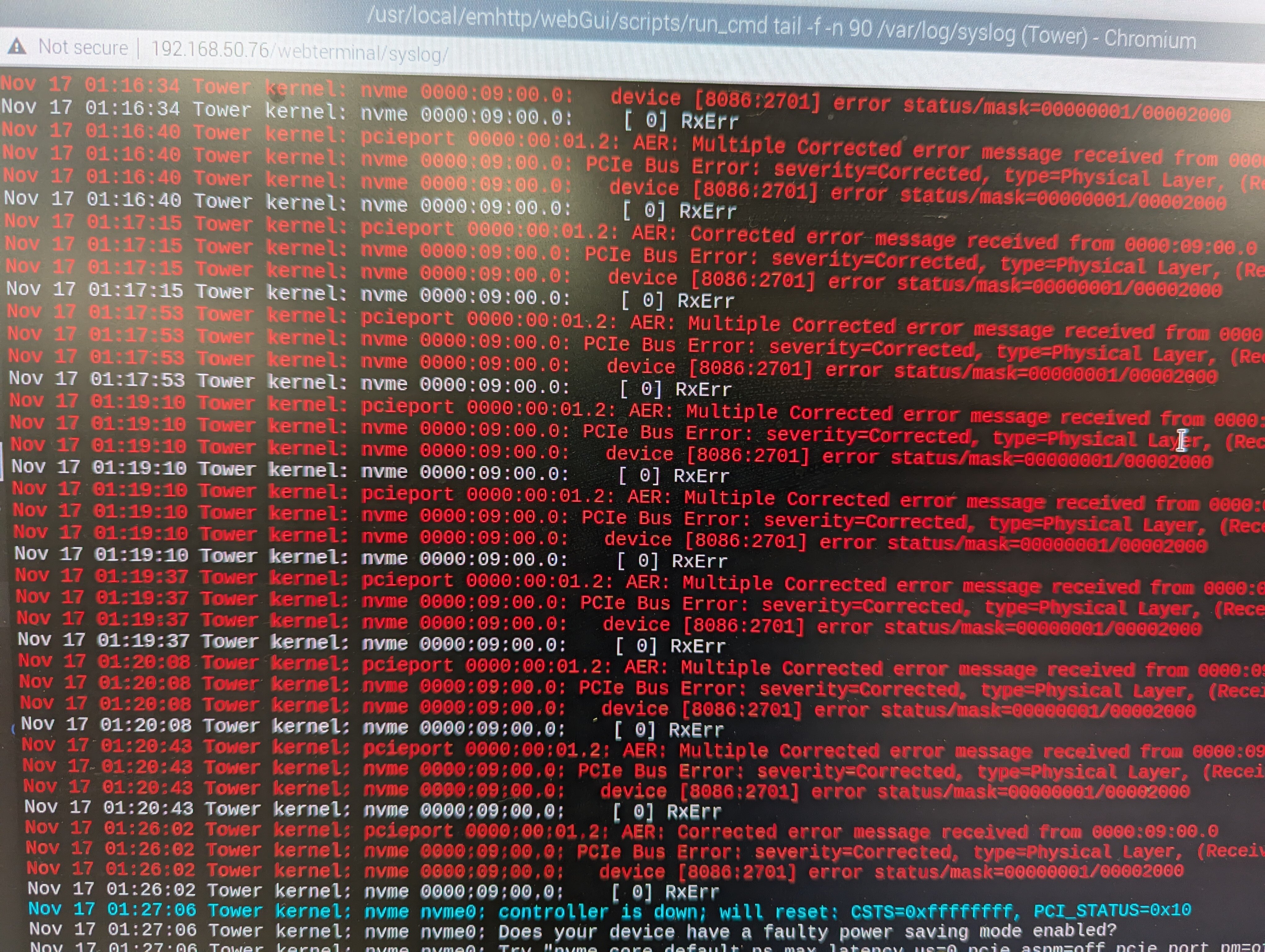

Back on November 17th, when I had some time off, I relocated the server in a new room. When I went to restart the server in its new location, I got multiple errors during boot-up that were stating something was wrong with the nvme / PCI-express devices. I snapped some pics with my phone and have attached one of the images to this post.  Among the error messages, there was the text "AER: Multiple Corrected error message received from 0000:09:00.0" and "PCIe Bus Error: severity=Corrected, type=Physical Layer, (Receiver ID)".
After many lines scrolled by with those messages, the server managed to start. I logged in to the WebUI and saw that one of the NVMe drives in my cache pool [2 NVMe drives total] was not seen by Unraid. Of course, nothing would launch. No Docker and no VMs.
I reboot the server twice and the same errors were seen during startup but strangely enough, Unraid saw both NVMe drives again.

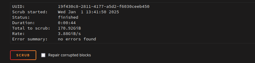

Run a correcting scrub on the pool and post the results.
@JorgeB Attached you should see a screen snippet after I ran the BTRFS scrub on the cache pool. It reports no errors found! This is very frustrating because at some level, Unraid recognized there are errors but now the test does not find any errors 😞
Any advice is greatly appreciated!

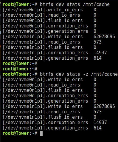

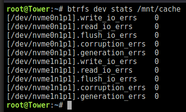

Appreciate all the guidance thus far. Today I followed the steps as outlined in the post you linked to and managed to clear the BTRFS stats. See attached screenshots. Listed the stats, cleared the stats, the same values were reported, reboot the server, listed the stats again, and finally the stats were cleared. Unfortunately, Docker engine still failed to start. I have attached diagnostics again [with array started!]... Going to look at the logs now to see if I can find anything obvious.

I guess whatever happened with the cache pool corrupted the docker image file...?? Based on what you said in the other thread [which is from 2018!], I take it that Limetech has still not adopted checking the BTRFS dev stats into Unraid natively? So the best practice is to set up that script which is outlined there?
Thanks again for all the help!
Yep
