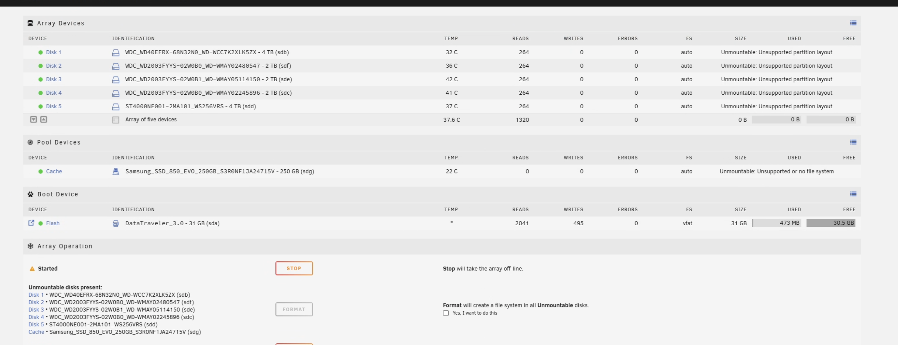

  • Disk 1: WDC_WD40EFRX-68N32N0_WD-WCC7K2XLK5ZX - 4 TB
  • Disk 2: WDC_WD2003FYYS-02W0B0_WD-WMAY02480547 - 2 TB
  • Disk 3: WDC_WD2003FYYS-02W0B1_WD-WMAY05114150 - 2 TB
  • Disk 4: WDC_WD2003FYYS-02W0B0_WD-WMAY02245896 - 2 TB
  • Disk 5: ST4000NE001-2MA101_WS25GVRS - 4 TB
I've attached a screenshot of my current array status. Can anyone help me determine which 4TB drive was my parity and which 2TB drive was the one that failed? I don't have any pictures of my previous array configuration to reference.
