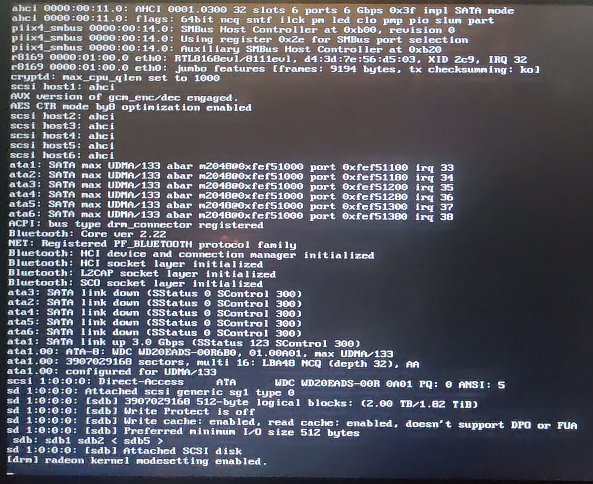

That's where I am now. The booting progress no longer gets stuck, and it definitely does way more steps than it did before, but eventually it seems to immediately crash somewhere and immediately reboots itself. I attached a picture of its final steps right before it shuts down and reboots.

Does it ever completely boot into Unraid?
No it doesn't, I haven't even been able to attach a license to the USB.

Any other suggestions before I buy a new motherboard+CPU+RAM in hopes that'd work?
Are you able to load up Windows on that hardware and start up?  If it can at least load up, you may find a clue as to which HW to look closer at rather than replacing it all.
I've tried to install Windows 10 but it hangs at the startup logo. I wouldn't be surprised if W10 simply isn't compatible. I actually needed to run an exe file to update the BIOS and had to resort to FreeDOS which worked perfectly. I don't have a copy of W8 around, and I'm a bit wary about downloading the ISO from anywhere outside Microsoft's website, so I haven't tried that. However, I could run Linux perfectly and have shared everything related to hardware above. I'm happy to run any additional troubleshooting apps on Linux (or DOS, but I assume the options are limited there haha) if you have any suggestions on that.
I actually found this forum post earlier today that has the same motherboard and appears to experience the exact same issue since 6.10. They never followed up so not sure if this is coincidence or not, but it does make me suspect there may be compatibility issues with this motherboard in particular. I may be wrong of course, I've never used Unraid before let alone I know about its exact hardware requirements (beyond what's in the docs)!
I did end up ordering a new motherboard (with Intel N100) though. The pc's PSU should still be working and I still have some RAMs that I can reuse, so if that setup works at least I didn't have to spend that much.
