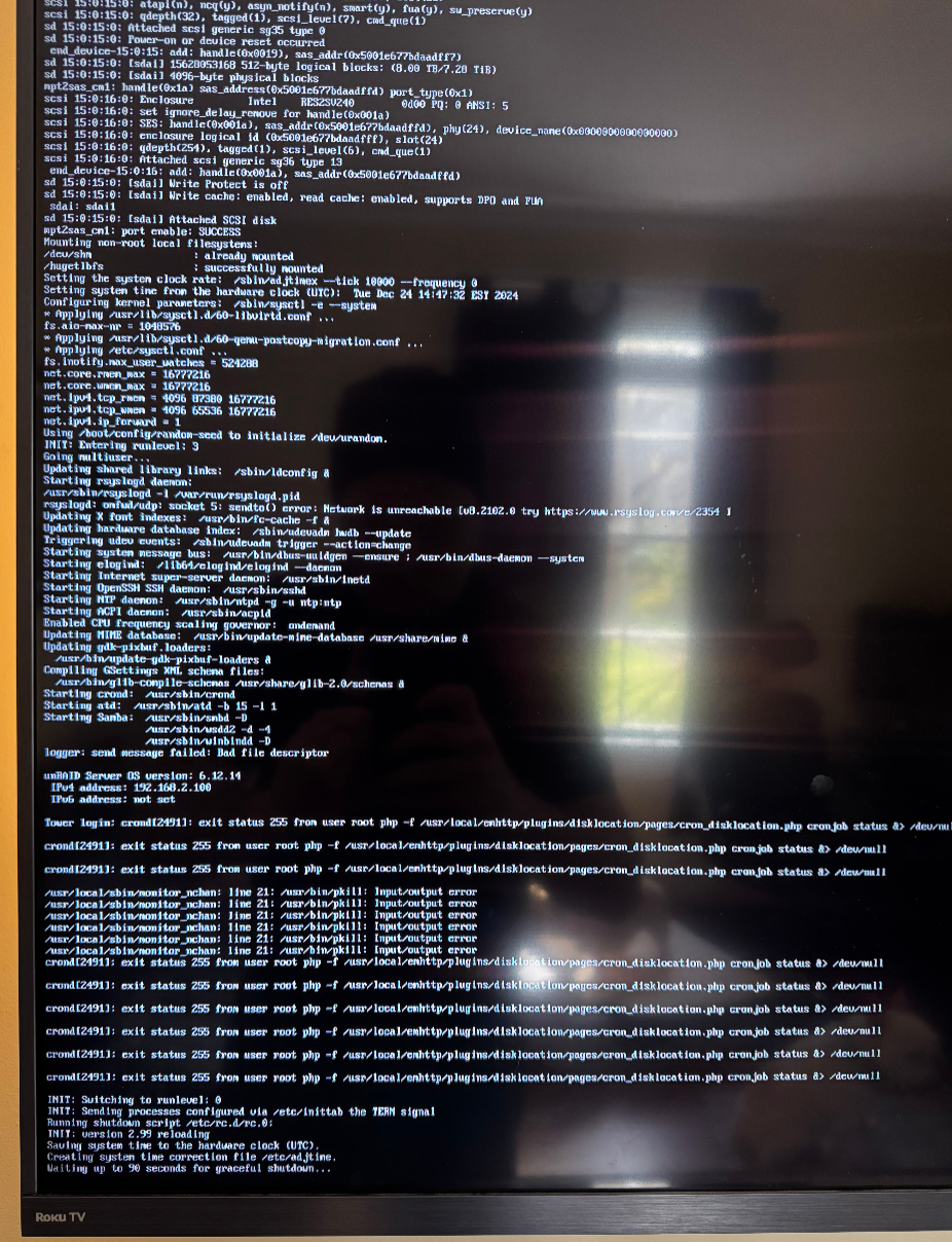

Lately I've been having stability issues with unraid after upgrading to 6.12.14. Its sporadic and seems to occur every few days. Basically the entire server becomes unresponsive. VMs and dockers are killed, web access no longer works, and SSH also doesn't work.

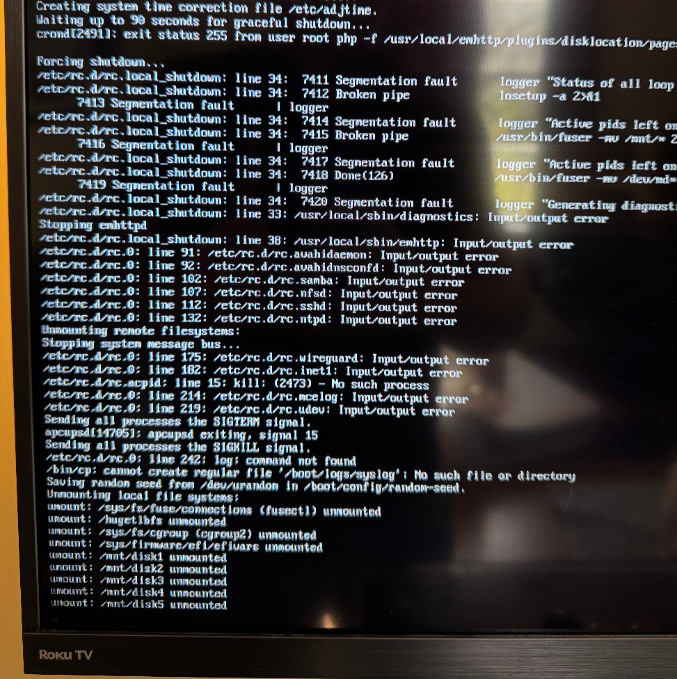

However, If I hit the power button on my server, I can see in the console with a connected monitor that the server does shut down after the scripts execute. The screenshot shows the console and the shutdown process. I see some errors but I do not know what they mean. Also, it never gracefully shuts down. After 90 seconds it goes into forced shutdown.
I couldn't find anything in the logs that aligns with the timing of the issue. The most recent occurrence was around 8:00 PM ET 12/29. The photos are from a few days ago, but the behavior seems to be the same every time. Diagnostics attached.
The only thing I can think of is a failing USB drive since its very old and I ran into another issue a few weeks ago where it said there was no USB device connected but the server was still running from RAM. I haven't been able to reproduce that issue, but I havent tried transferring my license to a new device yet.

Darn. Well, perhaps an enhancement request would be to save diagnostics on the "forced shutdown" scenario like my photos above. Don't know why its only saved on clean shutdown. Perhaps there are clues in other logs outside of syslog.

Quick update... I tried replacing my key to a new flash drive, and in the process of the key validation using the web replacement method it failed and threw an error saying there was an issue communicating with the flash device. I manually replaced the key and it booted fine... but then after a few minutes the flash was completely dropped again. I tried one more time in safe mode, and the same thing happened. I tried switching USB ports and so far so good... Maybe I have a USB port that has gone bad. I'll monitor to see if that fixed the issue.
