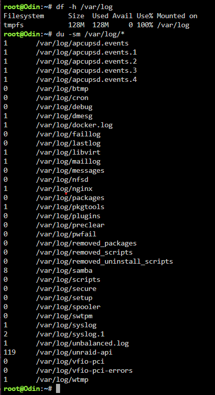

I am repeatedly having an issue where my Unraid log is filling up. My current system uptime is only 2 months and change.
It looks to me like the unraid-api might be what is filling it up:
Logs attached.  Any help pointing me in the right direction is much appreciated!

Uninstall the Connect plugin and reboot to see if it helps with the log issue.
Thanks @JorgeB.  I just uninstalled Connect and rebooted and will see how things go.  I'll report back.
Thanks again @JorgeB.  So far this is looking like it may have solved the problem.  Logs have been holding at around 5% of max size now for the past week.   I have not yet reinstalled the Connect plugin.  I'll watch the logs for a bit longer to make sure the issue is resolved.  If it's still all clear I'll then try reinstalling Connect and see if it comes back.   I'll report back again after.
